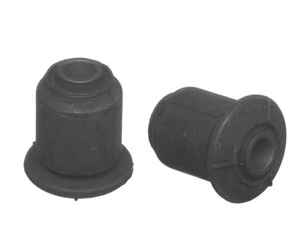

Trailing Arm Bushing Replacement
by Nathan Goodlet
Subject: [W126 Coupe] Replacing trailing arm bushings
Date: Friday, July 5, 2002 4:37 PM
Reply-To: mbcoupes@mbcoupes.com

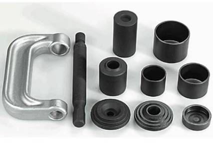

OK Trailing arm bushing job is rain delayed!! Time to start the write-up.
Attached find pix of the bushings and the tool I rented.
The usual disclaimer applies that working under a car will crush you, be sure you have enough tools, experience and sense to do this kind of work safely. This was not an easy job, it should be left to the medium to high skill or experience level of DIY'er.
I did come up with a great safety procedure during this project, I have several old rims w/ mounted inflated tires around, and after I had the car all lifted high enough to work on and as usual, any proper point to use for the jackstand is obstructed, I decide the mounted rims could be a last stop lifesaver. I placed a pair of rims w/tires under the trunk floor on the ground. At the height where I wanted to stabilize the car, the two wheels I was using would not fit without kicking them in tightly, but once they were in place, they were out of my way, in a position to support the weight of the car if it tried to fall on me, and were even spreading out the weight well so the usual concern about whether a jackstand will damage the thing it is going to press against was not a concern. Be assured I am not recommending you don't use jackstands, and I never used the wheels and trunk floor for the primary support, but if you're working on the grass or gravel drive, jackstands aren't safe/steady anyway, the wheel and tire support idea will work on unsteady surfaces. This little trick will become a regular part of my under the car safety routine. No doubt in this case it was safer than jackstands.
The most frequently called on tool in lots of this bushing work has been a 12" piece of 5/8" all thread rod, a few nuts and some very heavy washers, and a proper sized support tube to pull the bushing through. I used the smallest metal tube from the kit I rented, and the proper cap to go over it. In this case, another perfect tube support to pull the bushing out into would be a white PVC "Coupling" fitting for 1Ä " pipe, even better if you can use a file or grinder to remove the center shoulder inside the PVC coupling. The shoulder may not matter, see if the new bushings will fit into the sleeve up to the shoulder, try it first. The threaded rod is passed through a big washer first, then the PVC sleeve, then the trailing arm bushing itself, and then put a nut on behind it. When a nut is drawn tight against the washer, the bushing is pulled out by the nut on the other end and into the PVC sleeve. You do have to cut off the rubber shoulder of the bushing, so what is left is only the rubber sleeve inside. That shoulder prevents the sleeve from having footing on the trailing arm. I cut through the rubber with a combination of small hacksaw, box cutter and big knife. Even when it is cut through to the metal center, you will still have to cut and tear the rubber flange off, side cutters and stout needle nose pliers might help. When there is nothing larger than the old bushing's sleeve part itself, it will pull through into the PVC sleeve easily. An added benefit is that the bushing will pull through from either direction when the shoulder is cut off. In order to prepare to do ball joints I bought/borrowed AutoZone's ball joint press, picture enclosed, they put $107 on my card, when I take it back, whenever, they will give me a full credit. Damn fine tool too, $107 would be a good price on it. Anyway, it turns out for the trailing arm bushings the all-thread rod and nuts and washers have done most of the work, BUT without the selection of spacers and sleeves from the press kit, it would not have been as easy. I would recommend renting it even if all you wanted to use was the covers, tubes and spacers. It would still be easier than the PVC sleeve, use that approach if the kit isn't available.
All through this job you'll be moving and changing the support points for the subframe and trailing arm. Best if none of the supports is also holding the weight of the car. The spring is still there and tightly compressed, but the hydraulic strut is the limiting factor, with the car supported, if you disconnect the subframe or trailing arm, the spring can't cause the assy to sproing out of control because the strut is in it's center and will not extend beyond it's full length. This all assumes the strut is still firmly connected at the top.
The simplest way for me to work on the car was drive the rear wheels up on the rhino ramps, then support the side I was working on further with an assortment of jacks. Leave the opposite side with the tire on and sitting on the ramp for stability.
BIG NOTE:: You will disconnect the drive shaft while the car is on the ramps. This is a big hazard point if you overlook the fact that the transmission's park position only stabilizes the car when the drive line is tight. You will also need to rotate the rear wheels during the disassembly. That means neither the parking brake nor the park position in the trans will be available to you to steady the car while it is on the ramps. YOU MUST SECURELY CHOCK THE FRONT WHEELS both fore and aft on BOTH sides. Double check, kick the chocks in tightly, and keep checking on them during the job. DO NOT take this lightly.
If you back the car up the ramps, then the ramp itself is in the way of your primary rear lift and jack port. I backed up the ramps, then used a bottle jack under the rear of the trailing arm assy, always use wooden or plywood blocks to cushion the aluminum. Break loose the wheel lugs first, then lift the car enough to remove the ramp on the side you're working. Remove the wheel. I used a 4" thick block of wood about 1 foot long so the factory screw jack could sit on the outer end of the wooden pad, and a small bottle jack can sit under the front corner of the trailing arm and the subframe on the other end of the same block.
Each trailing arm bushing has a thick pivot pin bolt to remove. Both are obstructed, The subframe must be lowered to get to them. With the small bottle jack and wooden pad support the subframe and remove the subframe bushing cover and bolt. That is the big as a saucer bushing at the front corner of the rear subframe. Lower the subframe, I used a second bottle jack with pad and thick base block to provide some support at the wheel, but it really wasn't stressed, just in place in case. When the subframe comes down you should be able to get to the bolt and nut, the metric size is bigger than any I have, 21 mm maybe, but 15/16" fit great w/o any looseness.
You will have to remove both trailing arm pivot bolts to get the trailing arm to move one end or the other clear of it's subframe brackets far enough to pull out the bushing. Disconnecting the drive shaft and flex disk appears to be necessary in order to push out the trailing arm pivot bolt on the inner bushing on the right side. The head of the bolt hits the flex disk before it can be pulled out enough to clear the bushing or bracket, so you're stuck. The flex disk has three bolts through from each side, rear end flange and drive shaft flange. Remove the three bolts that connect the rear end flange, leave the shaft connections tight. Mark the flange and the disk in some way so the flange gets reassembled in the same position. There is an alignment pin sticking out of the rear end flange, into a sleeve in the flex disk, the manual says "force the shaft off the pin." Since up, down, right left and back were all out of the question, I pried the shaft toward the front a good bit, must be the front flex disk giving up the slack, but by prying the shaft forward about an inch!!, the shiny pin can be cleared and the shaft walked and wobbled off to the side. The alignment pin will continue to fight you, and it seems to be abusing the flex disk, but it seems ok, that rubber is TOUGH!! Anyway once the pin is clear of it's race or sleeve, the shaft can be swiveled around enough to clear the bushing pivot bolt without moving the shaft or flex disk assy very far, just an inch or two off center, you may have to raise or lower the subframe or rear of the trailing to get the right clearance. This is a much bigger deal on the right side of the car, the left side is not nearly as close.
When bolts are out and the bushings are free, you can pry them clear of the subframe mount, or try lifting or lowering the bottle jack supporting the trailing arm. All these parts are under some tension, but can be pushed and pulled and pried apart some. You'll need clearance to use the 5/8 all thread rod. A long thin wooden rod or board, a broom handle or such, will be handy separating the units for clearance to work.
Note both bushings pull in from the outside of the Y shape of the trailing arms, the bolts also go in from the outside. The manual refers to "slide lube" I used bar soap goo. When using the threaded rod to pull the new bushing in, you should try to accommodate the shape of the bushing where you are pushing on it. A flat washer would not be the best tool to back up the bushing with, unless you can find another thin one with a larger center hole, that will support the second metal support on the bushing end. Observe the rubber shoulder view of the bushing pix. The raised ring that surrounds the sleeve through the center of the bushing is really a solid metal tube, and there is really a bushing within a bushing. You would ideally like to push on both the center sleeve and also on the raised ring outside it evenly. To push very hard on either point alone looks like it would be stressing the new bushing badly. Use the sleeve again, rather than a big washer alone so the small amount of the bushing that pulls all the way through won't bottom out.
When trying to get the holes lined back up to push the bolts through, a tapered punch or small screwdriver is handy to stick into the hole and persuade everything to line up.
Questions or suggestions to make this more clear or complete will be welcomed. Nathan
