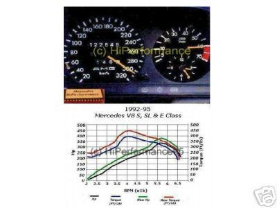

Many have already did back to back dyno tests of all the chips on the market. NONE provided any hp gain. Nor has anyone been able to provide any proof of a hp gain.
I ran one of these generic chips in my car for a while, with dyno tests both before and after. No HP change.
For $50/$75, this is a nice upgrade just for the rev limiter increase, cold start delay removal and top speed limiter removal.
Same here, I've never found a chip that made power in a 1992 module.
But, if someone has created a custom chip that does so, great. I'll need to see dyno graphs before forking over $$$ though. Has to be compared to a stock 1992 module, btw.

The results of the dynamometer car should be in about two weeks
Mercedes Benz is the guy...that does not tell me anything. What is the guy's background? You need to provide a bit more info.
I personally would want to speak with him about his chip and if you get dyno results, your best option is to show two dyno results with the original chip and then with the new chip.
If any of these chips ever worked and as you can see, quite a few have been tested with zilch as far as any true and measured gains, all of us would have them in our cars.
I do hope you understand that no one chip can do what you or the guy who made the chip is claiming, when it comes to hp or torque gains.
Yup, that's why I asked for dyno results compared to a stock 1992 module. If someone has finally figure out how to get a bit more power, great, but I want proof before buying. I've already spent too much time and money at the dyno and dragstrip proving the other common chips on the market don't add power.
:star:
Me too. I would jump at any chance to yield 10hp for less then $100 any day of the week. And the proof I would want to see is two modules tested, not just the new chip.
So here we have two different 036 owners from Poland who claim their modified chip is providing that much hp and tourqe, with 10% to 15% more hp and torque on this thread and the "Brabus modified chip and the effect is 380 HP at the dyno and about 560 Nm torque" claim from KamilW124 - who can only manage 13,7-13,8 secs 1/4 ET's with all of that power the car apperently gained.
I took the liberty and ran this by a very good source with an intensive backgroud while working for Brabus North America and the response I got was simple and direct - B.S.
Hopefully they will be able to dyno it in a couple of weeks (with custom chip, vs stock 1992 module) and post the results. If there is power to be had, I wants it!! LOL!!
