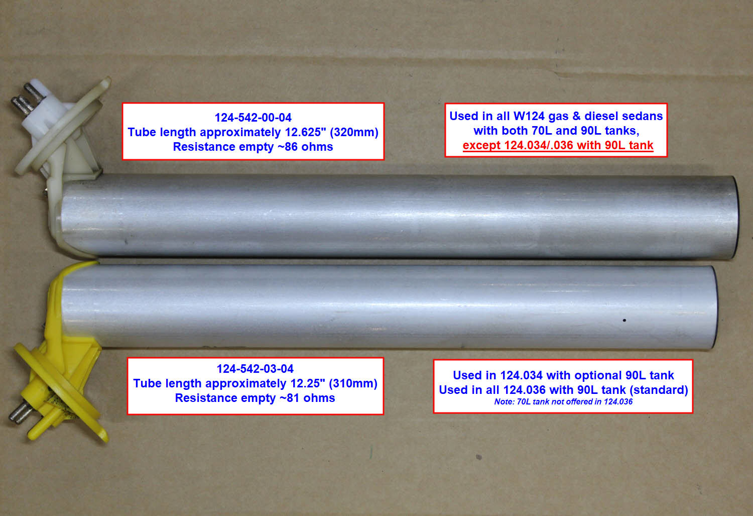

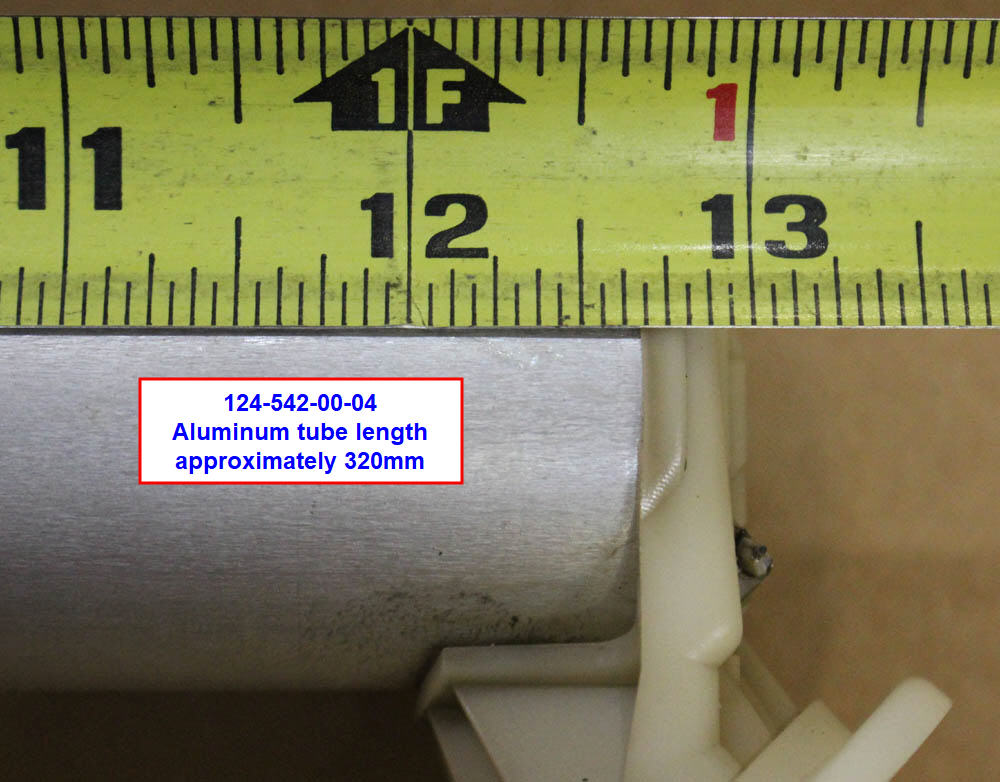

Yup... try to repair your existing one first, since the 90L yellow-top senders are NLA.
EDIT: Photos attached.

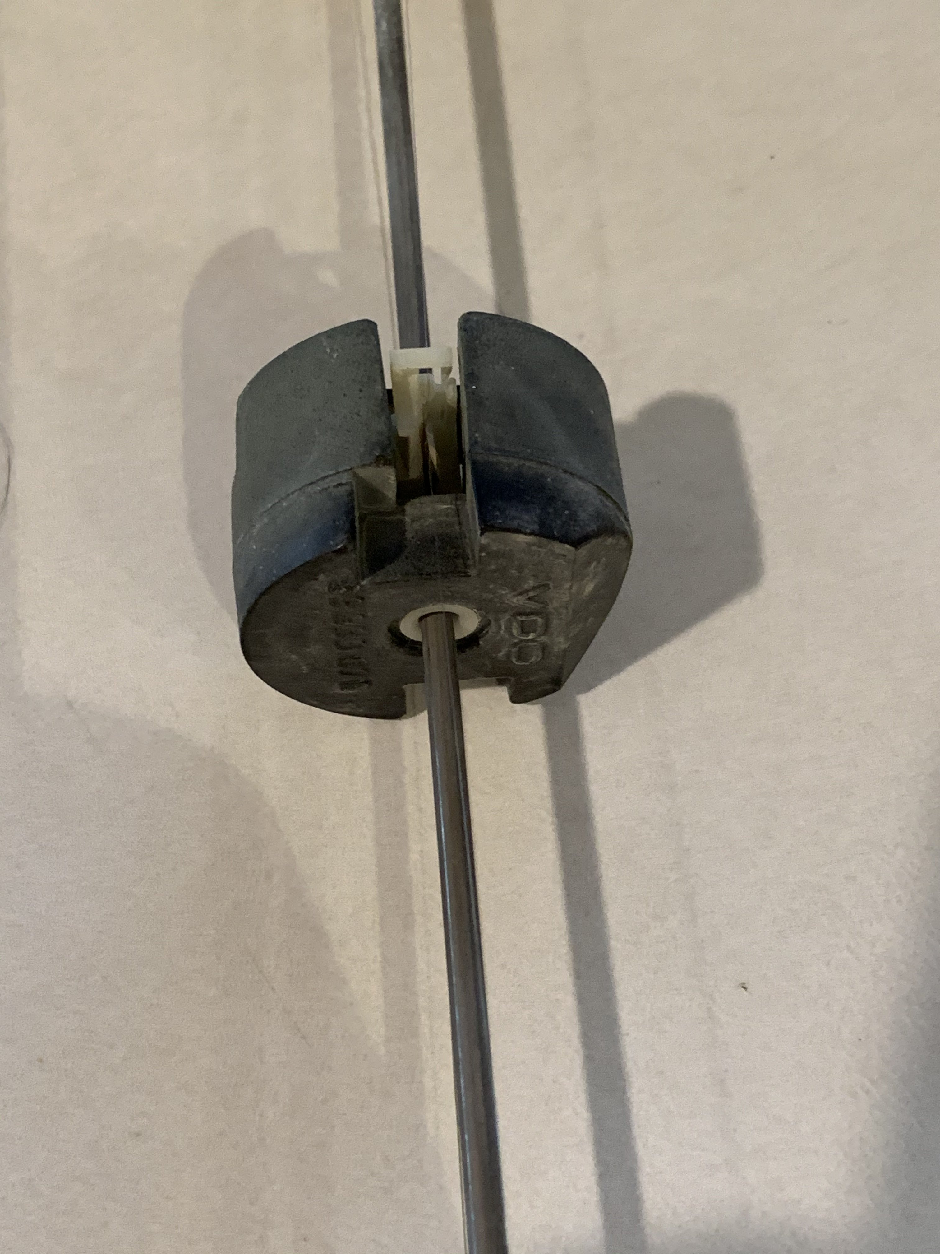

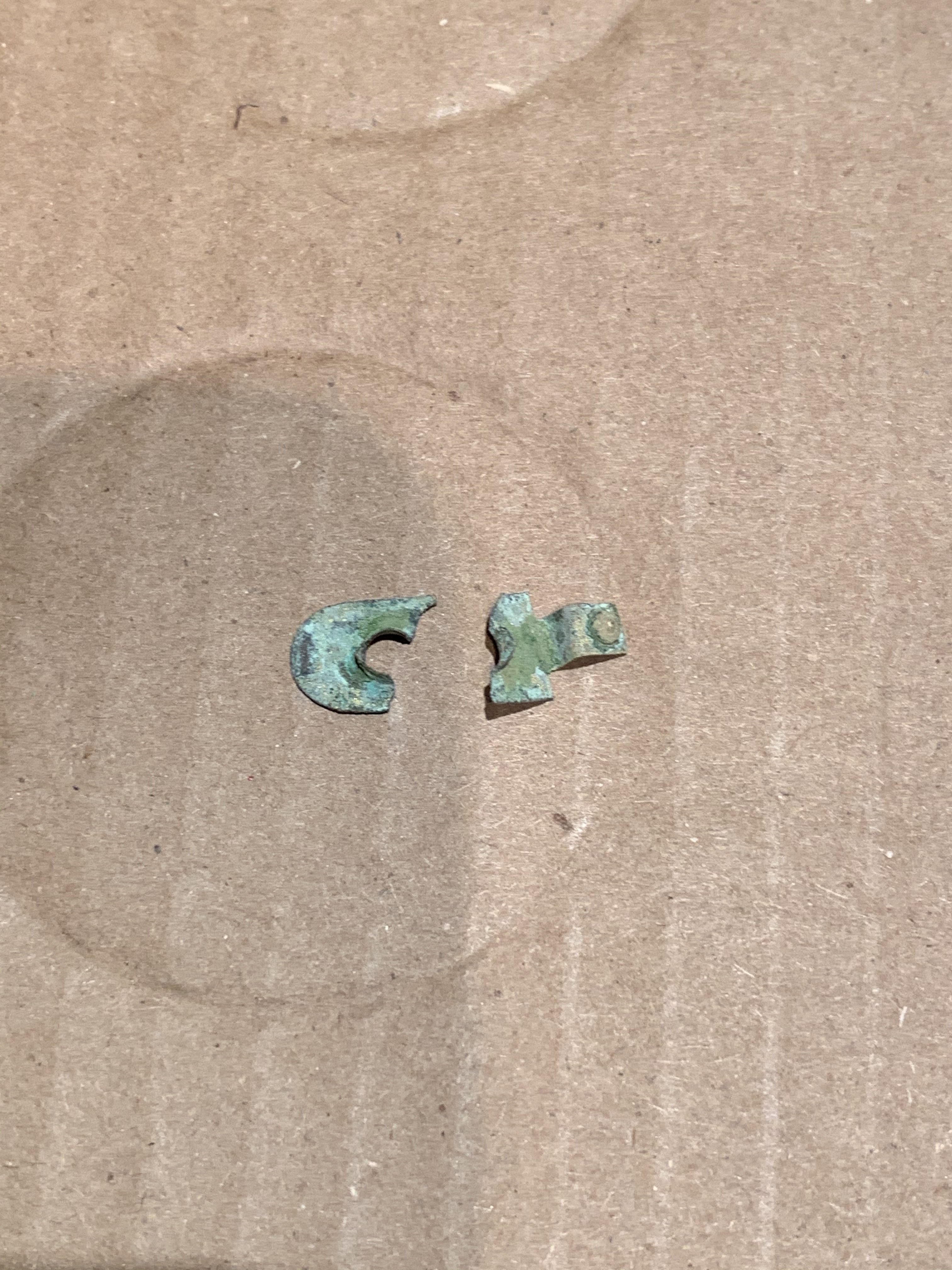

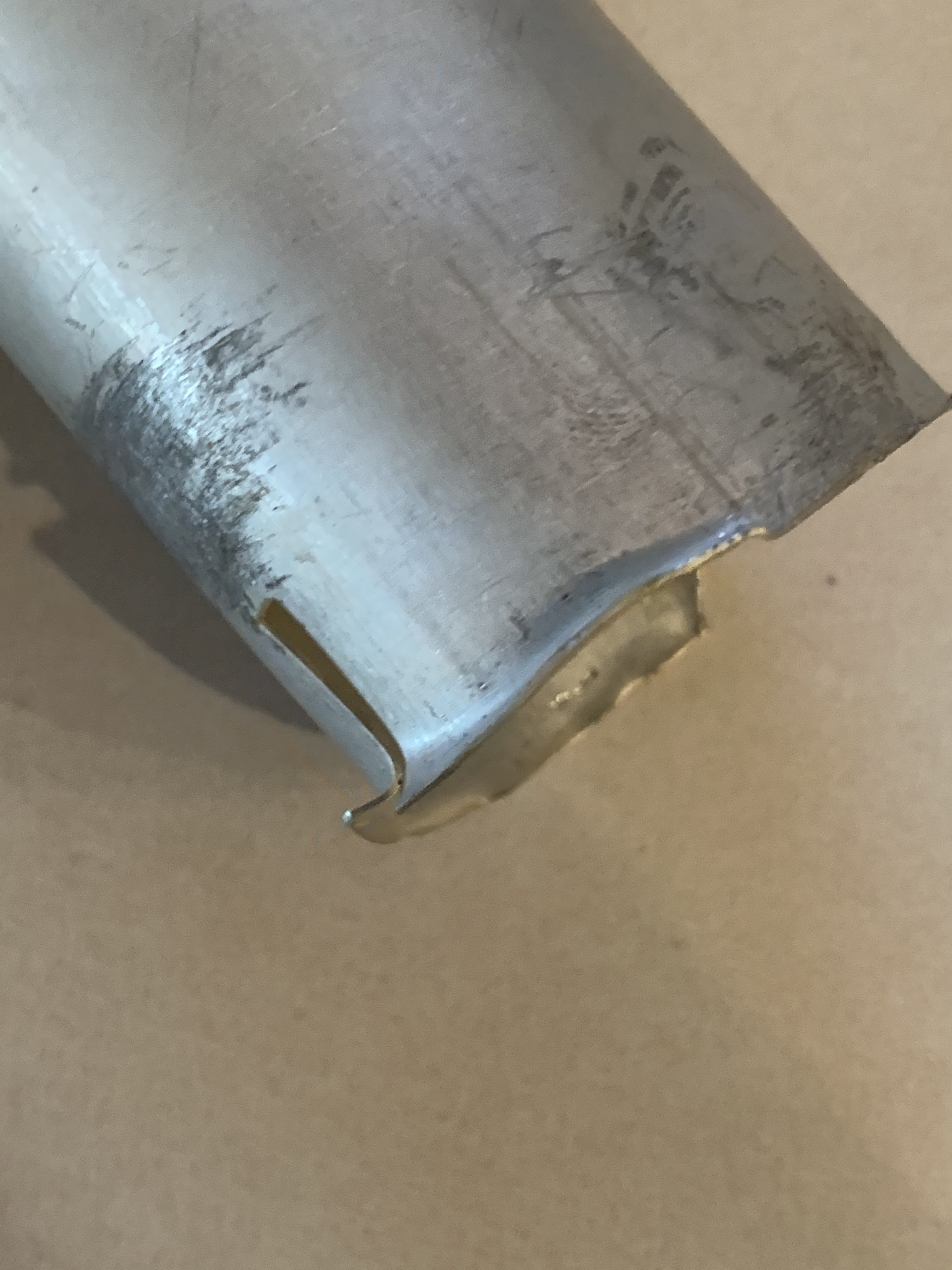

I repaired mine. The base plate had cracked in several pieces. So I had to braze the brass together. Then replace the resistor wires that had kinked and broken.
The small brass base plate broke. I believe it was from stress of the tank collapse. It curled the edge of the Sender tube.
so plate breaks and the plastic base then springs up against the tension of the wires. Wires get kinked and breaks...
