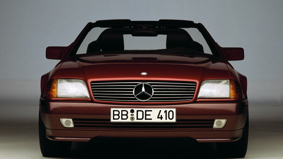

Rick, it does have wipers right now, but I will do a complete wiper delete. R129 with factory xenons don't have wipers, all glass headlights look very clean on those cars. Since the car needs a full respray anyway, I will fill in the trim pieces holes and forget they ever existed.

I like the wipers!

D,
Don't bother with filling holes. You can buy the blank plates for about $12-$15/each from the dealer. PM me for the part numbers if you need them. I did mine this way and just shot them with a rattle can of matching enamel from APS/Tower Paints. I've got a thread in the R129 forum on BW showing my install - it's active right now as there are some others looking for the M-M headlights from the Latvian guys.

I like the wipers!
A lot of folks do. I'm after this look

Cheers Dan!
Yes, please, if the filler trim is cheap enough, I would rather get the ready to paint parts from the dealer. Yours is the perfect look, and on the red car too, love it!

This is my fav look, although the wiper arms would look better color matched.
Sport package and xenon on that car, with wipers - I actually like!
