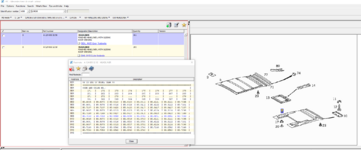

Factory color code per EPC chart above is 7C53 which is a light gray color.

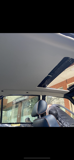

I just did my headliner two weeks ago on my ‘92 500E Midnight Blue.
I am happy with the results as I also changed many sunroof components including two new arms.
@Eno, Your headliner looks great! 😊

Thank you sir. Unfortunately I did not take lots of photos during the whole installation process.
Thanks, on another note could you educate me on those colour codes please. I have also access to online MB official catalogue through my local dealer. I couldn't work out those codes.

Thanks, on another note could you educate me on those colour codes please. I have also access to online MB official catalogue through my local dealer. I couldnt work out those codes.
Look at the screenshot in post #2. The 3-digit numbers are your interior color code from your datacard. The first digit indicates upholstery type (1xx is velours/fabric, IIRC; 2xx is leather). The third digit is the color: 1 = black, 2 = blue, 5 = cream, 8 = gray, etc). So, 261 or 271 is black leather interior.
After you find your interior code, now look below at the blue highlight "NO. XXXX". This is the color code for the headliner. Black interior would have headliner color 7C53. This gets appended to the headliner part number. So, the full part number including color code would be 124-690-32-50-7C53.
