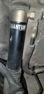

The car looks really nice - those Recaros are sweet. Any idea what the strange blue coil springs are up front? I've never seen those before.

Ditto!
Looks like they are height adjustable too...
Yes they are adjustable, You can adjust high of suspension
