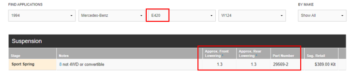

The part number I ordered is 29569-2. Ill look this evening to make sure that thats what I accually put on because I didn't verify. They were brand new.
I looked up a 300e and they also use the same part number. I'm looking up info on the H&R website. Is that the right #'s?
29569-2 is for a 6-cyl car. H&R's catalog lists them for the 400E/E420 also but that is wrong. And it is why your car is sitting too low. I can't believe they have this on their website. Same (claimed) 1.3" drop with either E320 or E420 from the same springs? You cannot have the same springs for two completely different chassis (6 vs 8 cyl) and expect the same lowering, when the V8 car weighs a few hundred pounds more! :facepalm:
I'd get factory Sportline springs but those will cost more than H&R. Alternately, you can cut your stock springs, a little at a time to achieve the desired ride height. I'd aim for 14.0" all around and be really really careful if going any lower.

Went back and found my invoice from ECS Tuning and it’s part number ES#: 1303335 which corresponds with 29569-2 from H&R’s parts catalog.
I bought these back in 2019 and I can’t believe they would be different now than back then. I suppose it’s possible the manufacturer changed the part number so it’s a single part for all W124 sedans and ECS used the same one.
