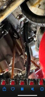

Well… it is a niagra falls style oil leak … approx 1 liter per 10 sec….
Anyway the leak is from the right side in the oil filter housing but I cant specify the exact erea
There are no oil cooler hoses in this engine… all bolt were tighten and tourqed…

The erea of the oil filter housing…it is very high pressure running oil…
I cant specify the exact location
In about 5 sec all the oil has been drained
I'd start by cleaning the filter housing and inspecting for cracks, and try to figure out a better location of the source... top? bottom? gasket? Etc. Might need to put a few quarts of oil in and have someone else start the engine while you are watching the housing for the geyser.

Here some pics for reference

Yuck. Douse that area with a can of Brakleen or other degreaser to get it fully dry, then watch it closely while a helper starts the car, ready to shut off immediately when you holler.
