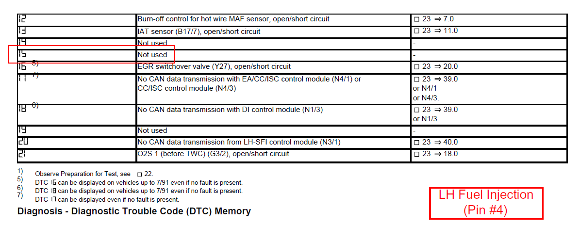

Seems that the MAF is reading inaccurately at 3.6kg/h and that this code that keeps coming up.
What’s that note about the CAT overheating? I think that’s a bigger problem at the moment.
If the MAF is reading 3.6 kg/hr with the engine running, yeah, that ain't right - assuming the harness is good. Idle should be ~20kg and it should increase from there.
Code 15 is "not used" for USA models. Looks like a Japan-spec error code, Japan had a catalyst heat sensor to trigger an "EXH TEMP" warning light in the cluster.
Ahhhh, jap car. That makes a Lot more sense! That sensor loves to break...
OH, yes, you are correct... this is indeed a Japan-spec car!

Pic 4 of 99 shows the temp sensor in the side of the left CAT. So that’s where the note 15 overheated CAT is coming from.
