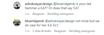

Dutch after 5 Bier is no Problem :jono: . The Miracle of 6,3 in believe ,when i saw it. This is an endless discusion.All heart about bot knowone saw this.Brabus makes maybe 5 100mm Cranks .and this is in my mind the only Way to make 6,4/6,5 Cap.And this is the same as AMG all blocks are closed Deck. not open deck. Take 5,0 open deck and lock at thin socket .not enough Thicknes for 102,0mm .
not sure but here in this Forum read about for years from an guy from idonesiea or India .He make 102,00mm bore .but works not long or perfekt.
but not sure
There was a AMG 6,6 M117. With 100 x 105 mm bore and stroke. Maybe the crank was also used in later M119 versions?
