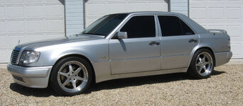

This is my E500. You think the bumper and cladding are Atlas Gray?
I can't say for sure from the 1 photo, but it kinda looks like the lowers are Atlas Gray.

You are correct, mine is not a 2 tone car. Atlas Gray it is!
Thanks again
Wait, do you mean yours IS a 2-tone car? 2-tone would be Atlas Gray lowers. Monochrome would be Brilliant Silver lowers.
Either way, have the paint shop spray a test piece to compare to the other bumper, before spraying the rear bumper.

I think your E500 would look brilliant in full brilliant silver, especially with the Evo wheels.
