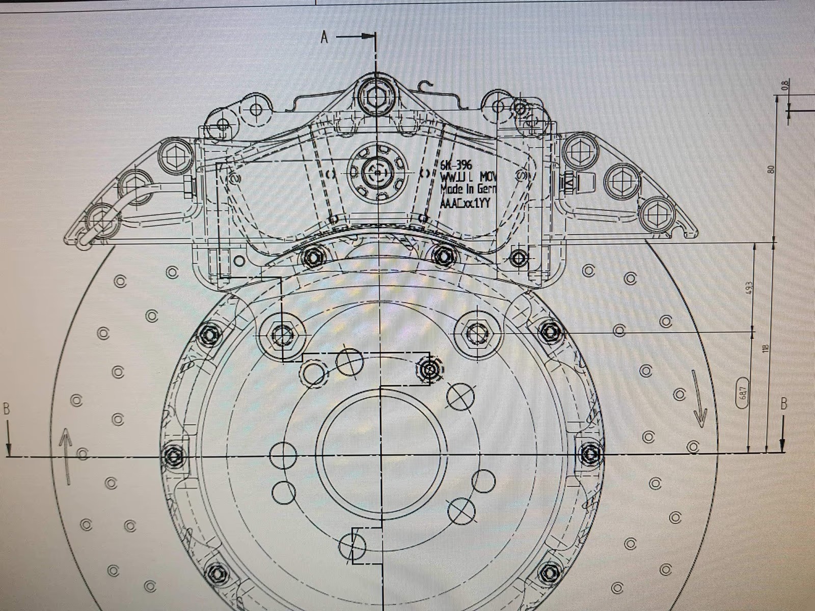

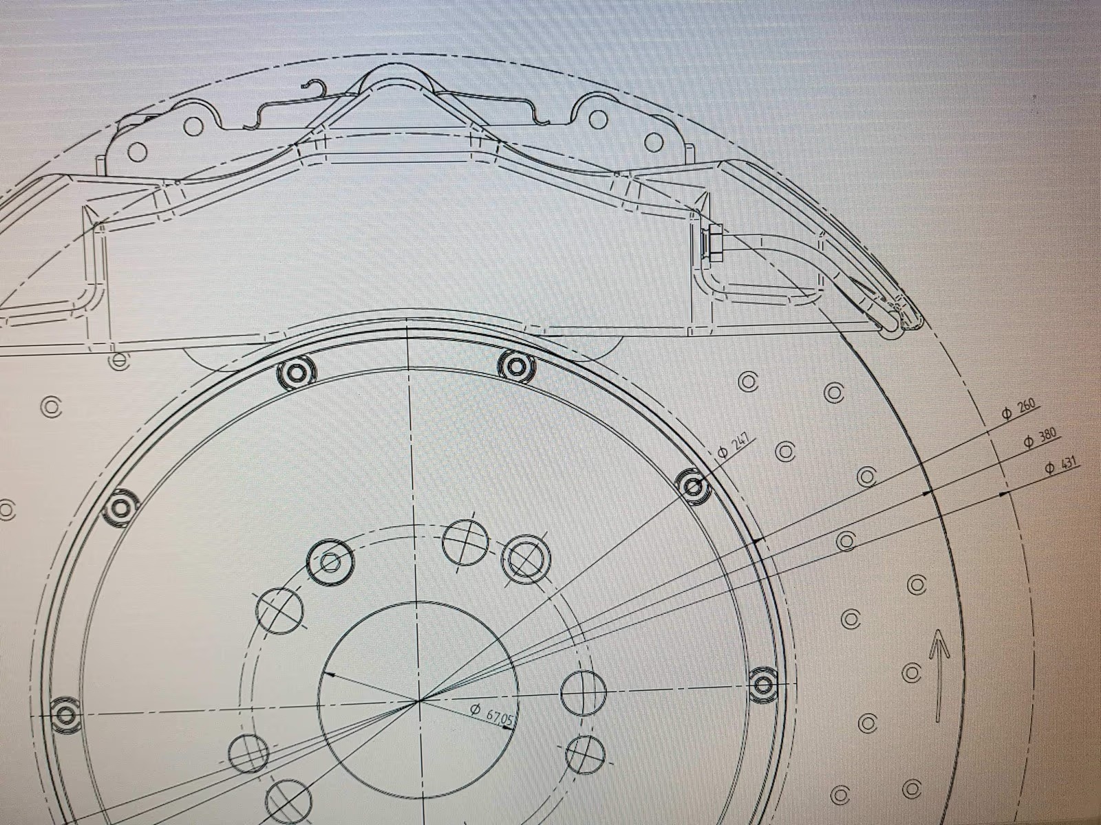

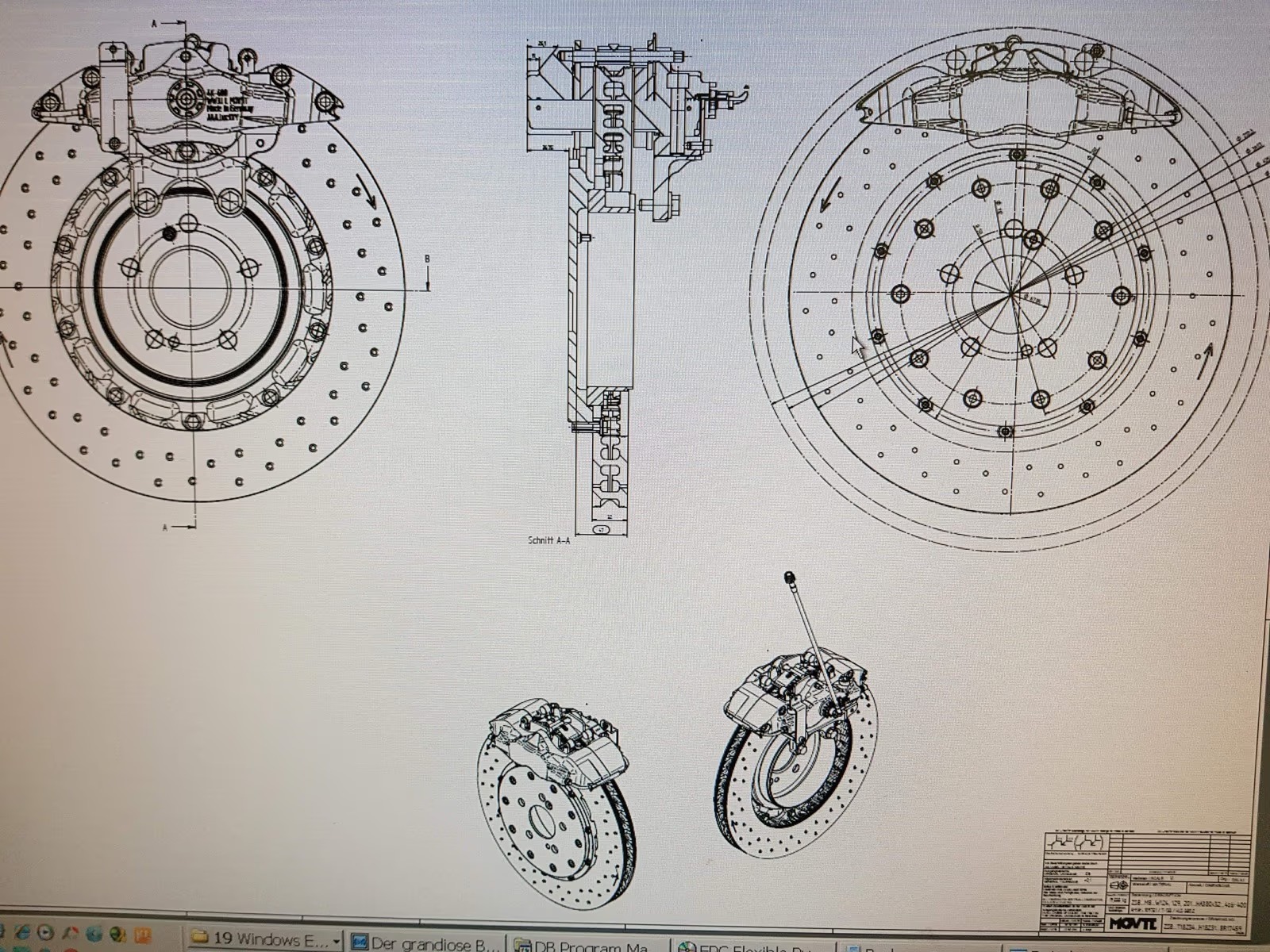

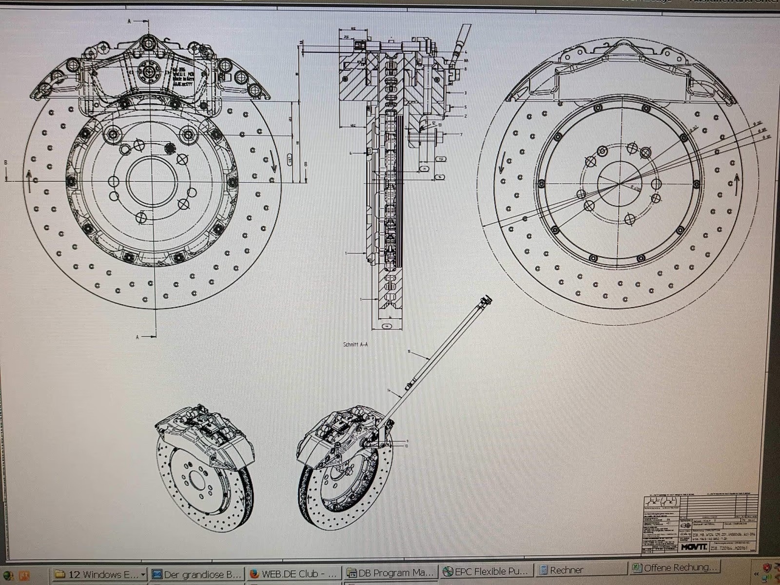

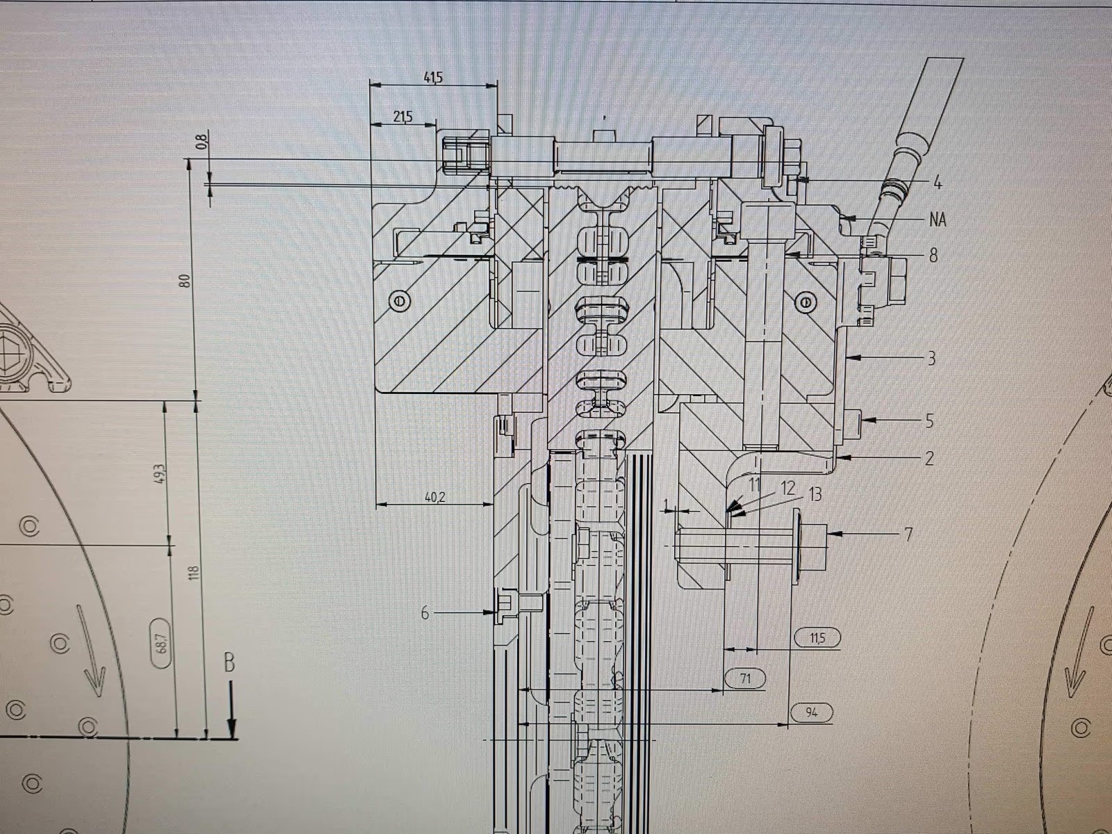

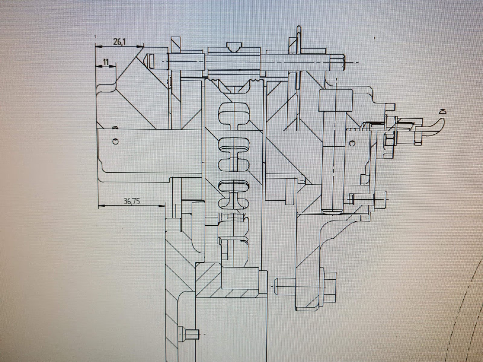

Those blueprints is the cherry on top!

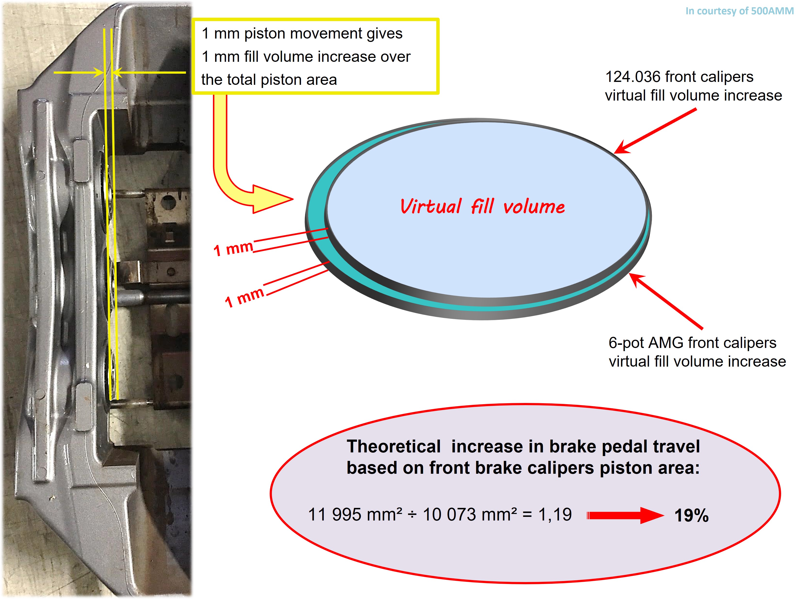

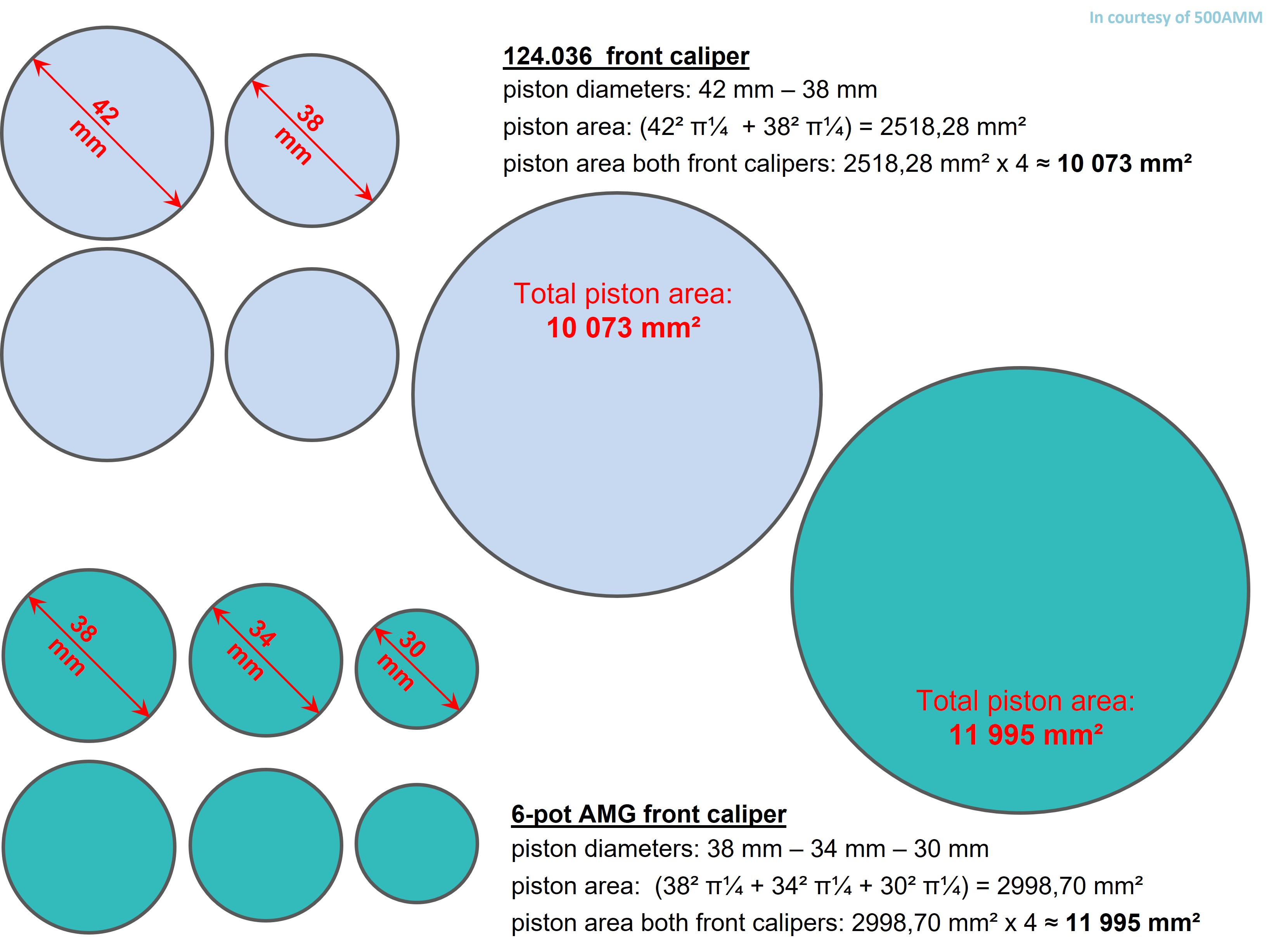

@Draginev it's not an answer to your question, but FWIW I did some calcs regarding increased pedal travel with a BBK install while keeping the stock brake pump/MC. This can be used to get an idea of the increased brake forces as well because the formula is based on force per area. The friction area is the total brake pads contact area, and the forces are transferred by the total caliper piston area. As long as the pressure source (brake pump/MC) is kept unchanged, that factor can be put up as 1 in the calcs. Then you can alter the total piston area to get an idea of the brake force. It is a number of other playing factors into this like brake line expansion, brake fluid temp and boiling point, brake pad compound, disc material etc... But as long as those variables are kept unchanged it will give a theoretical idea when comparing calipers expected braking force.
