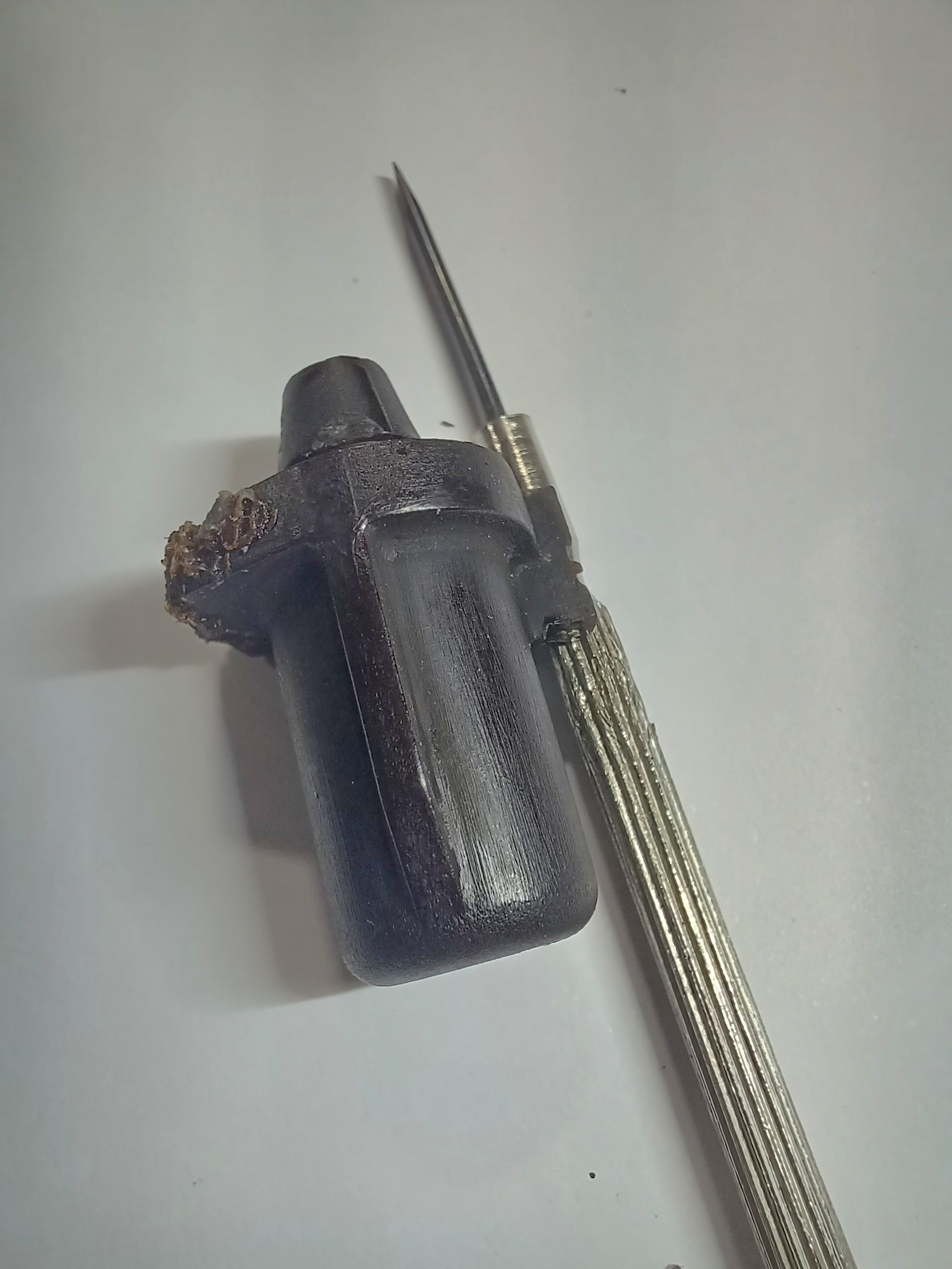

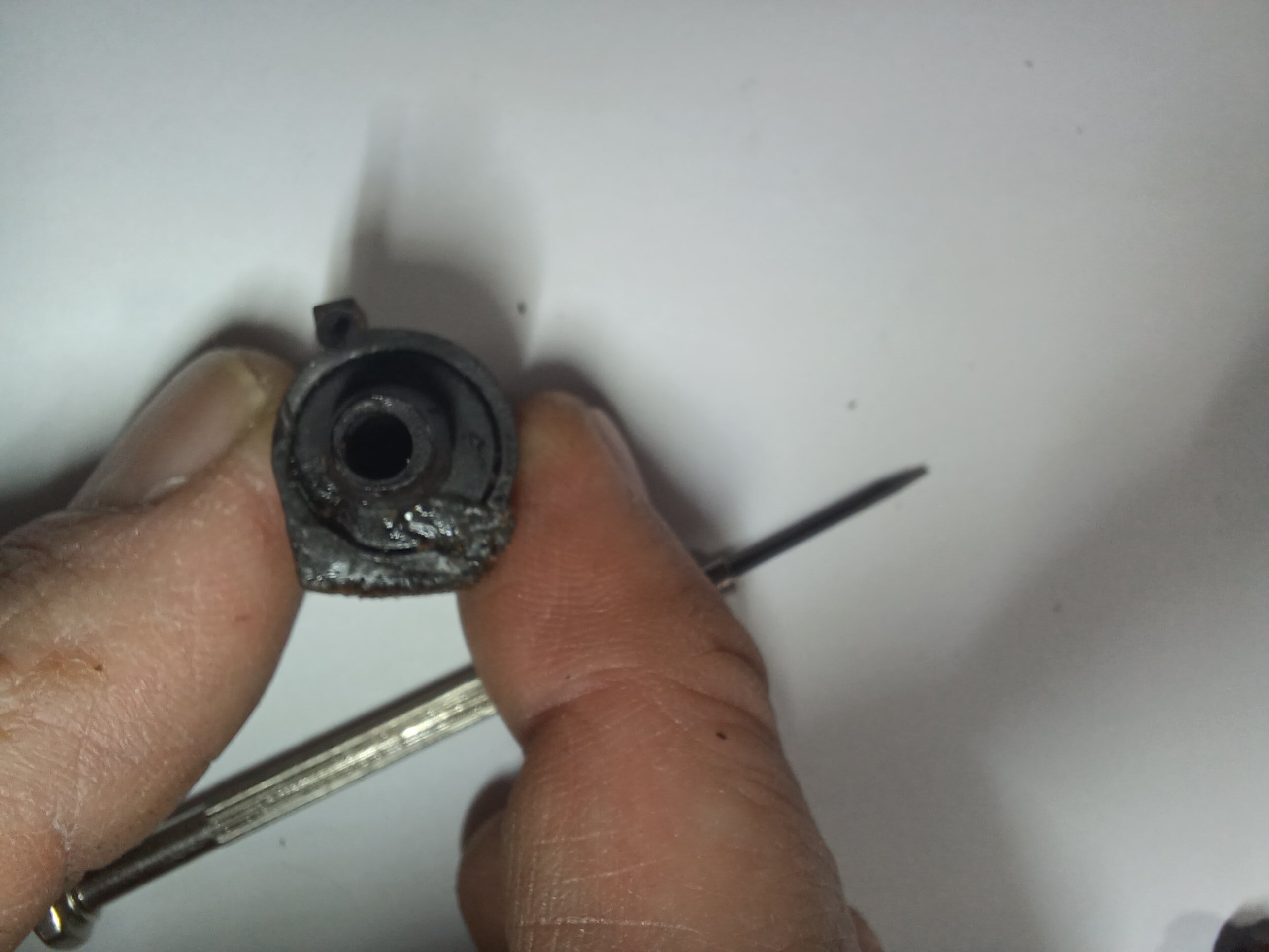

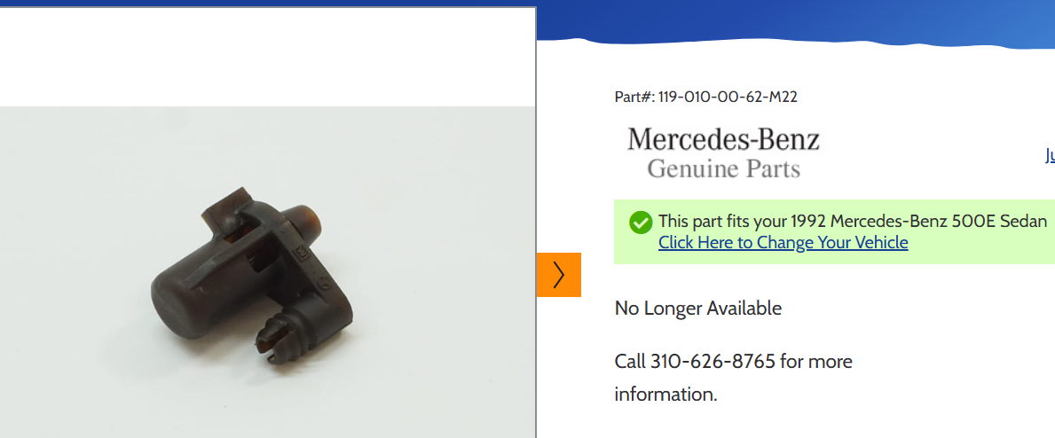

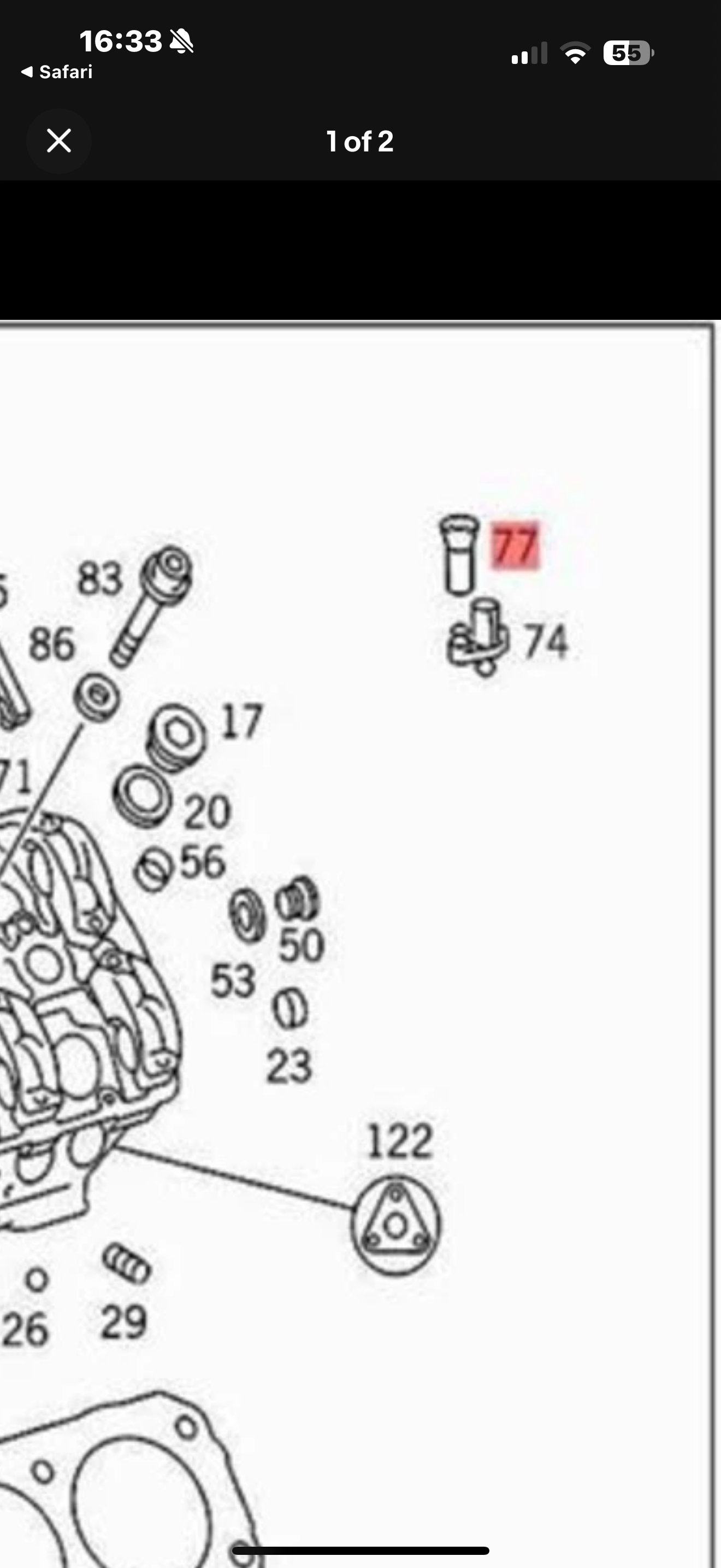

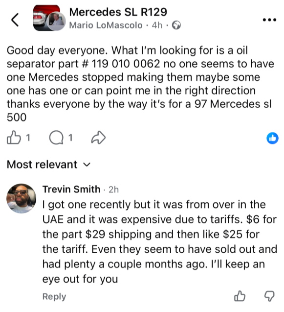

Does anyone have a spare oil separator part#119-010-00-62.
I ordered one from the dealer and online, they both called me back to let me know the part is NLA.

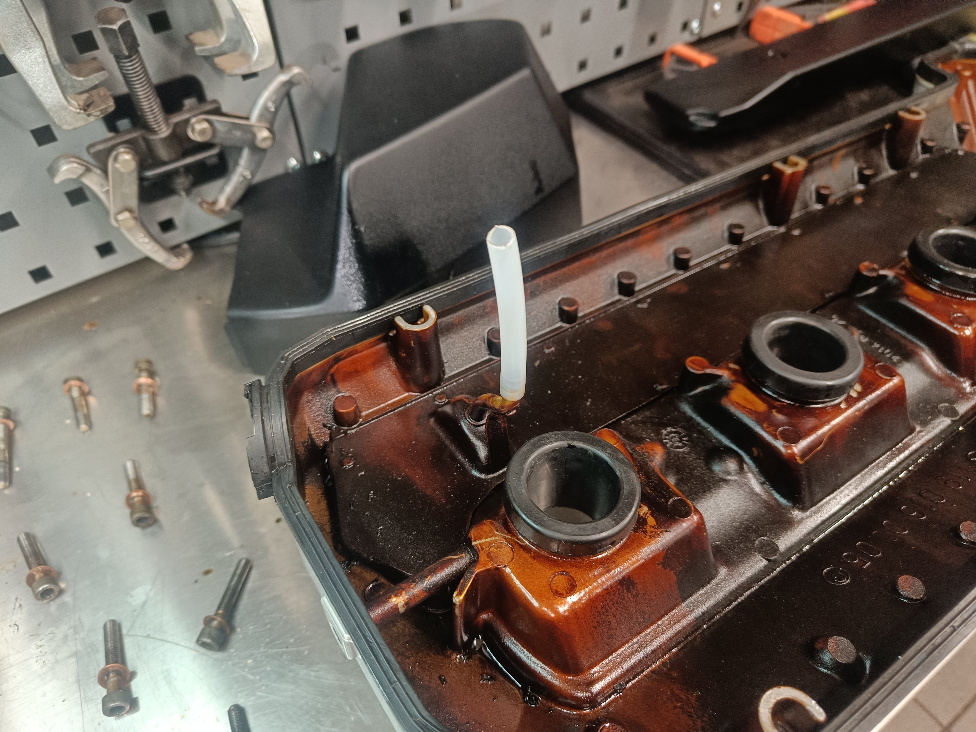

I have the valve covers off a need that part.

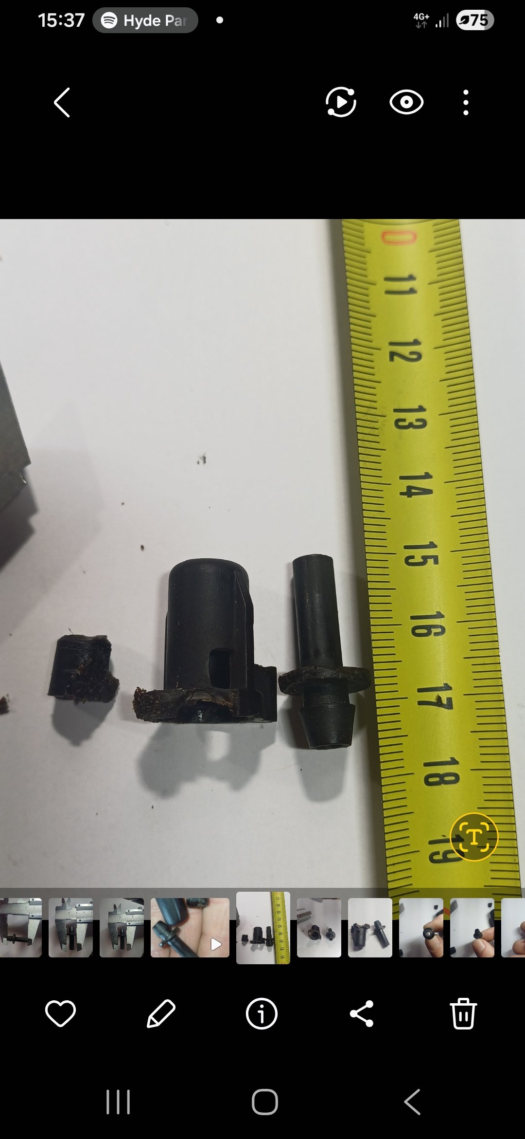

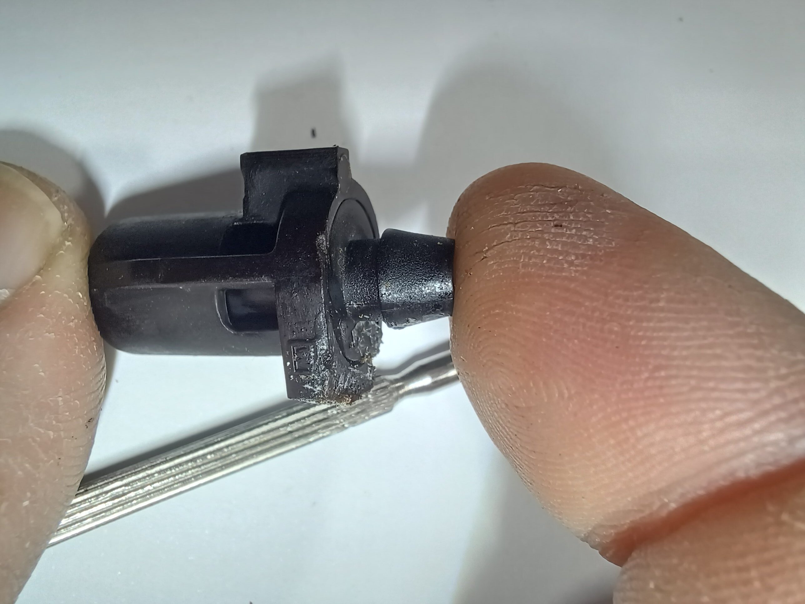

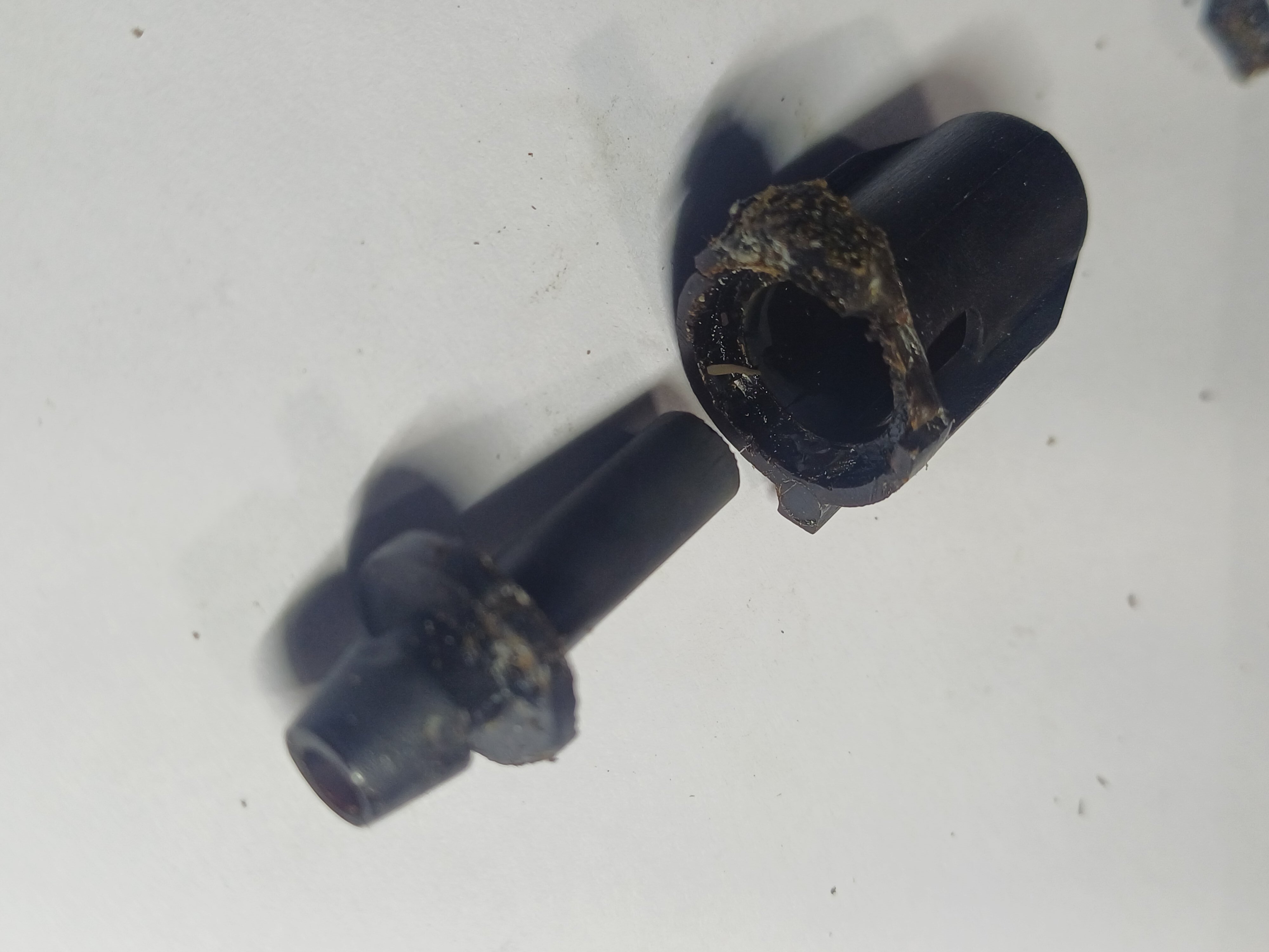

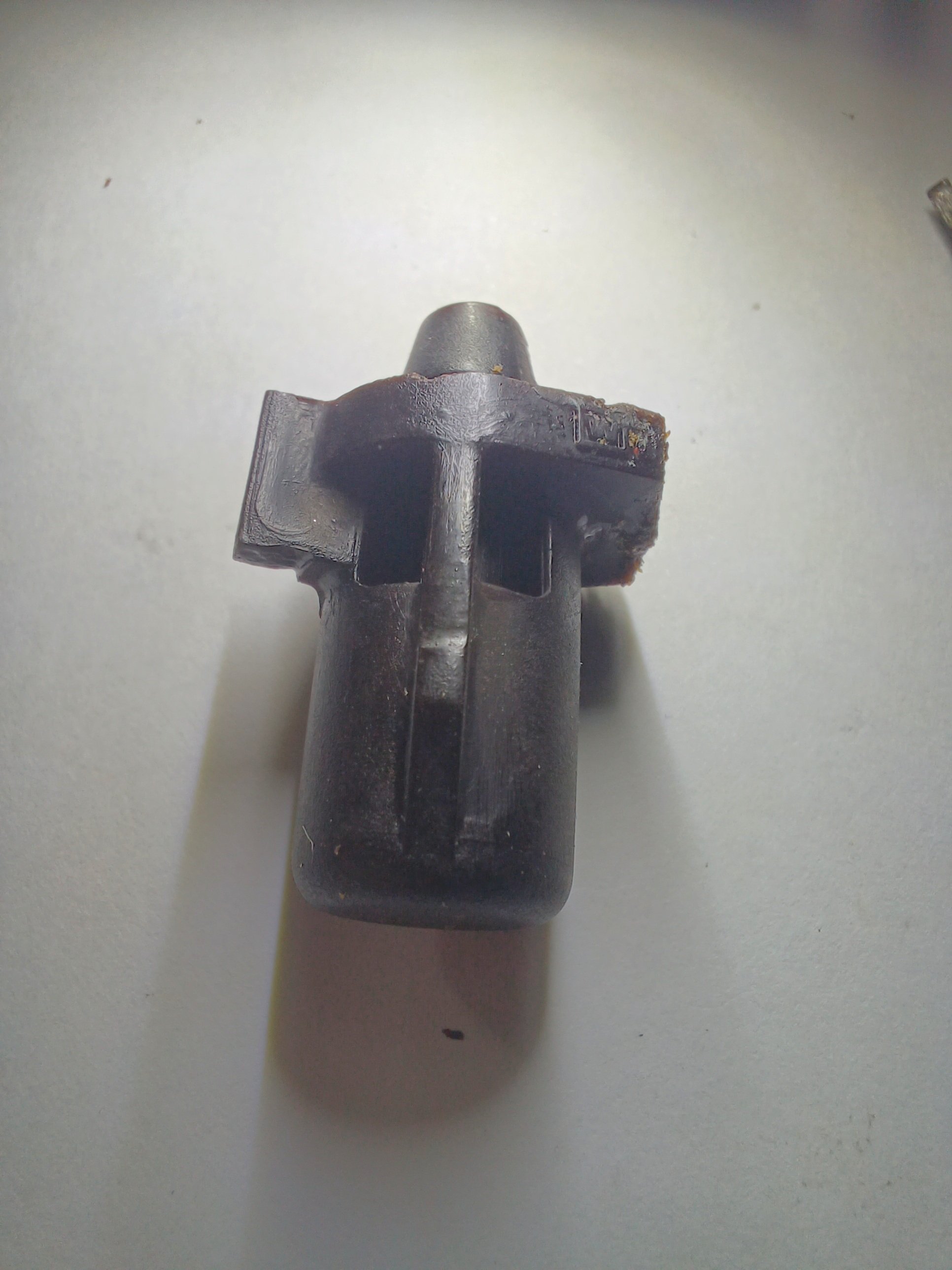

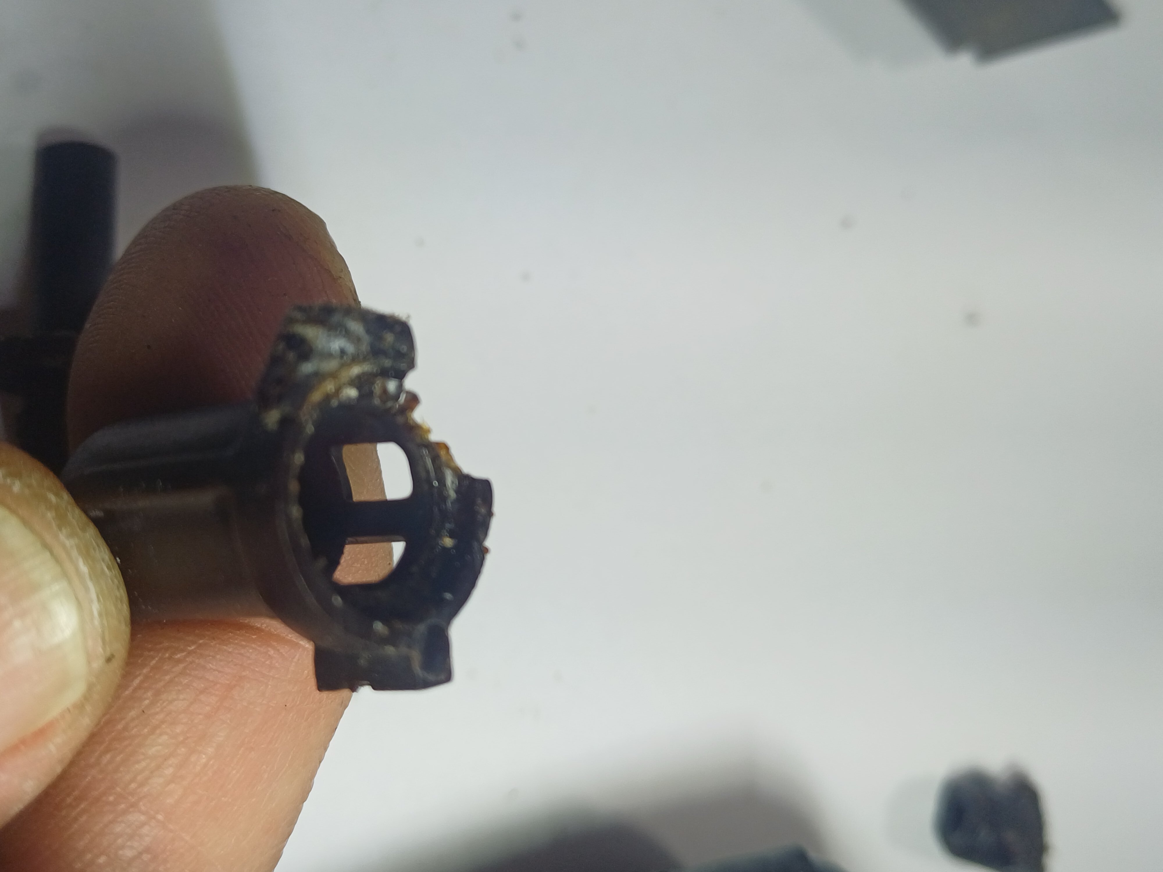

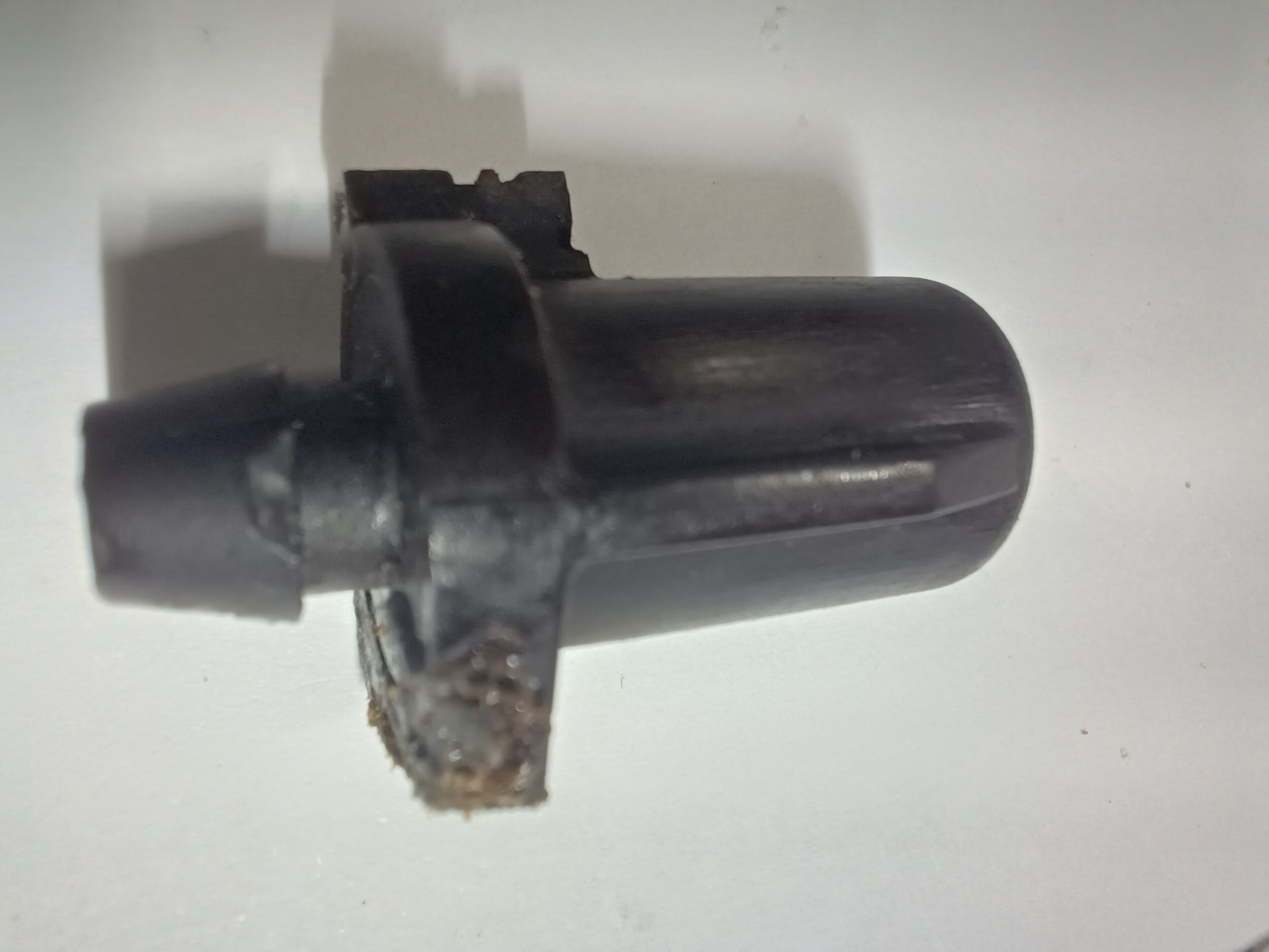

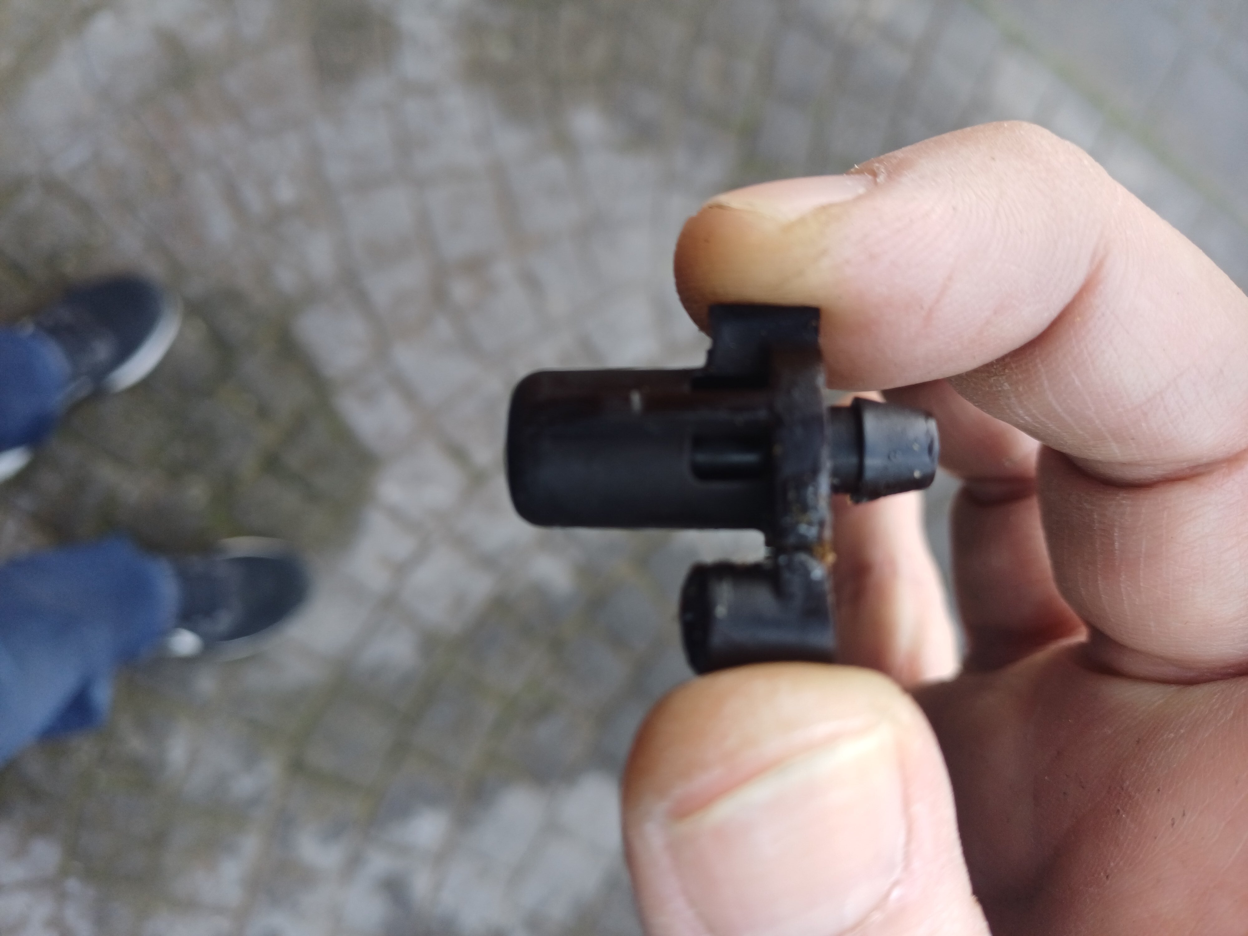

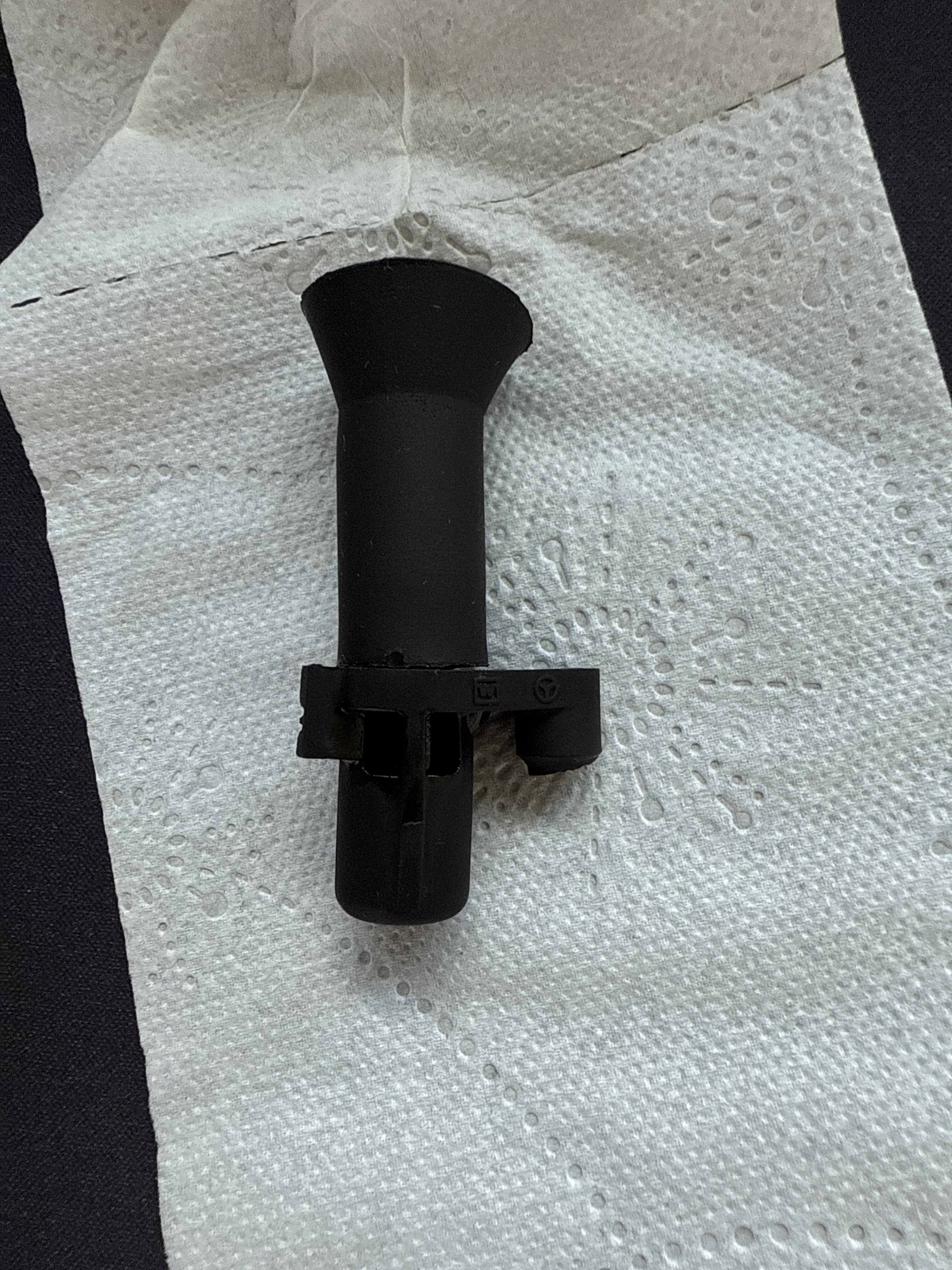

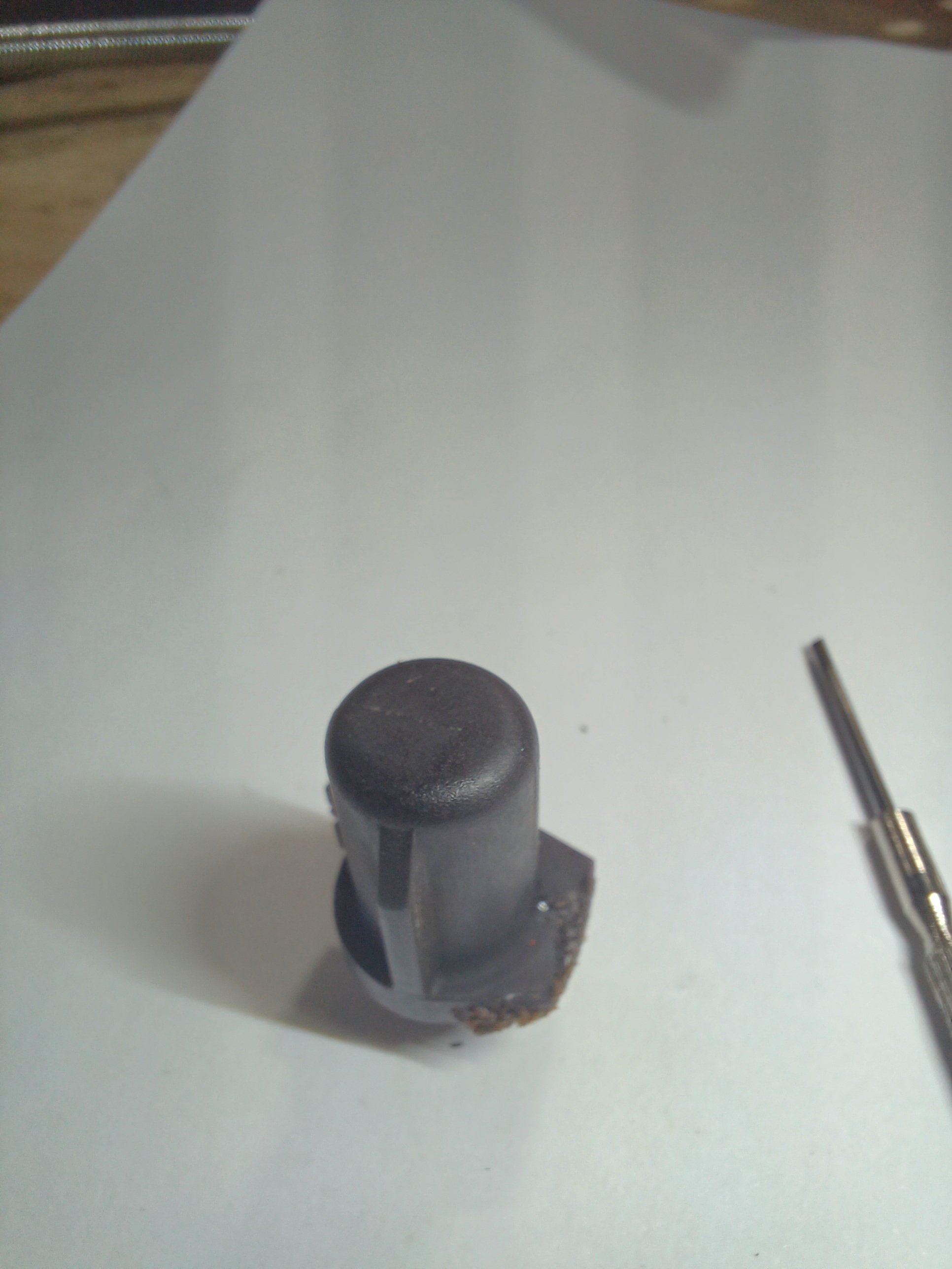

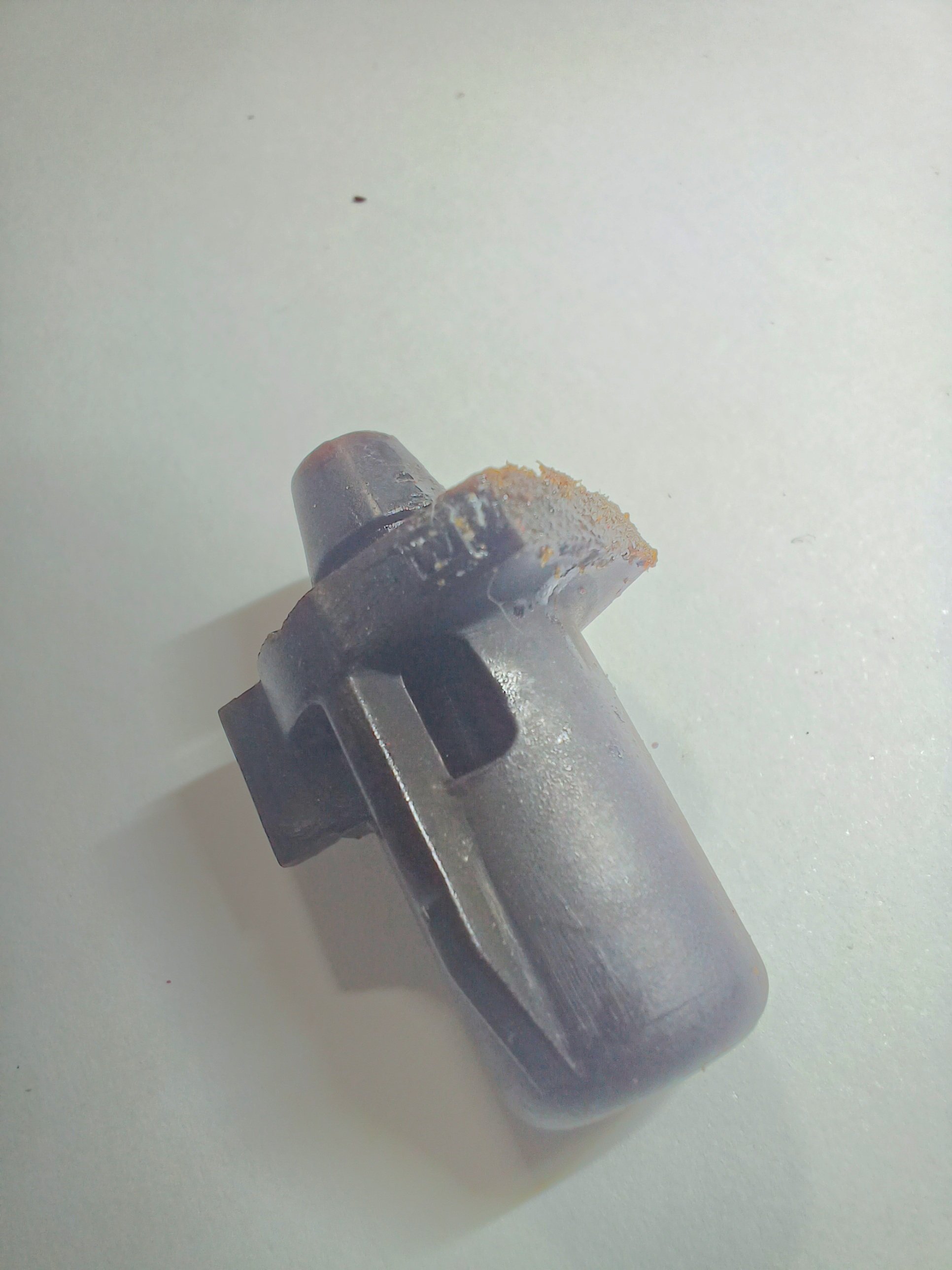

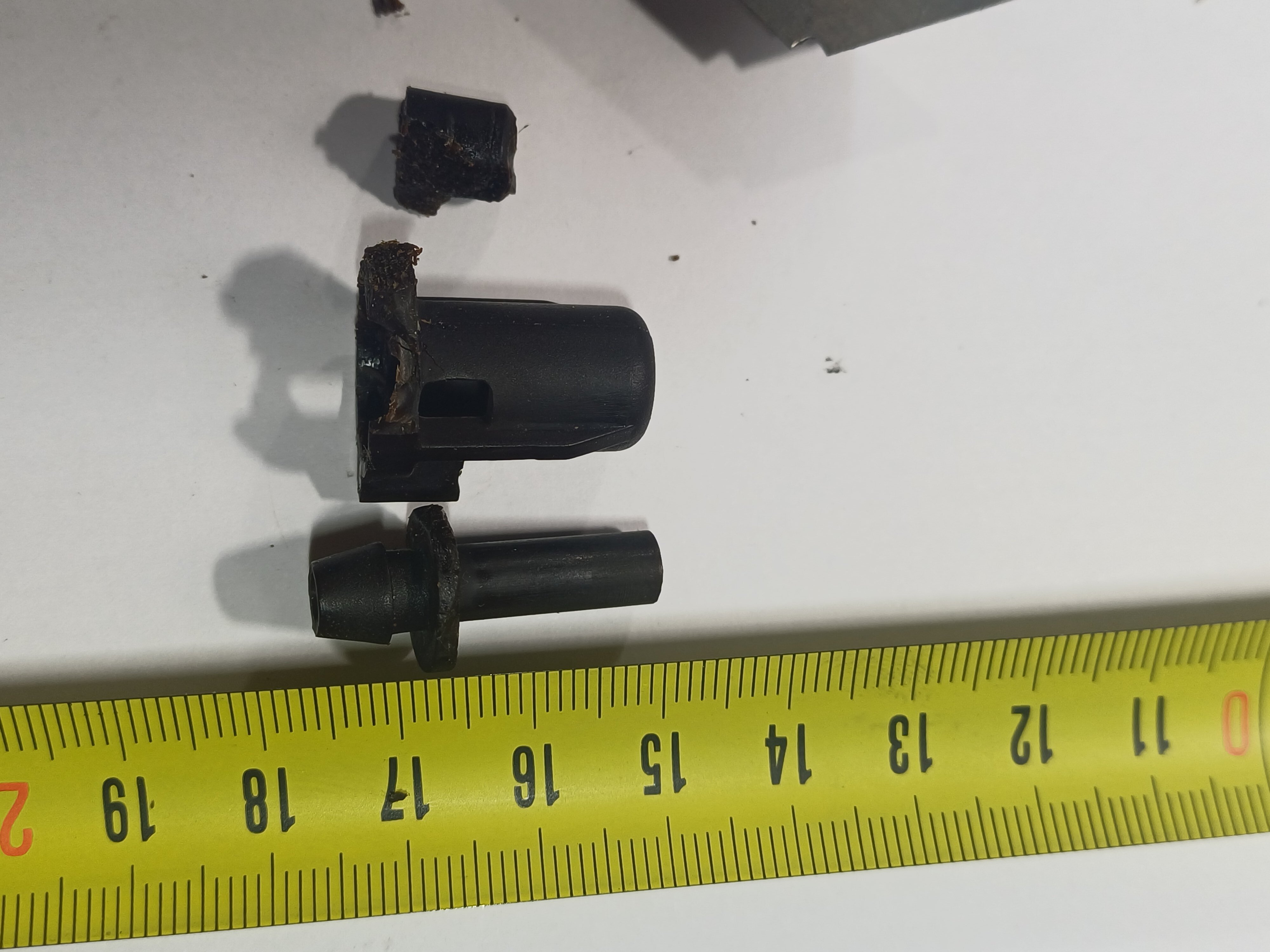

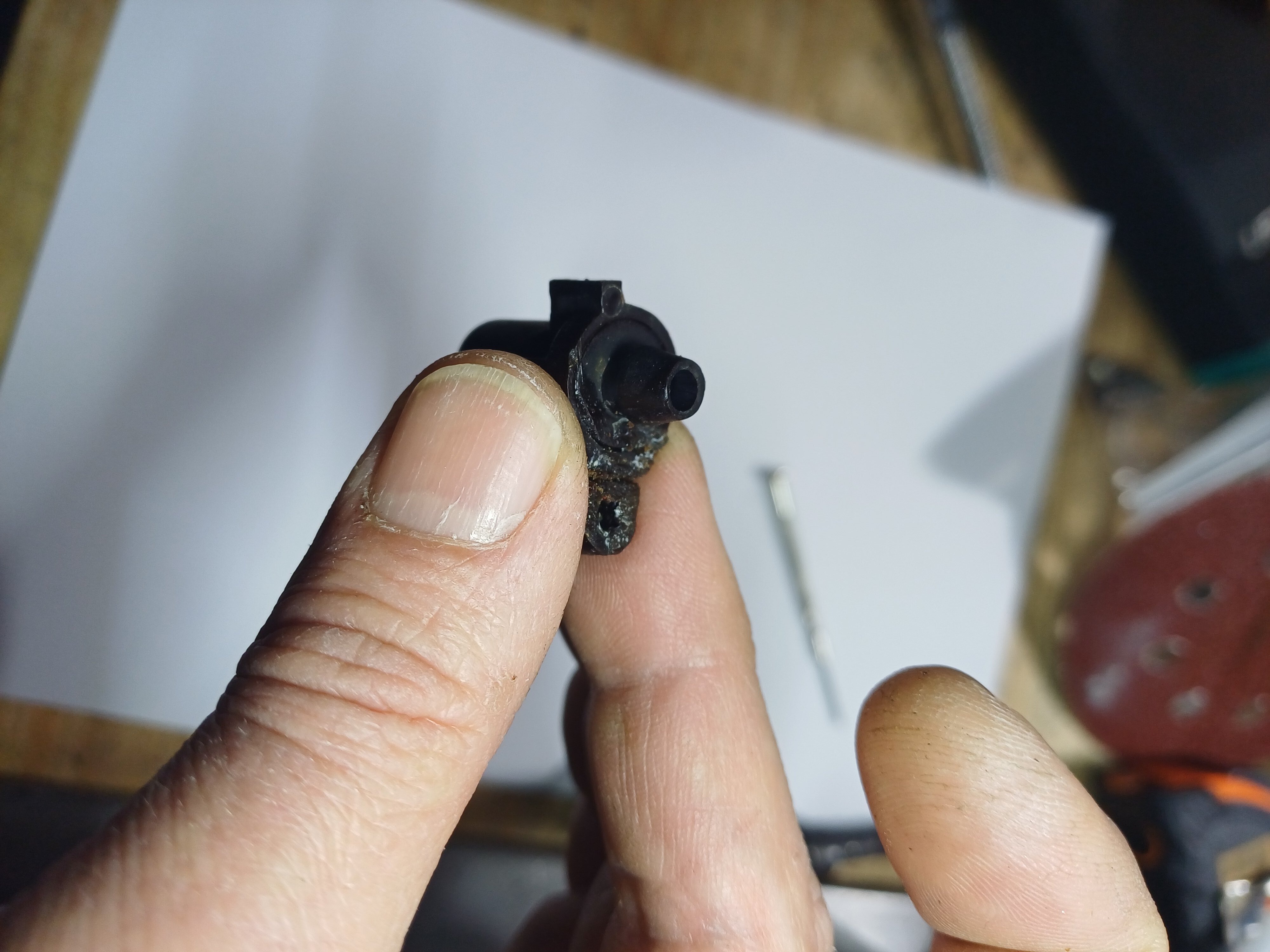

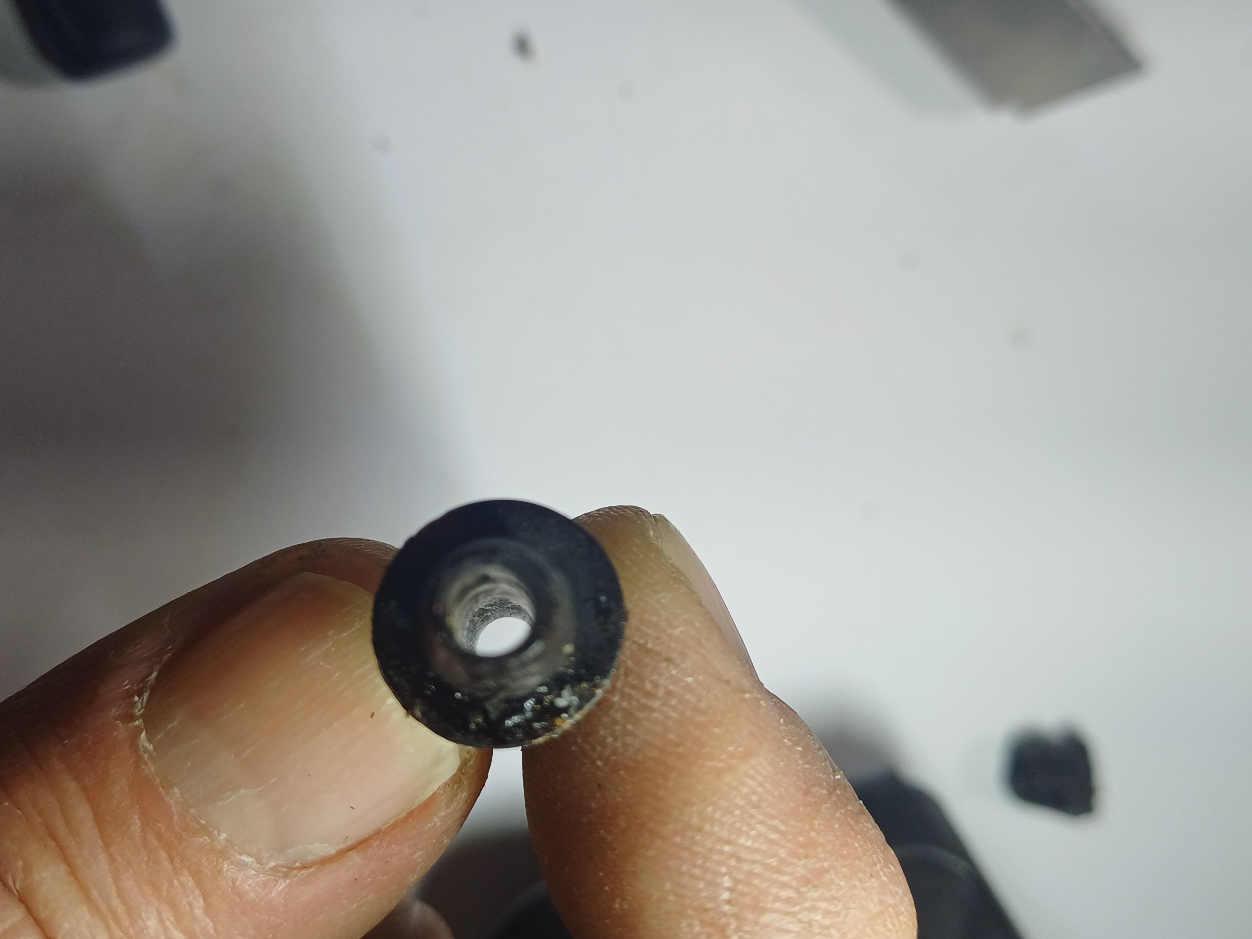

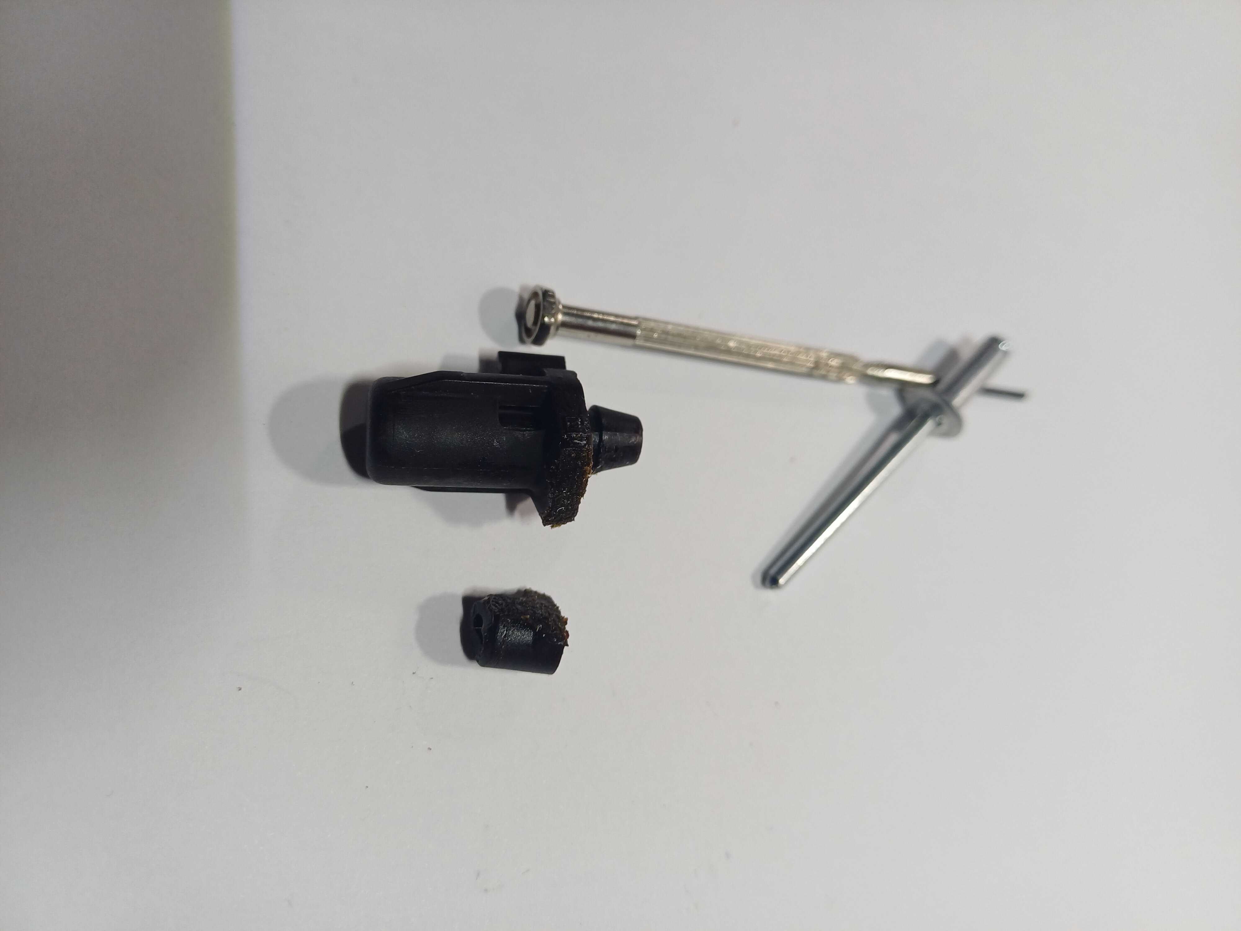

It's in the cylinder head, passenger side rear. A small rubber funnel attaches to this plastic piece. The plastic gets brittle and may break when removed, or when trying to replace the rubber funnel.

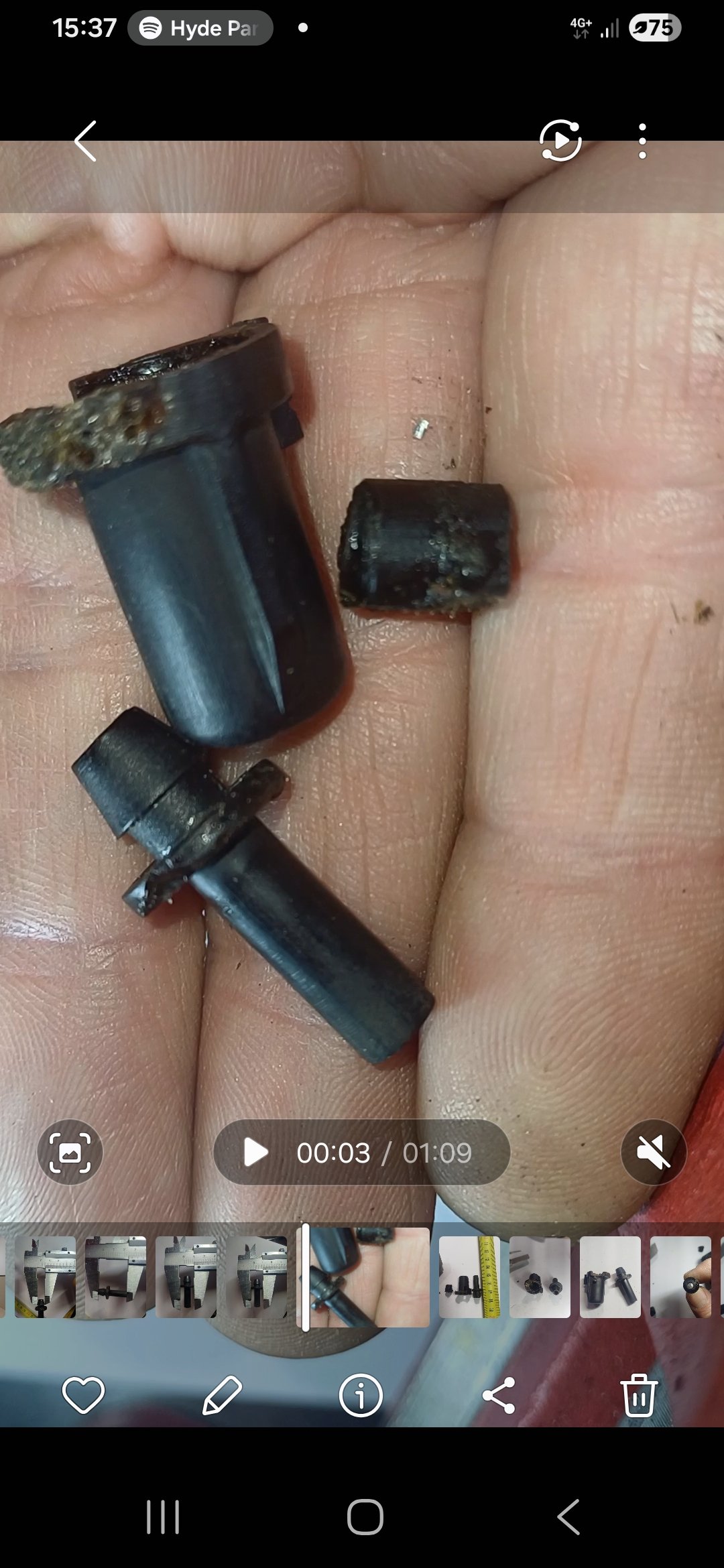

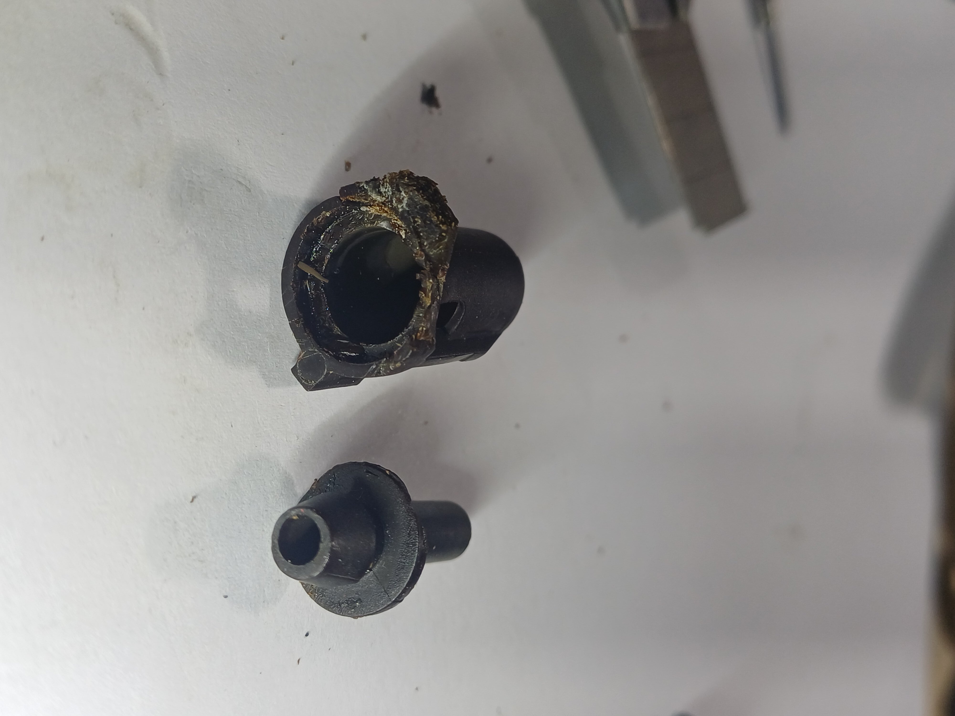

That's exactly what happened. I replaced the upper chain rails, and since the valve covers are off. I thought it's best to replace the rubber funnel as well. Removing the old funnel, the plastic on the oil separator broke off.
