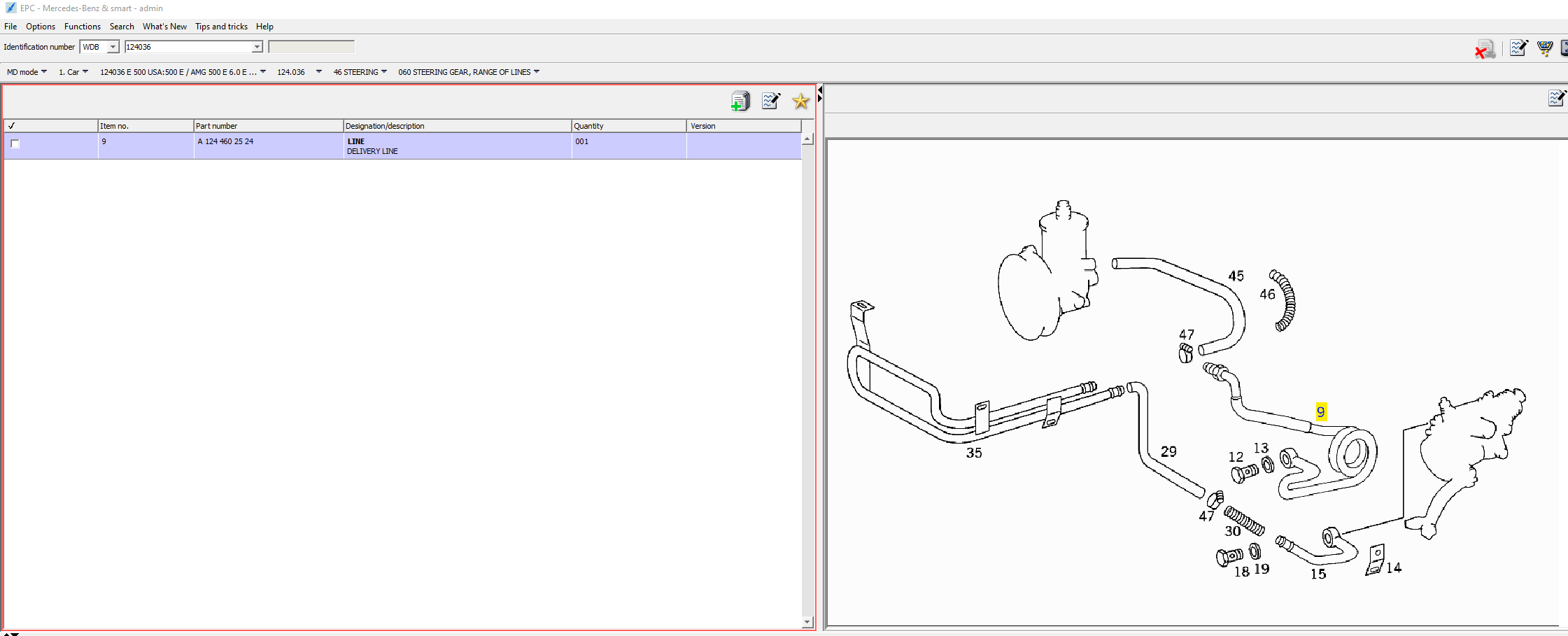

WANTED Power Steering Pressure Hose
Steve, the high pressure hose bas heen NLA for a while, IIRC. Your best bet is to have a hydraulic shop replace the rubber section of your original hose. You might be able to find a good spare from a 400E (any year) and rebuild/repair that one, to swap in.
Hmm. Worth a try, I'd contact them and ask if it's in stock or not. If they want to "order it" for you... that means they don't have one.
