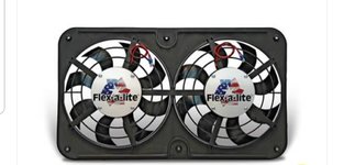

I like it, very humid in japan summer. City traffic, it stayed on 80c mark. It took me 3 tries, meaning 3 fans, different shrouds. I figured out the shroud is critical and made my own. Im happy with results. I can control what temp come on and off. My kick on is at 92c, and kick on is gradual build up starting at 30%. So my fans never go to 100% because after kick on temp goes to 80c and stay.
Do you have more details & photos of the electric fan (and shroud) setup? Sounds really neat!
:apl:
I used this set up. I had it with just this shroud on and the fan were on to much high for my liking. These fans a much quiet than viscouse fan. Looking at photos you see i made my own shroud to set these the whole assembly in. The goal is to cover the entire radiator. After i did that the cooling was great and the fans worked less. For temp sensor i did not use pod, i t tapp to original sensor on intake head. Its tapped by can box, just trace wires back. The controller is over the battery and ground terminals cover behind can box.

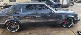

Definitely 19", at least the style you have there. The 20" look kind of weird on the car IMO, you know the 036 will never be a race car, but a great sport limousine.
...just my 2 cents :star:
@Provet,
Looks wise I like both sets. Maybe the Monoblocks a little better. I know with stock suspension I think 18s are the limit for a good ride. You say you have “Air Ride”. Is that on all 4 corners? If so how does it ride on these big wheels?
PS: I like the electric fan set up.
lol
19. I have 18,19 and 20 on the Baron.. 18s for the period correct size and 20 was waay to big for the W124
@Provet,
lol
All 4 corners air ride with bilsten HD sports. Feel road but not too rough. Bother set wheels are 3 pcs, but I know what you meant when you described monoblock look. 19" x 9f 225x30 x 10R 265/35. 20" are 9f 235/30 X 10r 265/30. To my surprise, the 20"s Ride better. Bothsets are utilizing accelera tires which I also was a surprise very quiet.
*19F225/35
I fealt the same way you did at first, until I put them on and drove. I guess it may depend on tire and type rim for ride quality. As for as look, they kind of grew on me. It makes the car look weird but in a unique way. I never received so many horn blows and run-up's as with the 19 Than 20's. I love the mob style mono's, that why I had to make sure I was not tripping and ask from the guys that are "for-real about the 5"!
