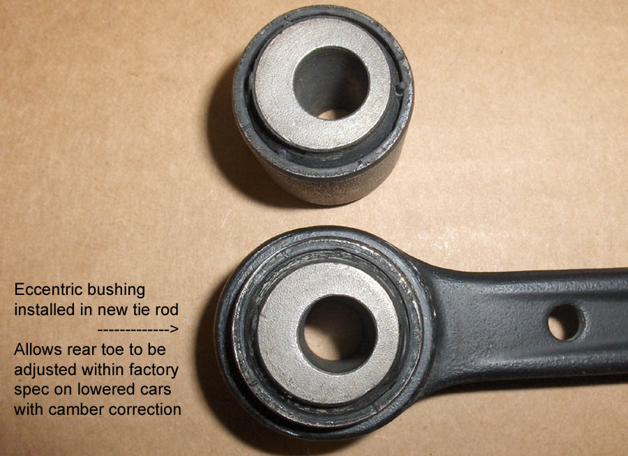

Just so I have clarity. The LCA's are not enough to accomplish correct lowering. The toe in needs to be adjusted via eccentric bushings. Is this correct?
If you want the toe to be within factory spec, yes.
However, there was discussion here which indicates having a bit less toe-in may not be bad thing. Depends what you are looking for.

Some may need eccentrics some may not depending on how far you lower the car. Also you should replace the wheel carrier joint and any other worn rubber items.

Not sure, I'll ask. I was thinking this is why I might need the eccentric bolts gsxr mentioned....

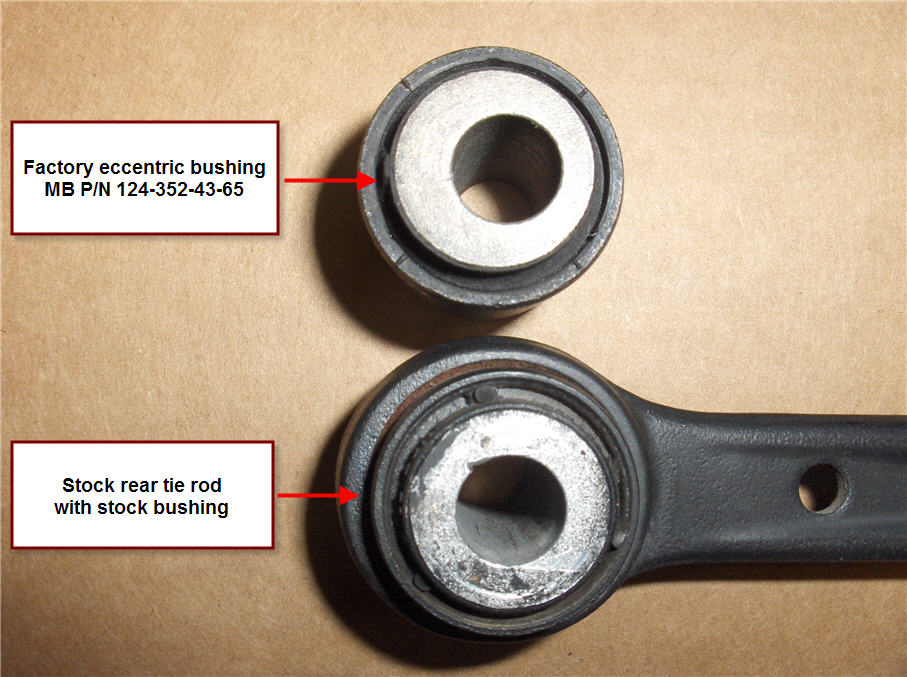

The rear tie rod eccentrics are bushings... you'll use the stock bolts. I'd install the new eccentric bushings into new tie rods (OE or Lemforder) assuming the existing tie rods are original... they rarely wear out, but while they're off the car anyway... kinda makes sense as preventive maintenance. Plus, that way you can "build" them on the workbench and just swap 'em out.
Good news - the price has dropped substantially from a few years ago. They are "only" $104 each MSRP now, had been $202 each in 2013...!! :spend:
A few more comments like IBNR's, and I will be able to buy another 500E with the equity in my camber plates! Anyone else care to praise so demand will go up? :)
Parts.com has the eccentric bushings on sale for $78, and the lowest-cost shipping I could find. I talked to my alignment guy and he said he wouldn't need them for the issue I'm currently having (apparently they were able to get rear toe in spec) but suggested it'd be a good idea to have a set of these things on my shelf for a future "just in case", so I went ahead and ordered a pair today. Car goes back in on Wednesday to try to finalize the alignment for good so wish me luck.
You can get them for less than parts.com, and with free shipping, from Lionel at MB Gainesville. If you need more information, just do a search for Lionel and you'll find his contact information.
