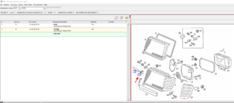

FYI, these lighting units are from a 4/5/6-cylinder 124 chassis (300E, etc)... not a 400E.

What's the difference between them and 400E?
Headlight housings used on the V8 models (400E/500E) have a vent connector that attaches to a short length of rubber hose. This is because the V8 models have the air intake surrounding the headlights, and if not vented outside the air intake bucket, moisture can get pushed inside the headlight assemblies. The V8 lights are vented through the short hose to the engine compartment, separated from the pressurized air intake enclosure.
The lights shown in the photos in post #1 do not have the connector for the hose, and the connector must be added prior to installation on the 034/036 chassis. The connector is NLA from Mercedes but I think a 3D printed copy is available somewhere.

Terry, yes, the hose adapter was sold separately by MB as shown in the EPC screenshot above... but the part is now NLA.

You can add the small hoses, that's relatively easy. For 1992-93 USA cars there's a rubber plug closing the hole in the plastic housing, you remove this first, then insert the hose from connector through the hole. See photo below on a 1992 model.
1994-95 USA cars (034/036) have this hose installed from the factory, and all years of Euro-spec 034/036 have it from the factory. It was only 92/93 North American spec with USA/DOT headlights that weren't pre-hosed.
