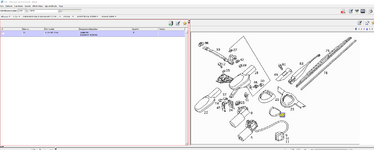

Hi everyone, i am looking for this clamp tgat goes on the gasket on the wiper mechanism, its a crimp clamp, anyone know where can i buy or what is the part number for it, most crimp clamps i found are wider than this one, this one i measured at 5mm width by around 40 mm long, thank you

P/N A1249800084... but possibly NLA. You'll need to call a dealership and ask about worldwide inventory. Only $4 MSRP if available.
thank you very much, i just checked and it seems that this part is no longer available, i will probably use a zipptie, very unfortunate that its so difficult to find a clamp oike this, my wiper motor burned amd also the plastic teeth just turned in to crumbles, and now im doing a full rebuild on my wiper assembly, didnt know the parts to rebuild the wiper are not so common to find

its called a CRIMP CLAMP or PINCH CLAMP, but the one from cv joint boot is to wide, i looked up on google and amazon and nothing, the closest thing i found its on mcmaster and ill see if it will work when i get it

called the dealership and MBclassic parts and not available, so i used 2 zipties because the longer zipties are to wide, so i used to smaller zipties put together and it worked perfectly fine
