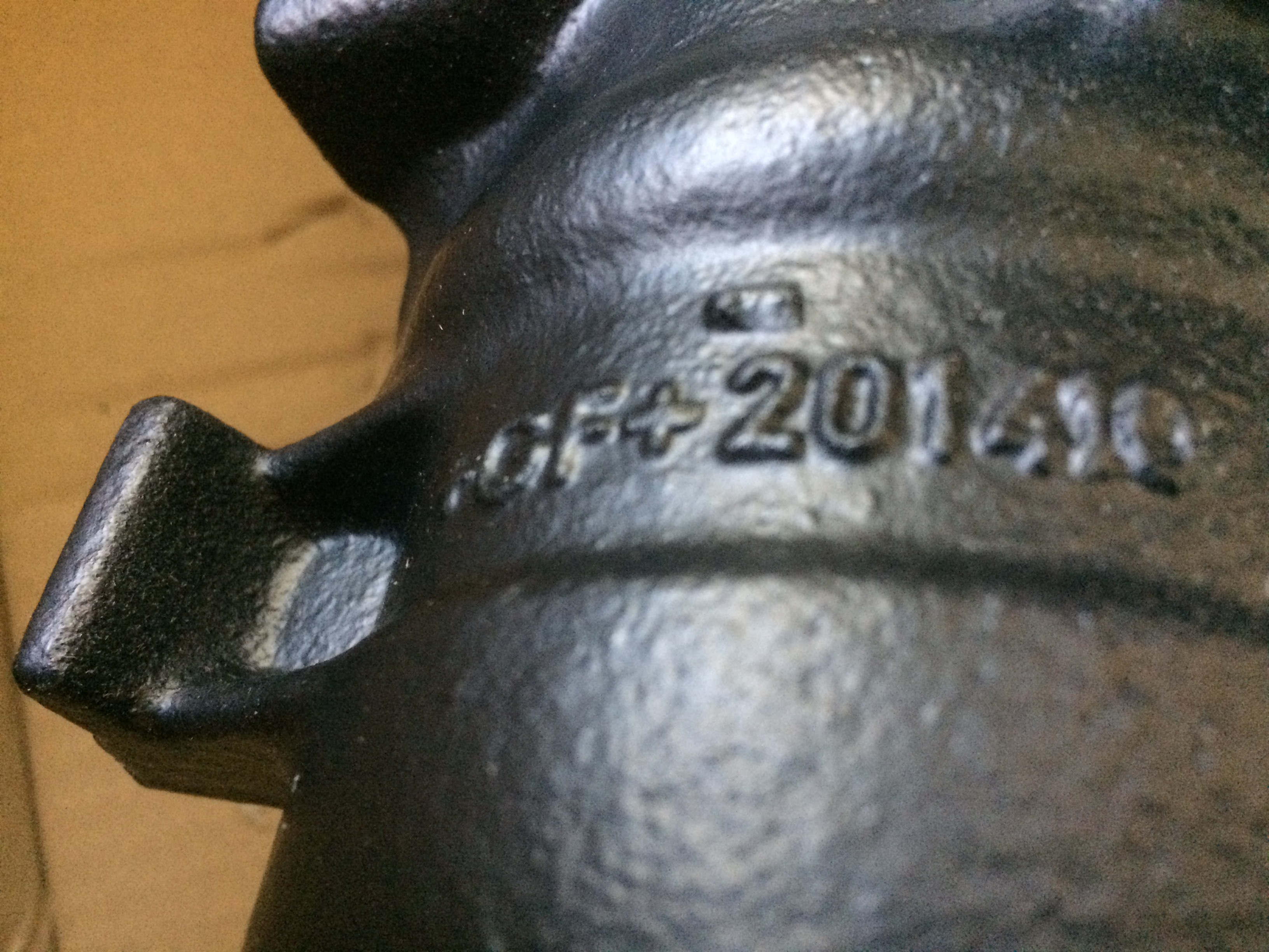

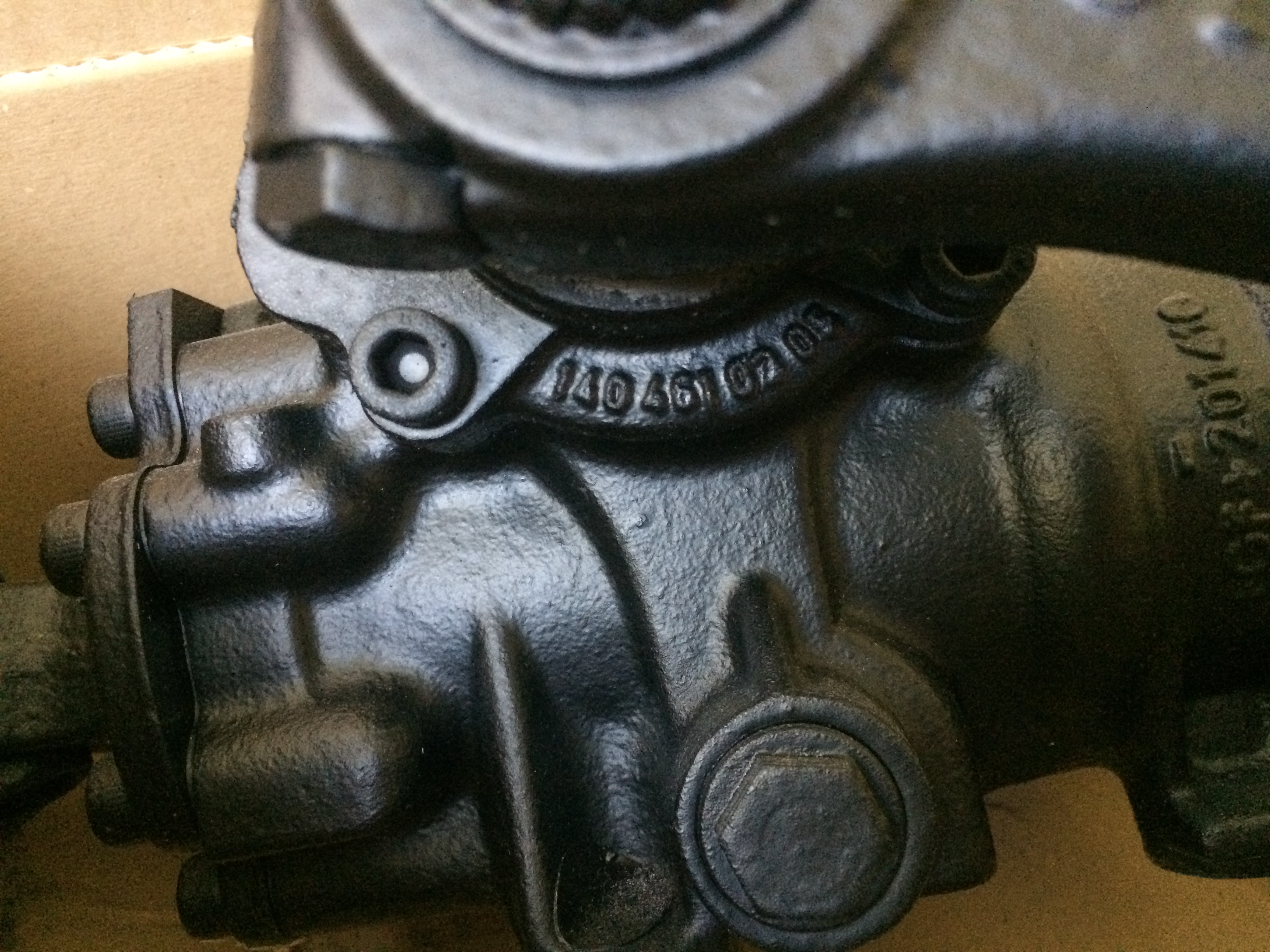

The 6-cyl sedan box specs are 3.1-3.4 turns standard, and 3.0-3.2 turns Sportline, which on paper is quite a bit of overlap. Note the reference is steering wheel rotations, which is NOT the same as comparing the box on the workbench, removed from the car.
On the workbench, out of the car, the 6-cyl boxes have a very obvious ~0.25 tuns less Sport vs Standard. I would expect the same on the V8 box... there should be SOME amount fewer turns for Sportline 034, it should not be identical to standard 034/036.
The Sportline box should also have a white stripe on the end Pitman arm. The boxes may have a stamped part number on the housing, but not all boxes have this, or some may be corroded enough that the original numbers are not readable. 124.034 Sportline box with stamped numbers shown below.
