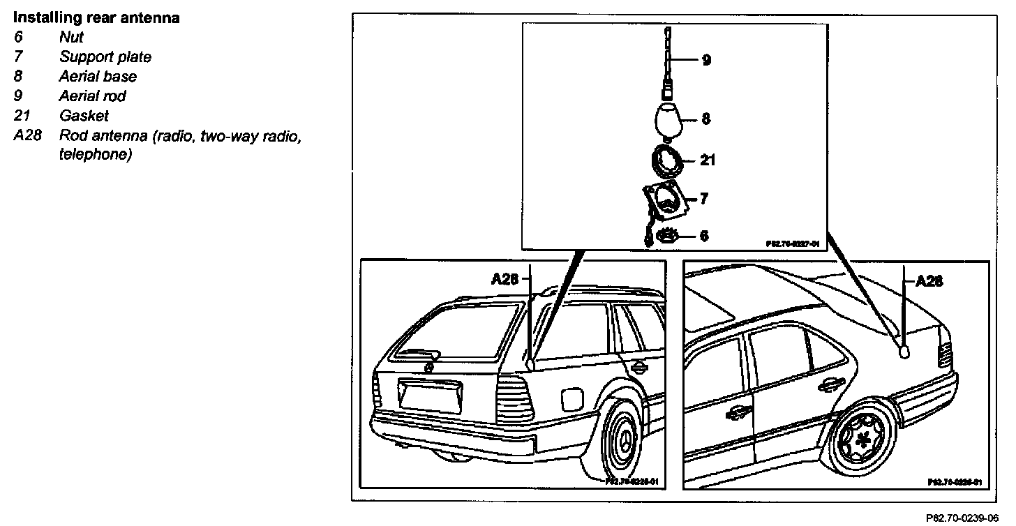

Installing Rear Antenna:

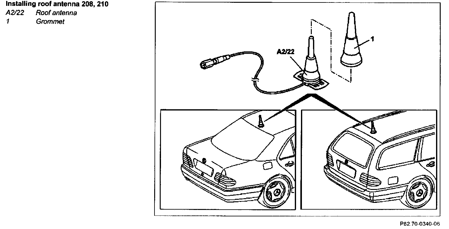

Installing Roof Antenna 208, 210:
Installing Rod Antenna:
1 Remove antenna rod (9)
2 Remove cover on left wheel house recess
3.1 Open side trim in right rear
3.2 Remove side trim in trunk
4 Disconnect ground cable of support plate (7)
5 Remove tuner/amplifier (trunk) (A2/3)
6 Disconnect antenna cable and unscrew nut (6)
- On rear/rod antenna
7.1 Remove support plate (7) and antenna base (8)
- On rear antenna
7.2 Remove antenna base (8) inwards
8 Loosen roof trim at rear
9 Pull grommet (1) off roof antenna (A2/22)
NOTE: Installation note: E3 Install grommet (1) using special tool
"Special Tool - Assembly Tool II" given below.
10 Unlock roof antenna with special tool and remove downwards.
See "Special Tools- Assembly Tool I" given below.
11 Install in reverse order
