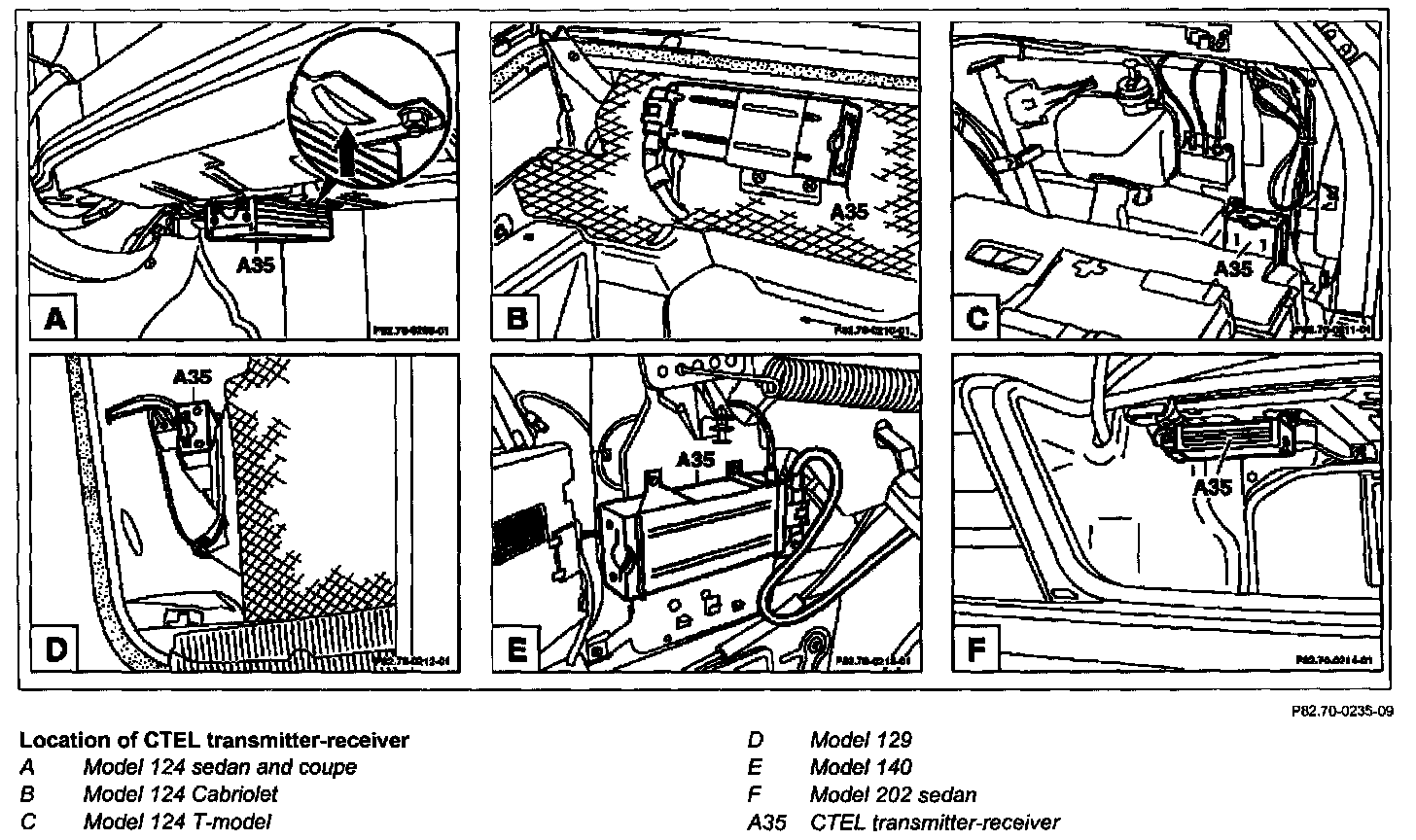

Location Of CTEL Transmitter-receiver:

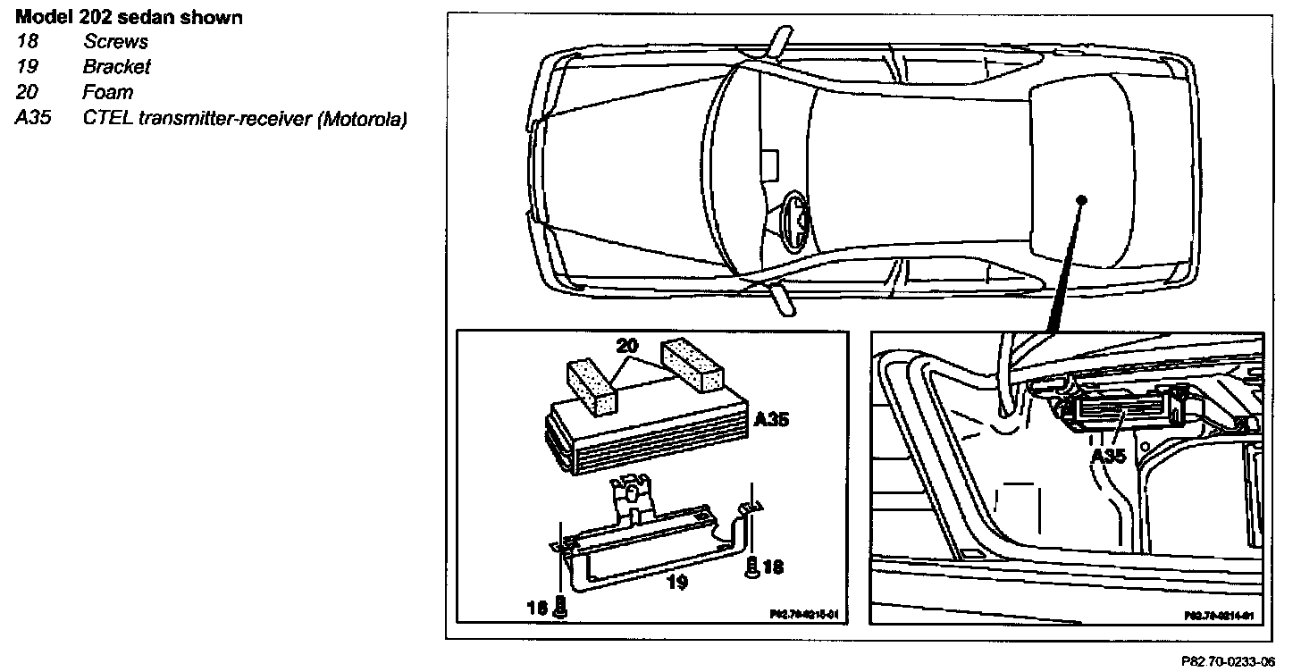

Model 202 Sedan Shown:

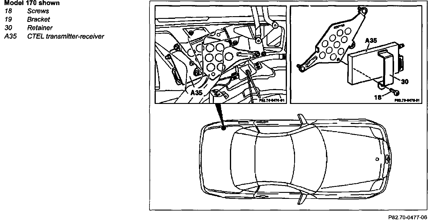

Model 170 Shown:

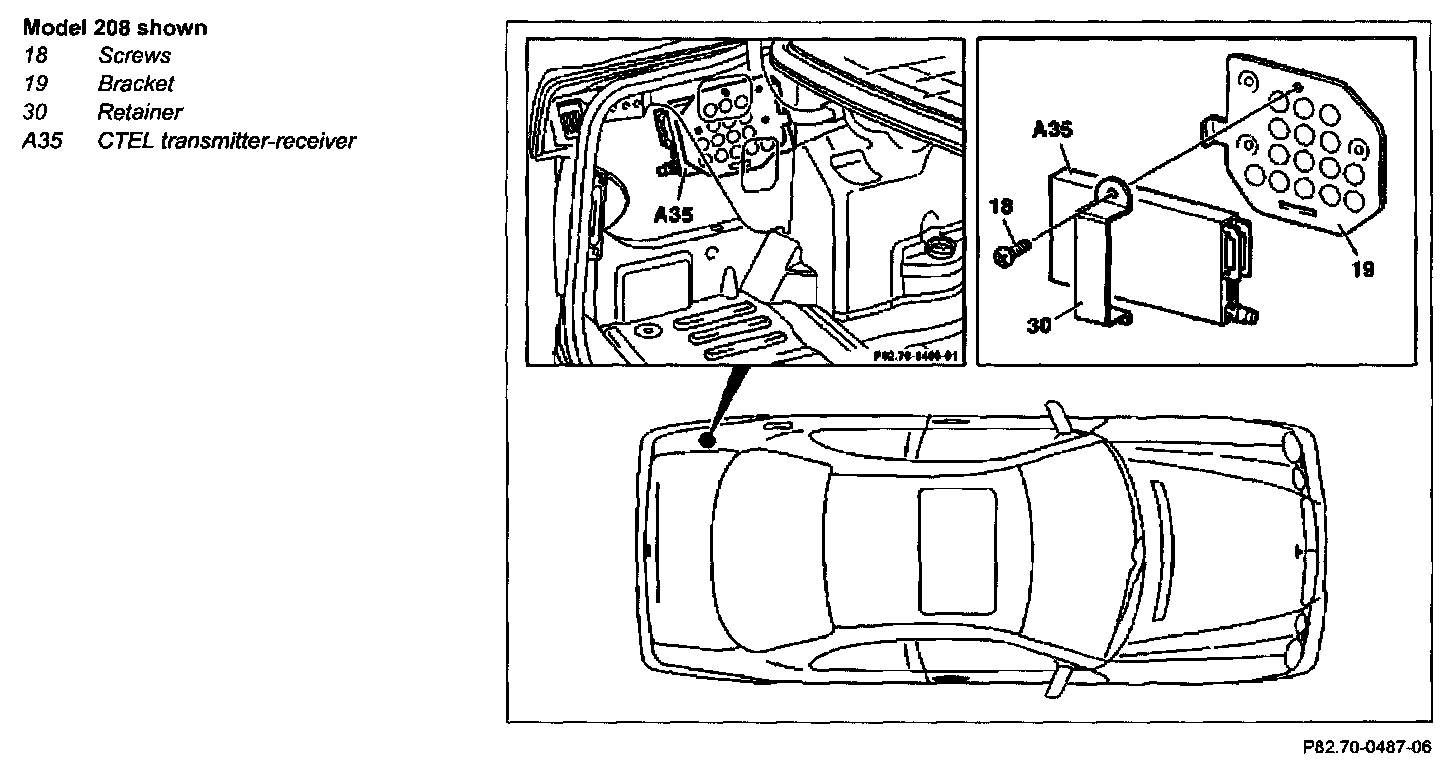

Model 208 Shown:

5 Remove cover on CTEL transmitter-receiver (A35)
6 Press back tensioning spring (arrow) on bracket and pull out CTEL transmitter-receiver (A35)
7 Unscrew screws (18) and remove bracket (19) with CTEL transmitter-receiver (A35)
8 Unscrew screws (18) and remove retainer (30) with CTEL transmitter-receiver (A35)
