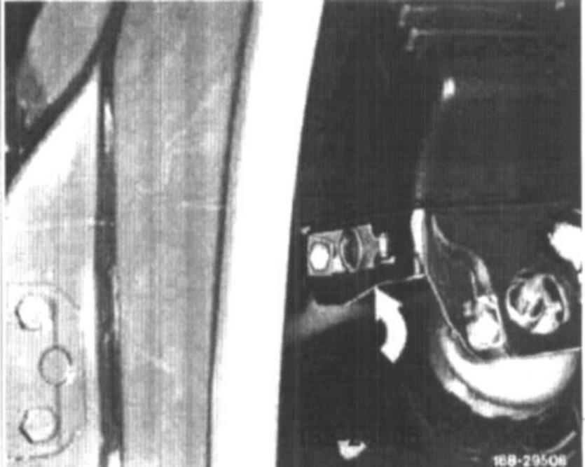

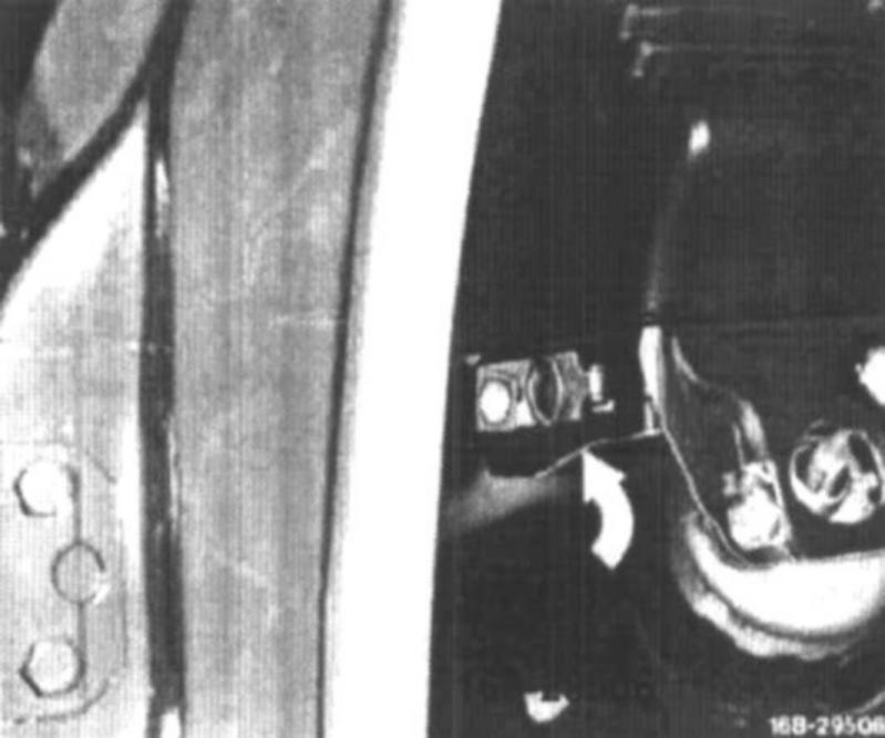

6. Unscrew nut on driver's side outside

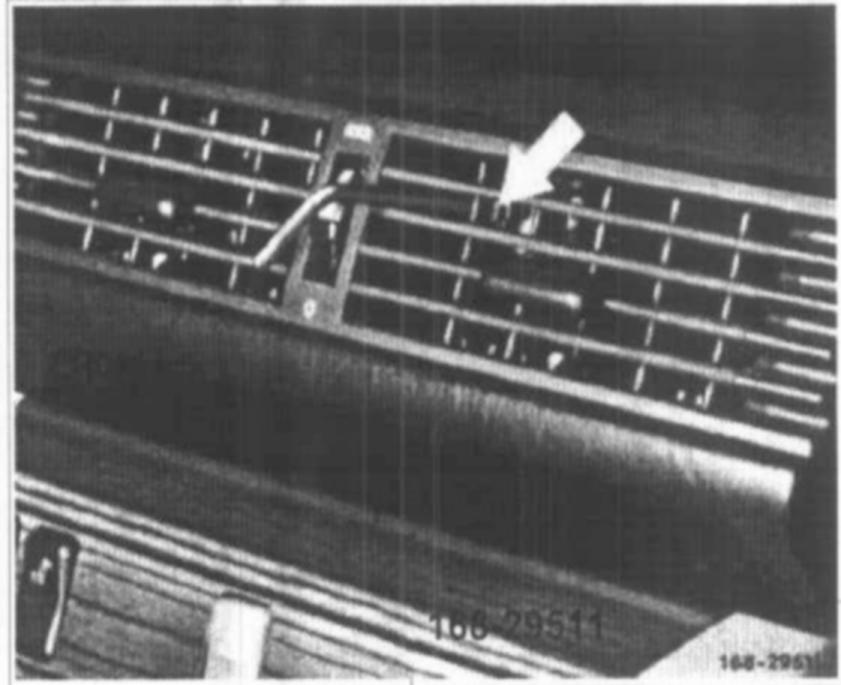

8. Pull out air nozzle on driver's side outside

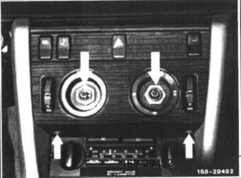

11. Pull off operating switch for blower and air distribution, unscrew nuts (24 mm) and screws.

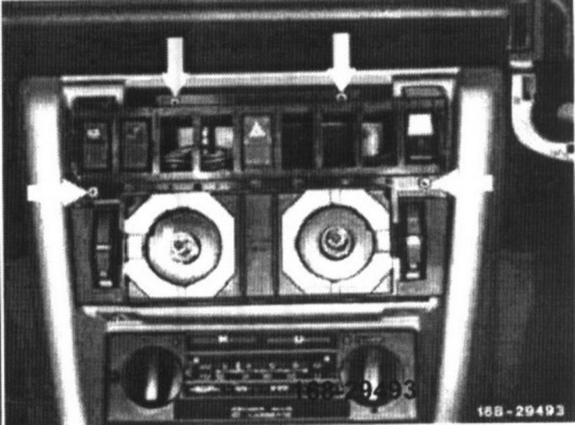

12. Remove molding.
13. Unscrew screws, pull off electric plug connections and remove plate.
