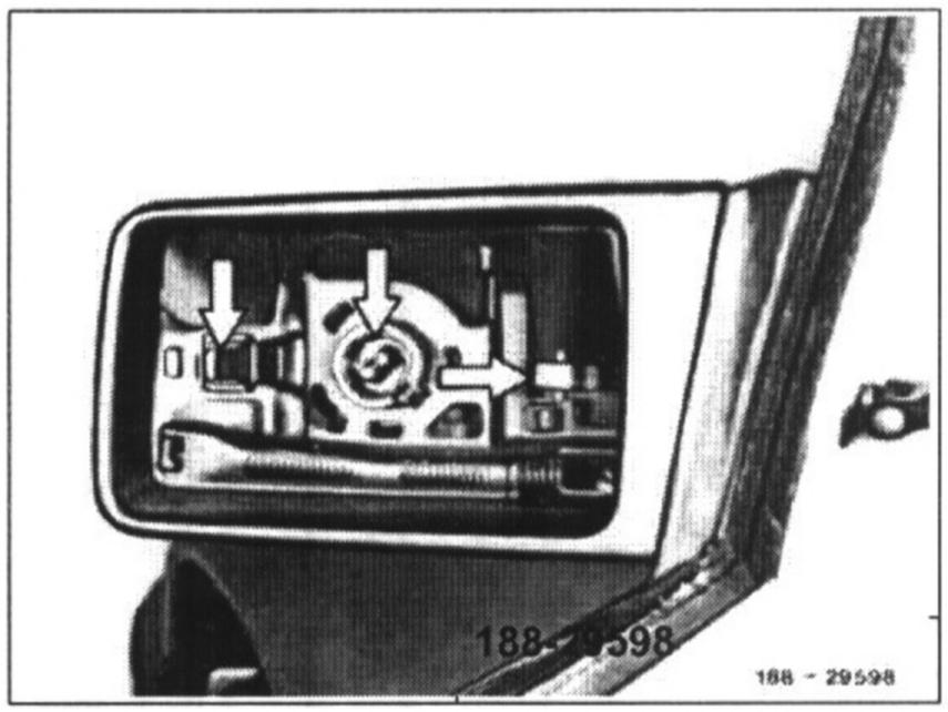

Removal and installation of outside mirrorNote: If the outside rear view mirror is continually moving out of adjustment, tighten screw on adjusting mechanism accordingly.
Note: Screw is under cover plate.
A. Mirror glass
Removal, installation
1. Force out mirror glass with plastic wedge and remove to the side.
2. Position mirror glass against adjusting lever and force into mounting points.
B. Complete outside mirror
1. Push plastic lock with screwdriver out of grip and remove grip.
2. Unclip cover plate at top out of door frame and pull out of door trim in upward direction.
3. Remove screws and take off mirror.
4. For installation proceed in reverse order.
