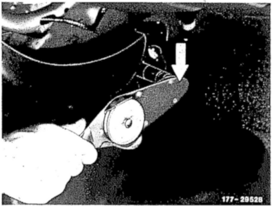

Adjustment
1 Open cover above emergency crank drive.
2 Pull off plastic cap for emergency crank drive and screw hex nut underneath tighter to increase torque, and slacken to release torque.
NOTE: Hold the shaft of the gear unit by means of an open-end wrench (6 mm) at the place provided for this purpose to make sure that the shaft will not rotate at the same time.
3 Turn hex nut max. by 60°, then push on plastic cap and check torque, readjust if required.
Attention
Make sure that slip clutch is not locked.
4 Close opening above emergency crank drive.
