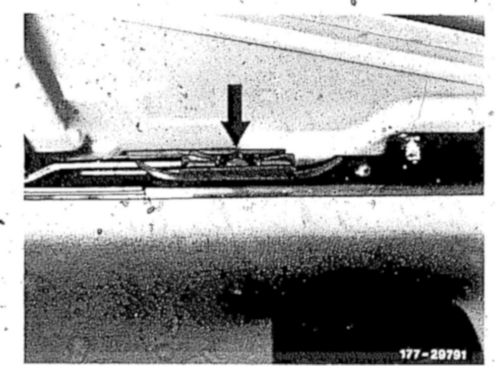

1 Unclip sun roof headlining at front with sun roof 3/4 open (4 clips).
2 Completely open sun roof.
3 Pull out sun roof headlining in forward, upward direction.
4 Check upper halves of clips on sun roof headlining.
5 Check lower halves of clips on sun roof.
Installation
6 Close sun roof and set both sliding parts horizontally.
7 Completely open sun roof.
8 Slip in sun roof headlining from front top until clips are abutting against sun roof, at the same time introducing tube into protective tube on sun roof headlining.
9 Close sun roof by half and fasten sun roof headlining at front audibly with clips (4 clips).
