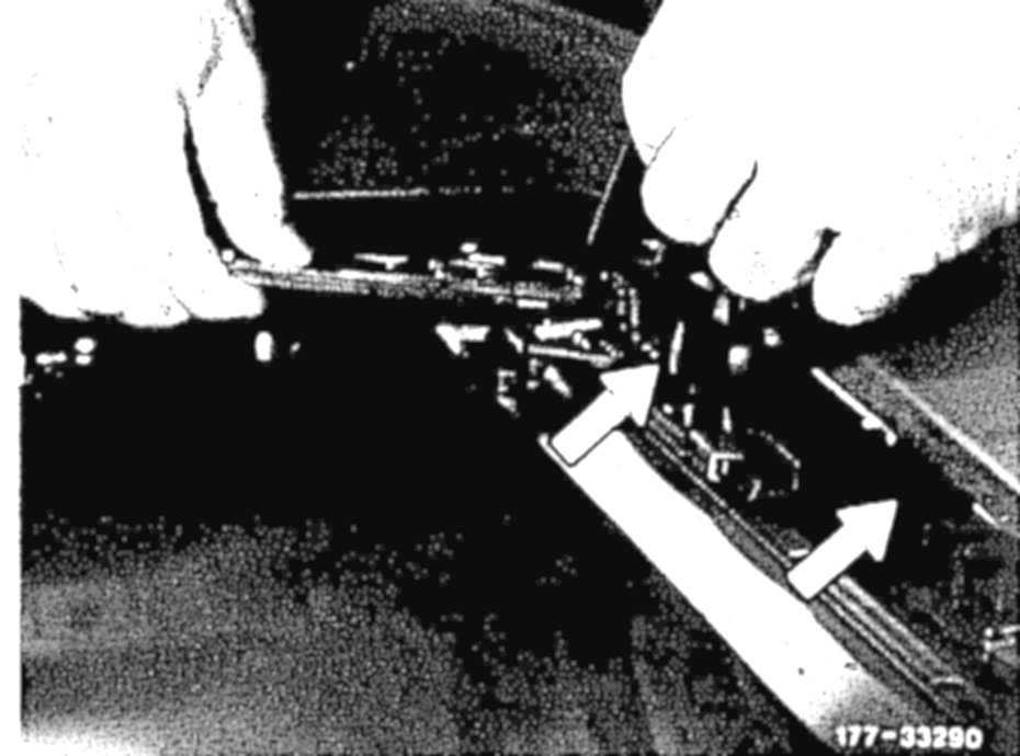

4 Unscrew sliding carrier and remove.
5 Slide angular lifting arm up to stop in forward direction, tilt upwards and remove at an angle in inward direction.

6 Grease angular lifting arm prior to installation with MB lubricating paste, part no. 001 989 14 51, on sliding shoes and on moving parts.
NOTE: During installation, pay attention to correct seating of sliding shoes (arrows).
