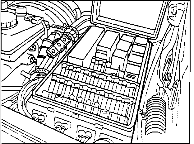

Fuse and Relay Block Identification and Location
The fuse/relay box is located in the left side of the engine compartment.

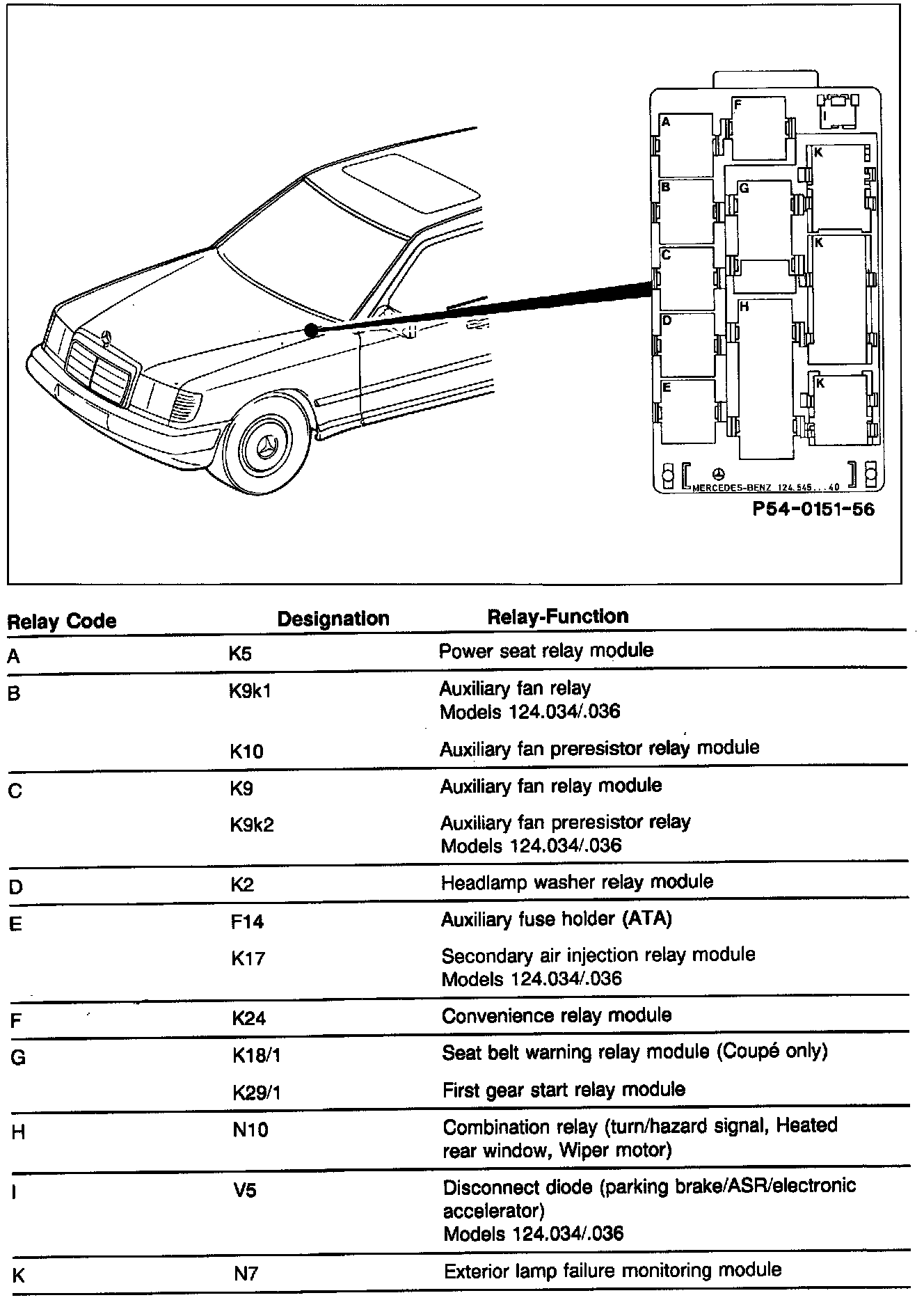

Relay and Control Unit Locations:

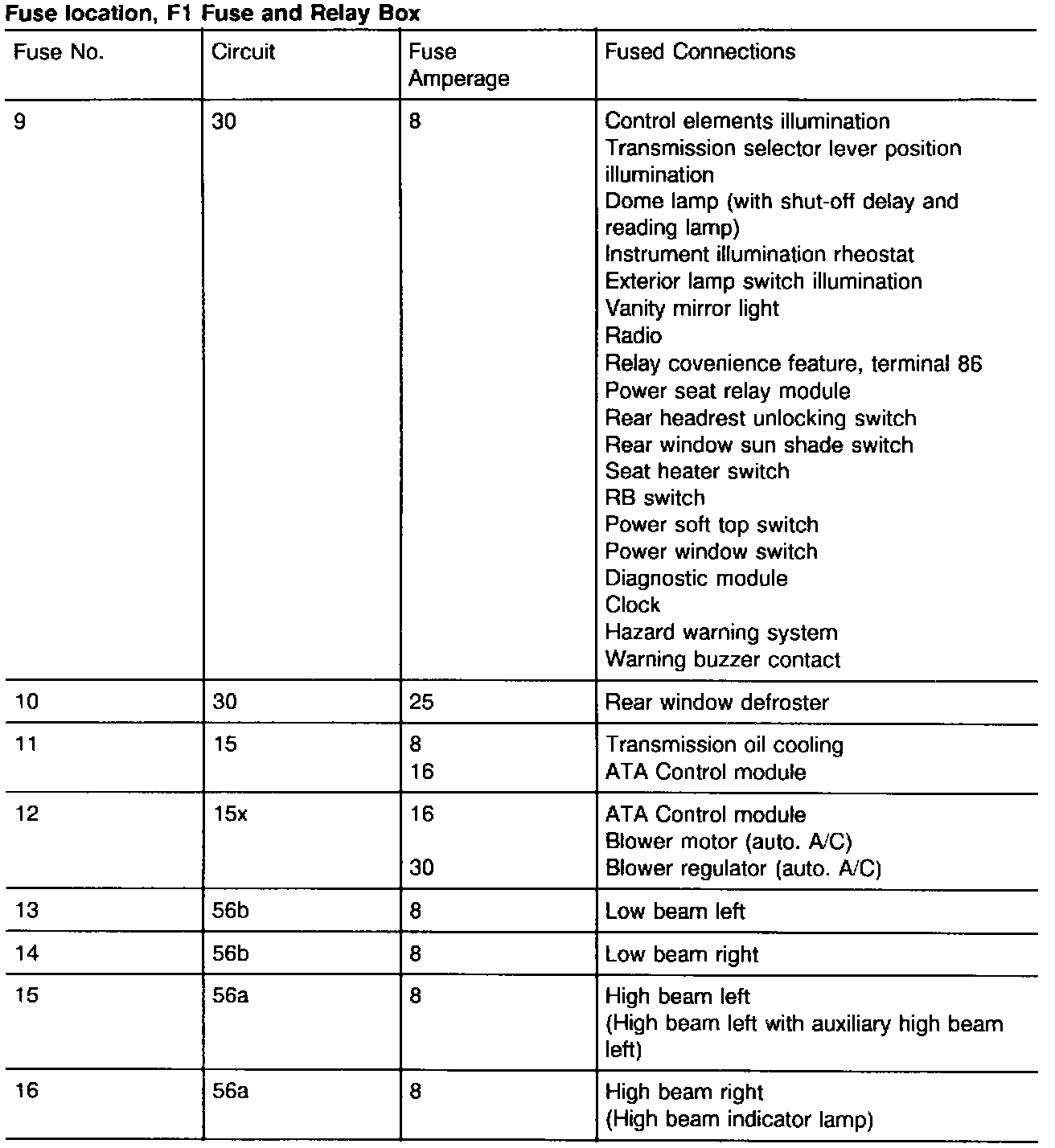

Fuse Box and Fuse Location (Fuses 9 - 16):
