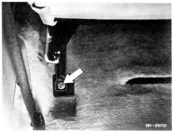

1 Slide driver's seat toward the rear and height adjusting device downwards.
2 Force off front cover with plastic wedge and unscrew front screws from both seat guide rails.
3 Slide driver's seat forward and height adjustment in upward direction.
4 Remove screws at the rear on both seat guide rails.
5 Pull driver's seat forward out of sliding rail.
6 Remove driver's seat.
