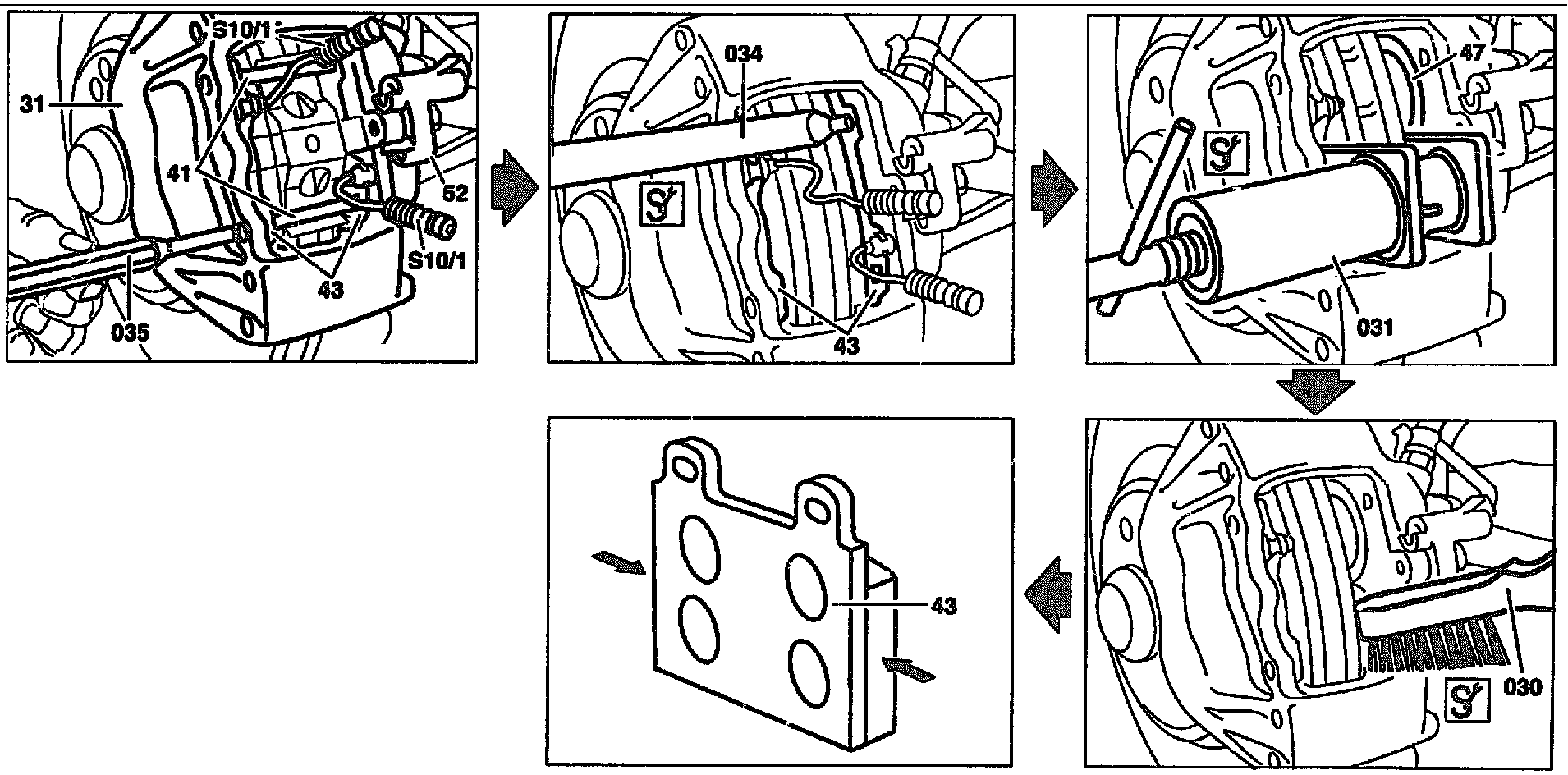

1. On fixed calipers with brake pad wear indicators, pull cable for contact sensor (S/10/1) out of plug connector (52) on fixed caliper. Pay attention to spring lining clip in models 124.031/034/051/091.
2. Knock out retaining pins with punch (35) and remove spring lining clip. When reinstalling, position spring lining clip, then drive in retaining pins, with aid of punch, up to the stop.
3. Push pads back slightly and remove brake pads using special removal lever tool (34) 123 589 13 33 00 or equivalent and pull contact sensor out of the backing plate of inside pad (43).
4. Clean brake pad guide with special brake caliper brush tool No. 000 589 26 68 00, or equivalent.
5. Evacuate some brake fluid from reservoir to prevent overflowing and force back piston with resetting special tool (31) 000 589 52 43 00, or equivalent.
NOTE: On four piston Calipers, press one opposing pair with the resetting tool and to prevent the other pistons from falling out use plastic wedges 601 589 05 19 00.

8. Coat side contact surfaces lightly, without circumferential damping, of brake pad lining backplate with brake pad paste 0019891051 before installation.
43 Brake Pad
a Circumferential Damping
b Grease Packing
c Stainless Steel Plate
Install brake pads with circumferential damping dry.
