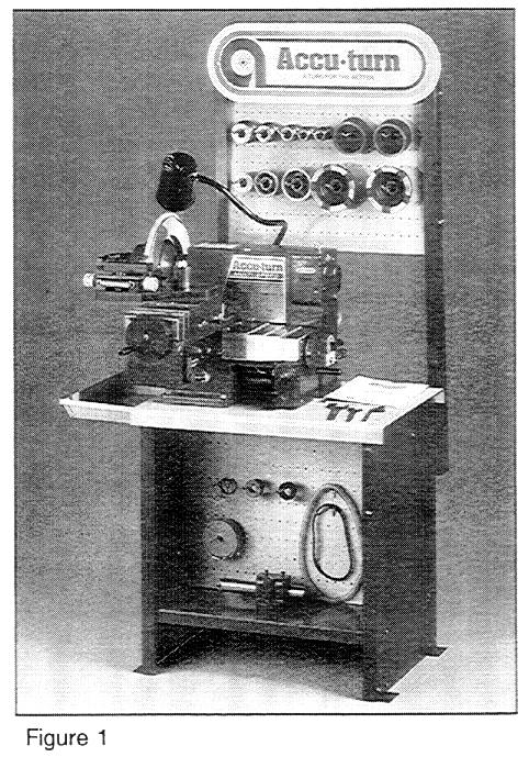

MBNA has tested and approved the use of the Accu Industries, Inc. Model 8944 Multi-Speed Combination Brake Lathe (Figure 1). Accu Industries' one-cut finish design allows the resurfacing of brake discs in one pass, making this a simple, fast and efficient operation.
The superior performance is a by-product of the lathe design. Massive dove tail ways are adjustable for wear. The alloy spindle assembly runs on tapered roller bearings, also adjustable for wear. This lathe is capable of machining drums, rotors and flywheels. Utilizing 3 spindle speeds and infinitely variable feed speed, this lathe is capable of producing superior finishes on rotors and drums.
The MB MS 8993 Brake Shop includes:
^ # 8944 Multi-speed Brake Lathe
^ # 8939 Deluxe Bench with Background
^ # 434060 Disc Micrometer
^ # 434287 Drum wear Gauge
^ # 433796 Carbide Inserts (10 pk)
^ # 433798 11/16"Arbor
^ # 434206 Zero Angle Tool Holder
^ # 434296 Clip on Silencer
^ # 434470 Rotor Silencer
^ # 436057 Small Hole Adapter Set
^ # 436054 Lt/Med Truck Set
^ # 434295 Double Taper Radius Set
^ # 433179 Non-Directional Finisher
^ # 535616 Abrasive Discs (80 grit)

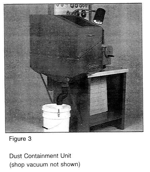

Also available is a Dust Containment Unit (Figure 3). This helps to keep the work area clean and free of metal chips and dust particles. The dust containment unit consists of a hinged-metal enclosure which mounts directly to the bench, shop vacuum and collection pail.
Part Number:
MB 436351 Dust Unit
MB 436365 Vacuum System
