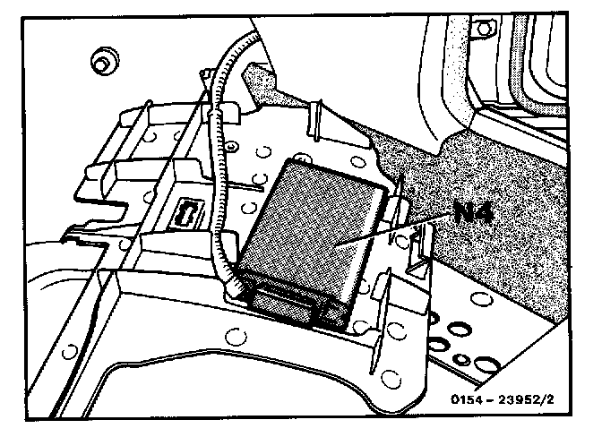

Control unit (amplifier)
The control unit (amplifier) (N4) compares the actual and the desired speed. In the event of a deviation from the desired speed, the control unit (amplifier) (N4) transmits the pertinent control signals to the actuator (M16) until the actual and the desired speed are again in agreement.

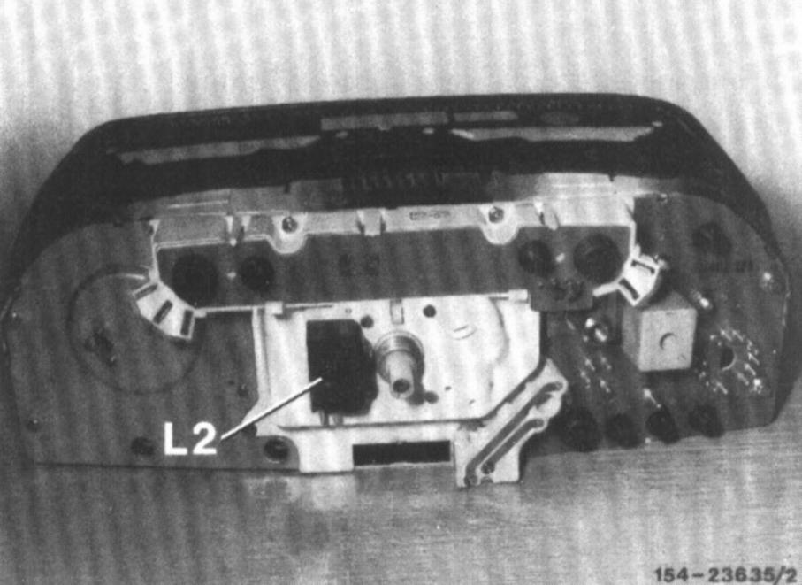

Transmitter
The control unit (amplifier) receives the actual speed signals from transmitter (L2) on speedometer.

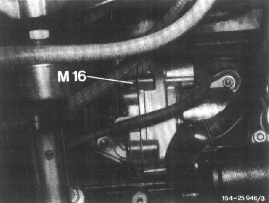

Actuator
The actuator (M16) receives its control signals from control unit (amplifier) and actuates the regulating linkage by way of a connecting rod. The actuator comprises an electric motor with gear unit, a one- way clutch, a potentiometer and an electromagnetic clutch.
The electric motor drives the output shaft provided with a one-way clutch by way of the gear unit
The one-way clutch permits, e.g. with the speed set, acceleration with accelerator pedal for passing other vehicles without a need for actuating the cruise control/Tempomat.
The potentiometer reports the position of the output shaft to the control unit/amplifier.
The electromagnetic clutch establishes the power flow between the electric motor and driven axle by engaging a gearwheel. It is engaged at the following switch positions. accel - set, decel - set and resume. The electromagnetic clutch is switched off by actuation of brake or clutch, but also when the system is switched off by means of pushbutton switch and when the regulating linkage has attained the idle speed position. When the electromagnetic clutch is switched off, the power flow is immediately interrupted by a return spring, which pulls a gearwheel out of mesh.

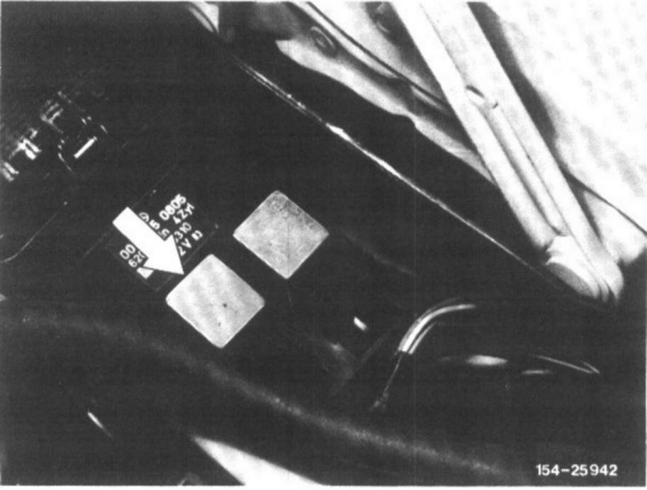

Relay on model 201.024 (standard version)
During operation of cruise control/Tempomat the relay will make the decel shutoff inoperational. The relay is painted yellow on surface for identification.
