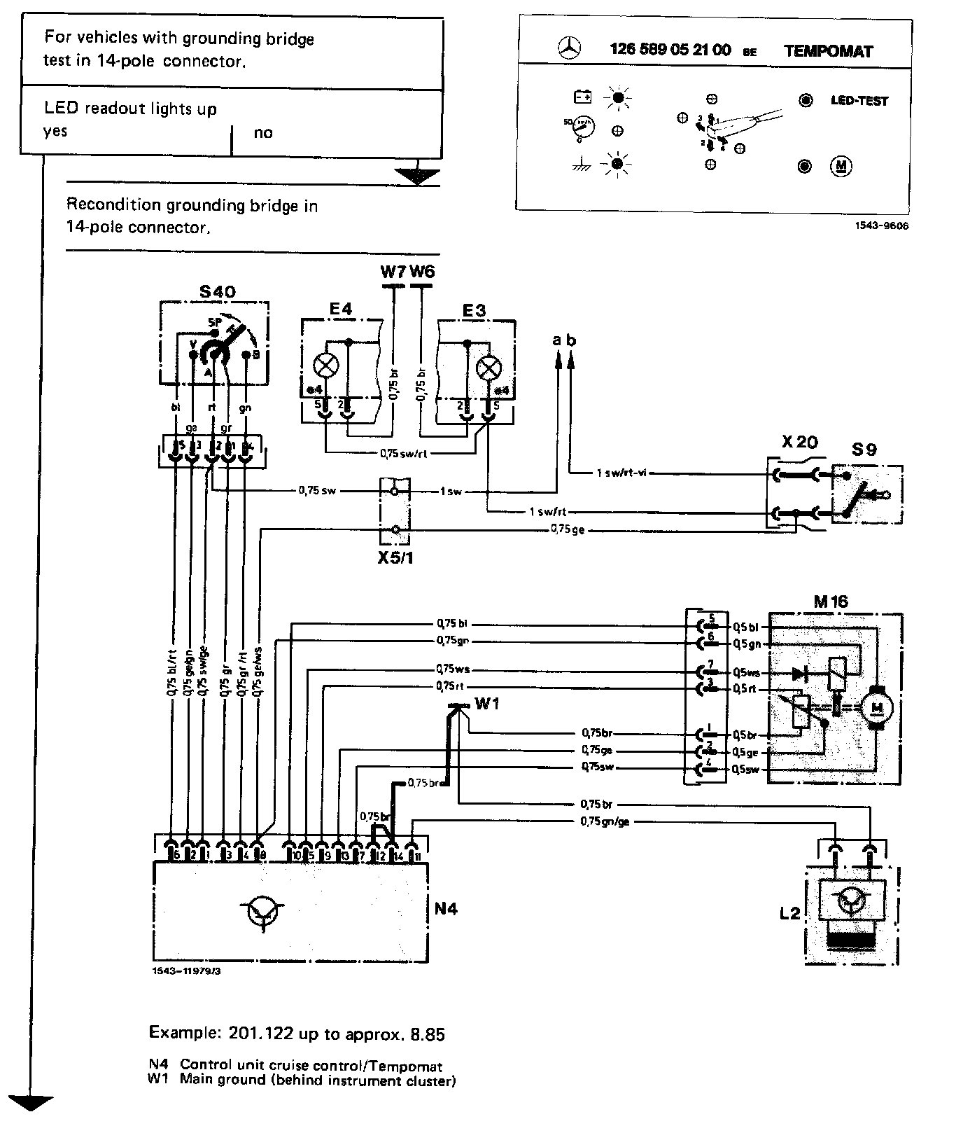

1 Expose control unit (amplifier).
2 Pull 14-point plug from control unit (amplifier).
3 Connect test adapter to 14-pole plug.
4 Switch on ignition. LED-readout of symbols for battery, km/h and ground will light up, provided no fault is indicated.
5 Push "LED-TEST" push-button of test adapter and check whether all LED readouts are lighting up. If no LED readout is lighting up check connection of voltage supply and line-up of 14-pole coupler.
