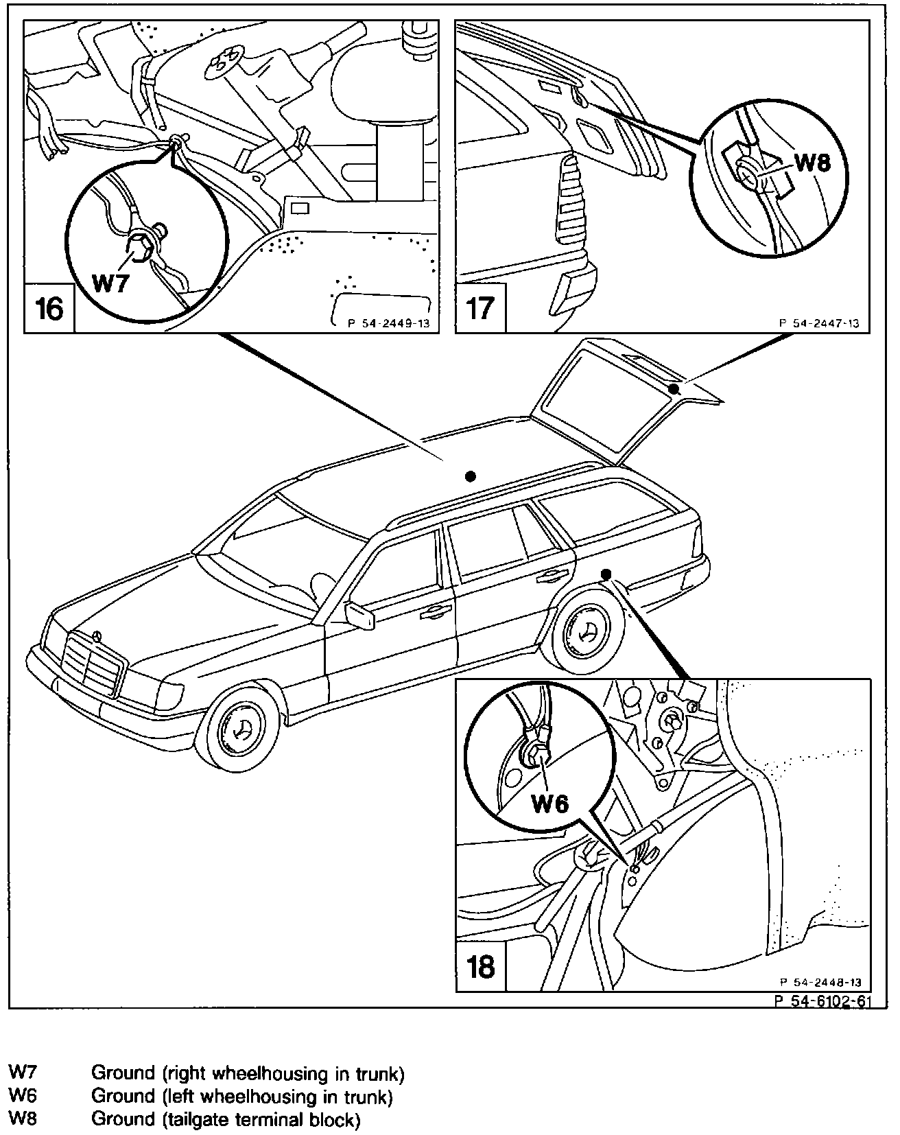

W6 Ground (left wheelhousing in trunk)
Sedan/Coupe/Cabriolet
Station wagon
W7 Ground (right wheelhousing in trunk)
Station wagon
W8 Ground (tailgate terminal block)

Ground Locations (Figure 16 To 18):
