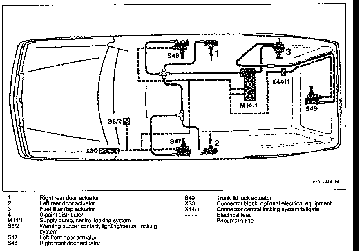

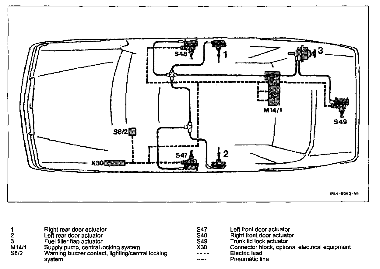

System Diagram
A. Sedan1st Version - Up To Approx. 08/90:
2nd Version - From Approx. 09/90:

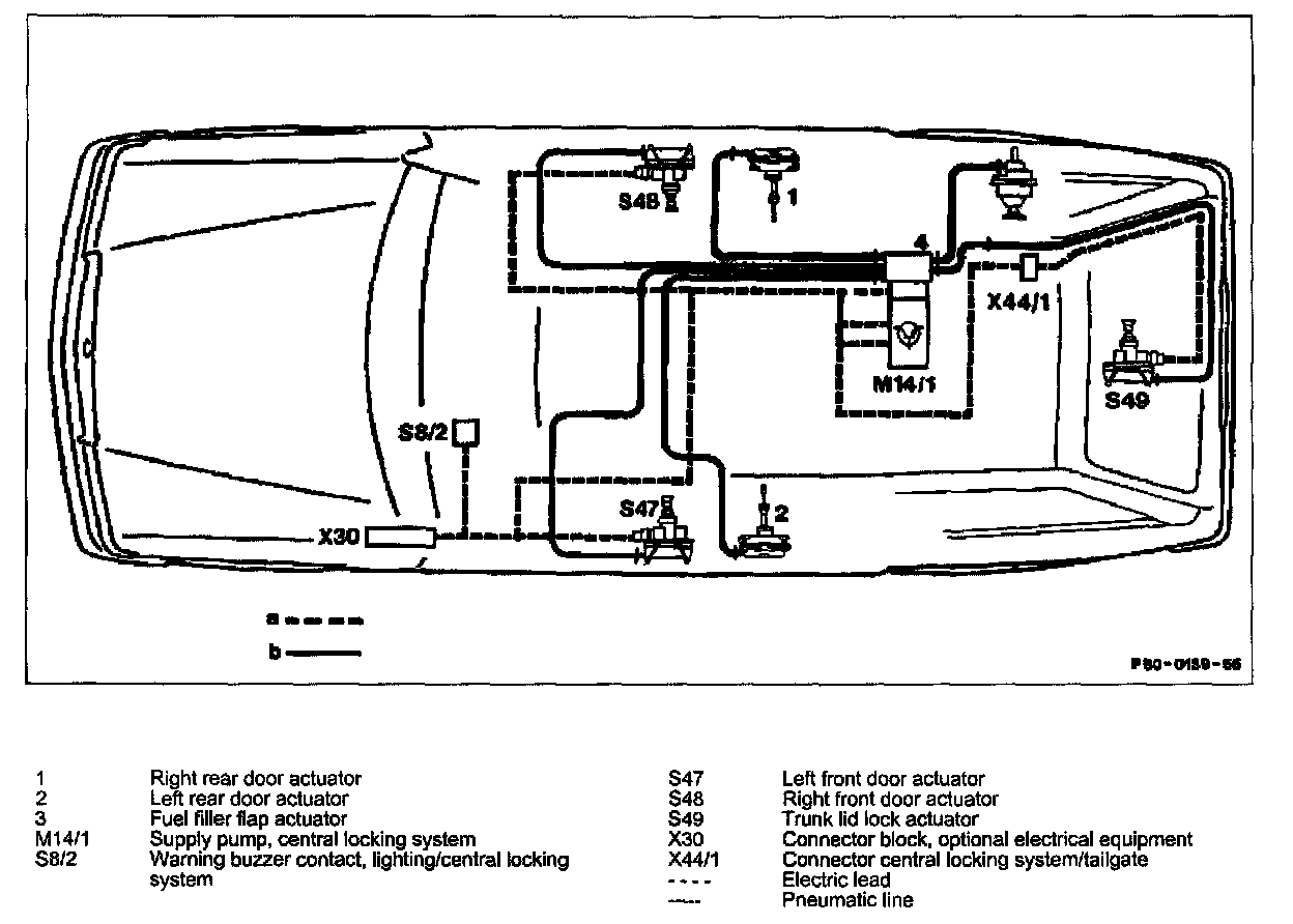

B. T-models
1st Version - Up To Approx. 01/86:
2nd Version - From Approx. 02/86 To Approx. 08/90:
3rd Version - As Of Approx. 09/90:

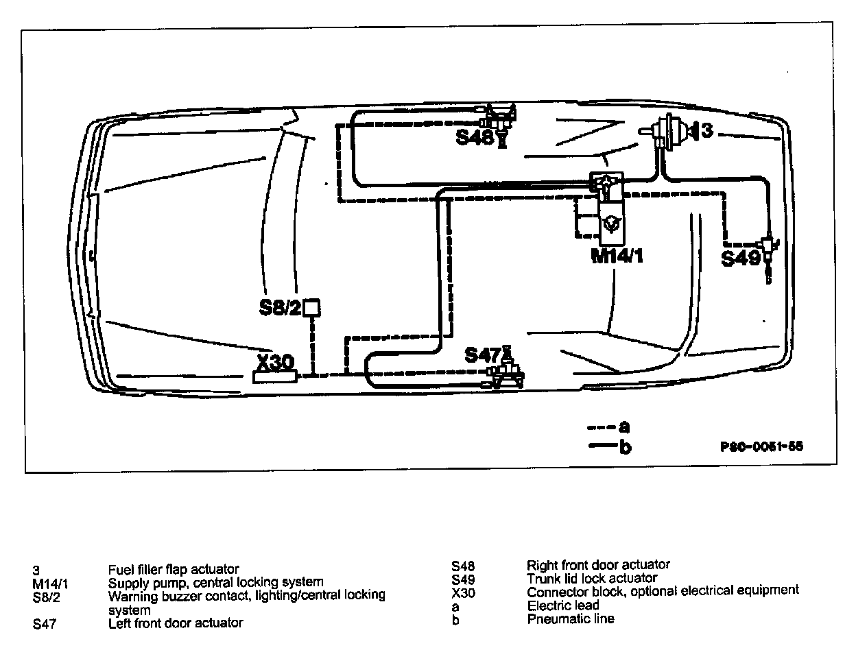

C. Coupes
2nd Version - As Of Approx. 09/90, Cabriolet As Of Start Of Prod.:
