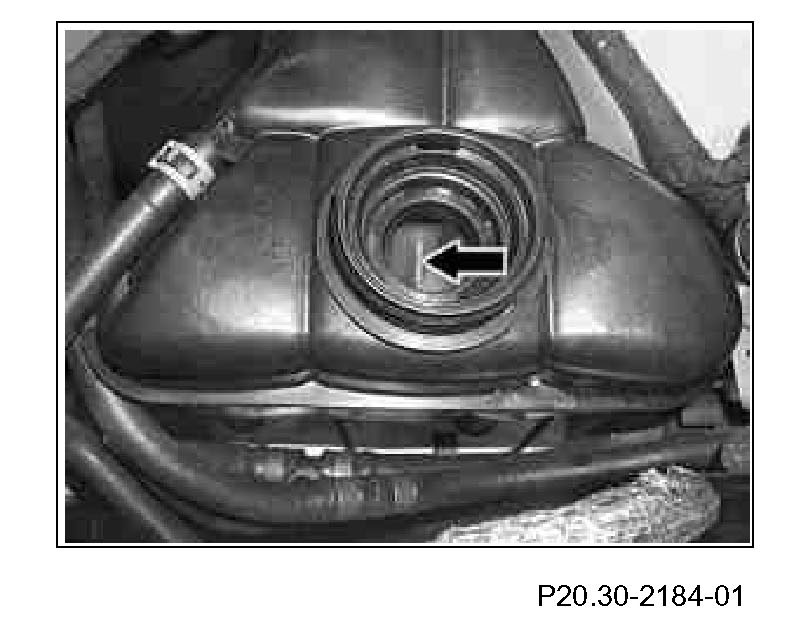

Coolant expansion tank cold level mark:
Model 171 with engine 271, 272
When the engine is cold, the engine coolant level must reach up to the marking "Min" on the coolant expansion reservoir (arrow).
When coolant is warm: approx. 1 cm above this scribe mark.

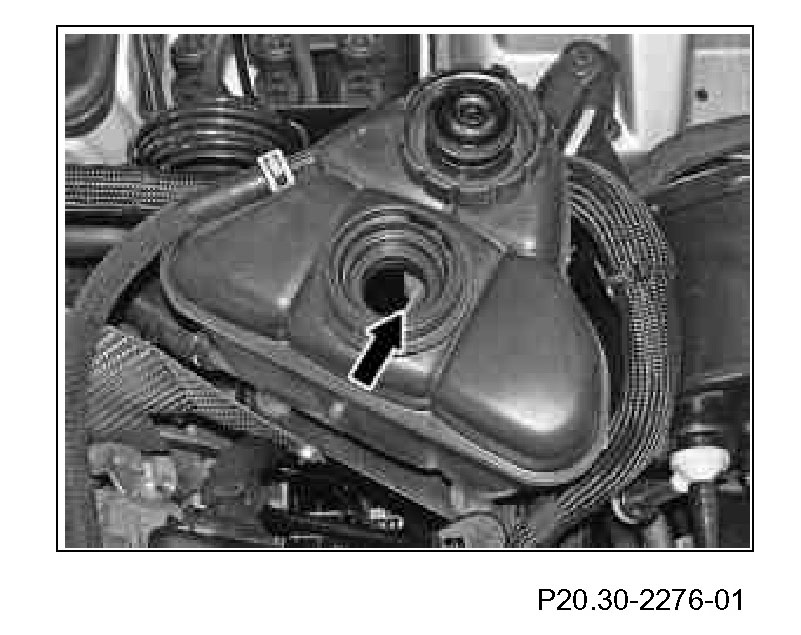

Model 220 with engine 112
Model 215, 220 with engine 113, 137
Model 215, 220 with engine 275, main circuit
Model 461, 463 with engine 612
Model 463 with engine 112, 113, 273, 628, 642
When engine is cold, the engine coolant level must reach up to the marking (arrow) on the coolant expansion reservoir.

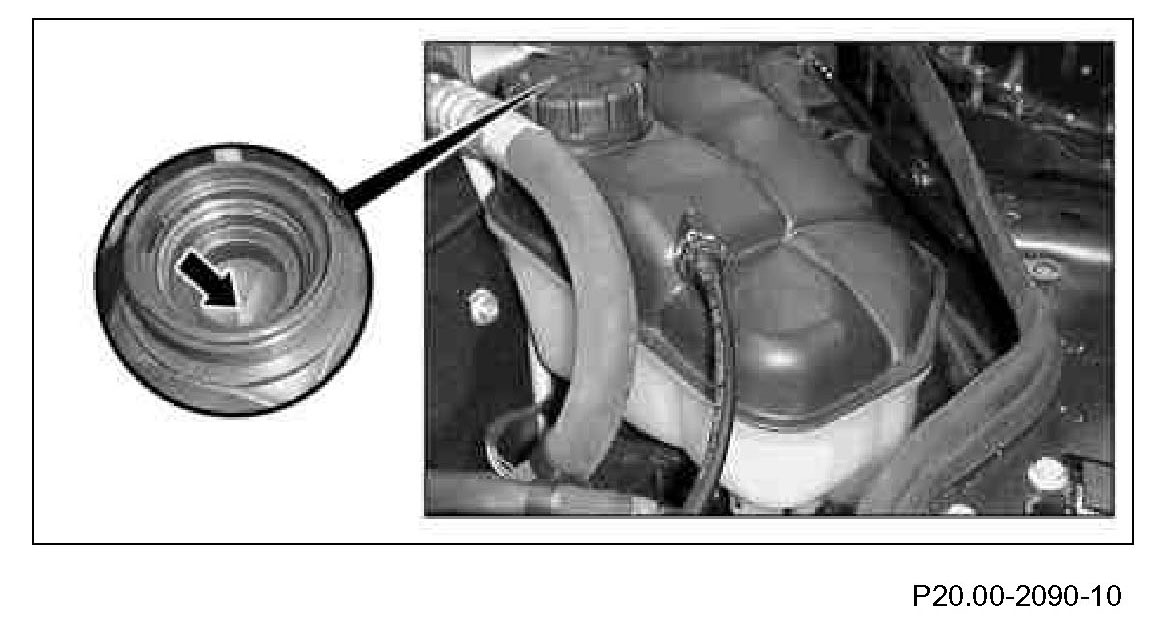

Model 461 with engine 642
When the engine is cold, the coolant level must reach up to the marking (arrow) on the coolant expansion reservoir.
When the coolant is warm, about 1 cm above the marking (arrow).

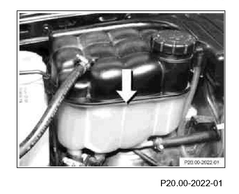

Model 210 with engine 112, 113
Model 202, 208 with engine 112, 113

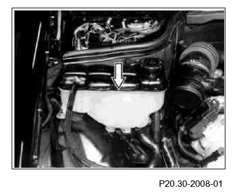

Model 129 with engine 112, 113
Model 230 with engine 112, 113, 156, 272, 273
Model 230 with engine 275, main circuit

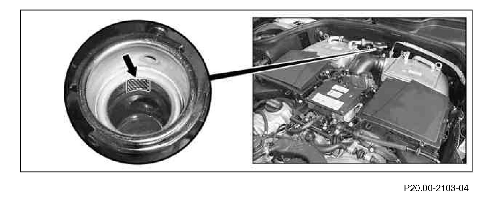

Model 215, 216 220 221 230 with engine 275, low temperature circuit
Model 240 with engine 285, low temperature circuit
The engine coolant level must be placed, when coolant is warm or cold, in the crosshatched illustrated area of filler neck.
