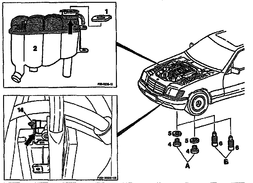

Model 140 Shown:
A. Drain plug, 1st version
B. Drain plug, 2nd version

- Except Model 210: turn filler cap (1) anticlockwise as far as 1st detent to release pressure,
- Model 210: turn 2-stage cap half a turn to release pressure.
WARNING: Cap (1) must not be opened unless coolant temperature is below 90°C. Risk of scalding.
- Remove cap (1) after pressure is relieved.
Draining Coolant At Radiator
- Fit hose (12 mm inner dia.) onto the connection (arrow).
- Open drain plug (14), close.
- Drain coolant into a suitable vessel (about 6 liters).
Draining Coolant At Crankcase
1st Version:
- Unscrew drain plugs (4) with seals (5) next to left and right engine carriers, screw on.
Tighten to: 30 Nm.
- Drain coolant into a suitable vessel (metal tray).
2nd Version:
- Slacken drain plug (6) (banjo bolt) next to left and right engine carriers.
Tighten to: 10 Nm.
Refer to NOTE at end of procedures.
- Fit hose (16 mm inner dia.) onto drain plug (6).
- Open drain plug (6) and drain coolant into a suitable vessel.

- Model 124: pour coolant in up to the marking on expansion reservoir (2).
- Models 129, 140: pour coolant in up to separation level between top part of expansion reservoir (black) and bottom part of reservoir (transparent).
NOTE:
- On Model 129: if expansion reservoir (2) does not have additional ventilation line, (refer to Coolant Overflow Reservoir) detach ventilation line at expansion reservoir (2), pour in coolant, fit on ventilation line and add coolant up to the brim (arrow).
- Model 210: pour coolant in up to marking (cast lug, visible when cap open) on bottom of expansion reservoir.
