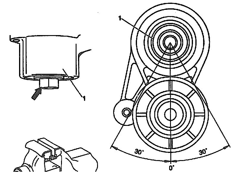

Tensioning device removed, refer to Service and Repair.
Overview
- Fix tensioning device (1) in place at flats (arrow) in a suitable vice.
- Turn tensioning device (1) about 30° to both sides.
NOTE: The tensioning device (1) must move back into its initial position after being turned.
