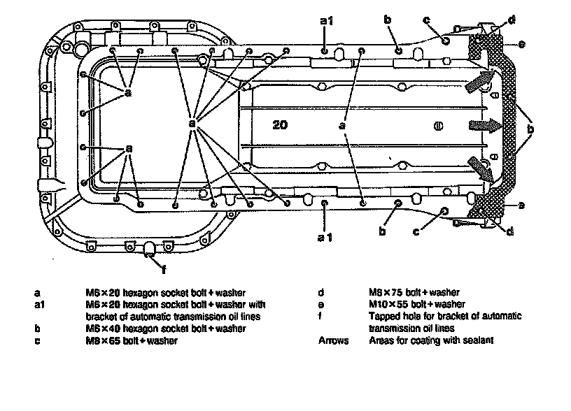

- Unscrew bolts (a), (a1), (b), (c), (d) and (e).
- Remove oil pan (20) to the front, rotate crankshaft if necessary so that pan (20) does not touch conrod and crankshafts.
- Clean sealing surfaces.
- Replace gasket (20a).
- Apply sealant 002 989 45 20 (Omnivisc) in rear area of oil pan and crankcase (arrows).
- Install oil pan (20), align to rear contact face on transmission.
CAUTION: If oil pan (20) is not aligned relative to the transmission, this may cause noises and vibration problems.
