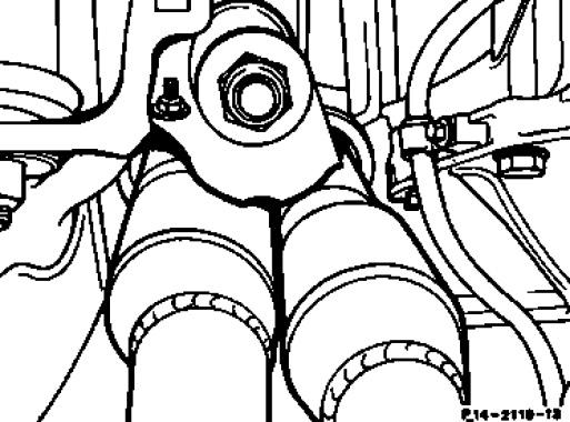

The 3-way catalytic converters are located in the exhaust system upstream of the mufflers.
The following versions are fitted:
^ Pre-catalytic converter in front exhaust pipes (depending on engine)
^ Underfloor catalytic converter at frame floor

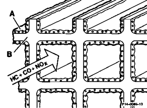

Pre-catalytic converter with metal monolith
A Intermediate layer (washcoat) with platinum (Pt) and rhodium (Rh)
B Ceramic monolith

The exhaust gases flow through the catalytic converter where they come into contact with the rare metals (Pt, Rh).
The following chemical reaction occurs:
As a result of oxidation, carbon monoxide (CO) is converted into carbon dioxide (CO2) and hydrocarbons (HC) into water (H2O), and by reduction, the oxides of nitrogen (NOx) are converted into nitrogen (N2). The decisive factors for a high conversion rate of the pollutants are the temperature and the exhaust residual content in the gas.

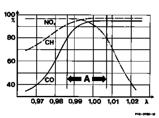

This fluctuation of the oxygen portion with exhaust gas is achieved with the oxygen sensor and the lambda closed-loop control (see appropriate sections). Only as a result of these oxygen fluctuations is it possible to chemically convert the three afore mentioned exhaust elements in the catalytic converter.
Voltage signals of oxygen sensor
A Rich fuel/air mixture
B Lean fuel/air mixture
The catalytic process, i. e. the chemical reaction, in the catalytic converter begins from approx. 250 °C. Excessively high temperatures cause a thermal overload.
Conversion rate of pollutants in catalytic converter

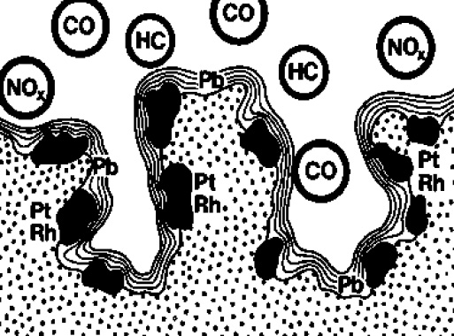

Only unleaded fuel should be used in vehicles fitted with a catalytic converter and oxygen sensor. Lead additives (Pb) in the fuel are deposited on the chemically reacting surface of the catalyst (Pt, Rh) and of the oxygen sensor, rendering the system ineffective.
