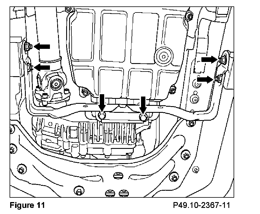

B3: Decoupling the Exhaust System
1. Unbolt the exhaust system bracket at the transmission end (arrows, Figure 11).
NOTE:
Do not unfasten the exhaust system mounts.
2. Unfasten rear cross strut (arrow, Figure 12) and unhook rubber exhaust mounts.
3. Replace installed exhaust mounts with rubber rings (arrow, Figure 13)
