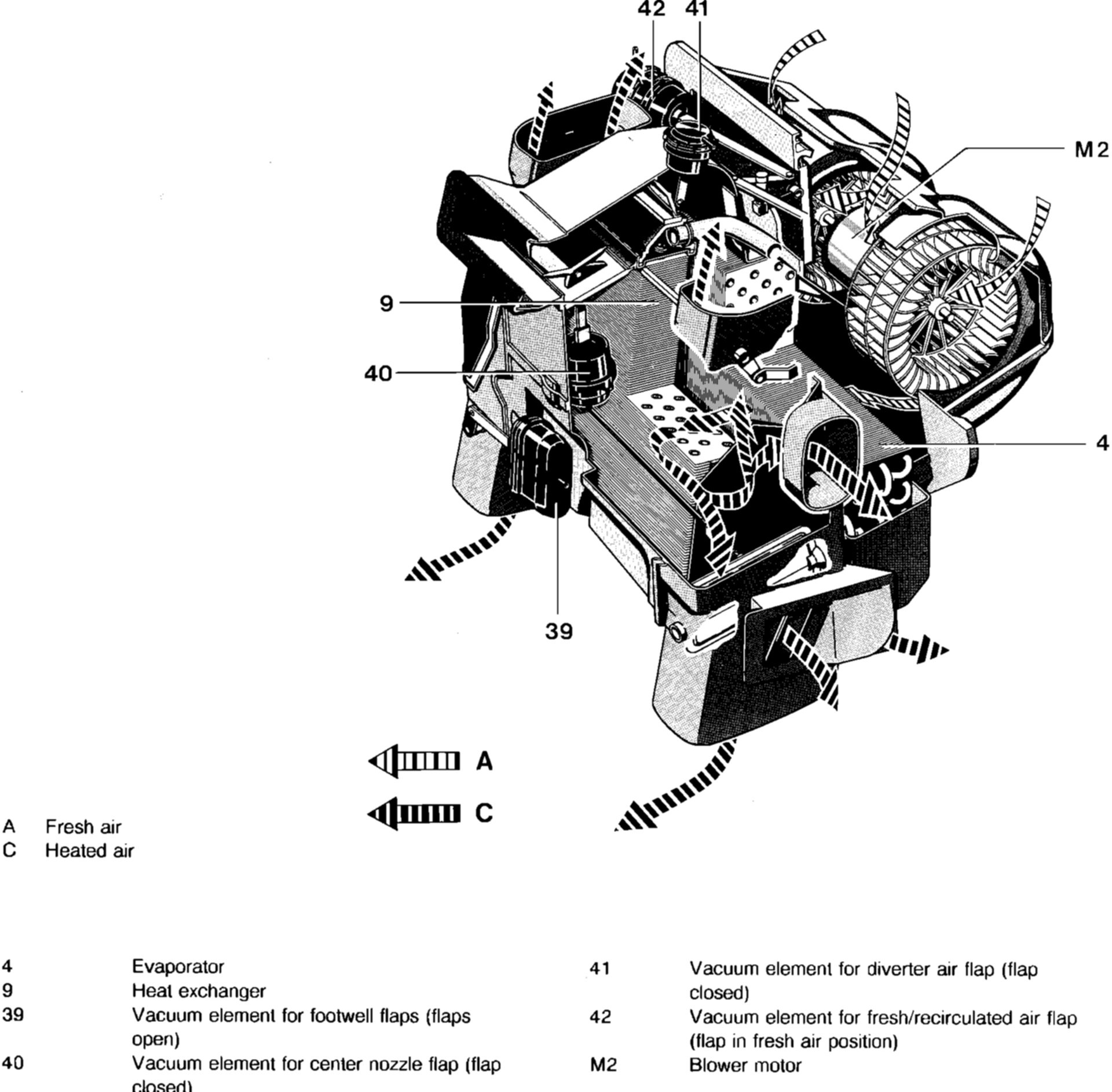

Heating And Fresh Air Flow:
If there is a temperature difference between the in-car sensor and the preset value indicated on the temp wheel (e.g. to cold by 10°F) during automatic control, the electronic control unit will adjust the frequency of the mono (heater) valve to allow more hot water through the heat exchanger. When the desired temperature is attained, the control unit, via resistance input from the interior temperature sensor and the heater temperature sensor, corrects the mono valve frequency for level temperature output.
If heating is not required, the mono valve is powered closed, and the diverter and recirculation flaps are positioned as needed by the ACC control unit. Additionally, the temperature of the evaporator is continuously compared against the desired temperature; the A/C compressor is switched "ON", if required.
