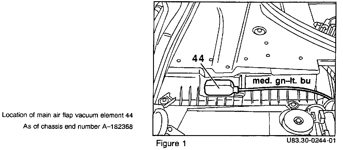

As of 01/94 production (VIN A-182368), the main air flap is actuated by a vacuum element (44) with one vacuum line connection (Figure 1).

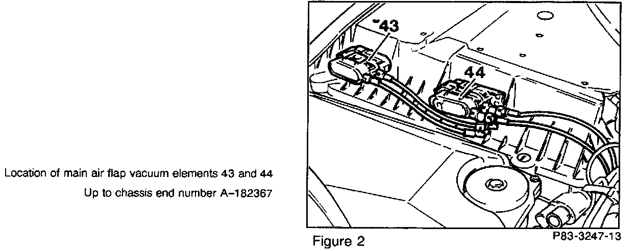

Vacuum element 43 was eliminated (Figure 2).

Only the modified version of the upper section of the heater box with one vacuum element (44) for the main air flap is stocked at the PDC.
When replacing the upper section of the heater box on vehicles produced prior to VIN 1A-182368, the dark red vacuum line is to be connected to vacuum element 44, and the previously used med. green/lt. blue vacuum line is to be plugged off. The switchover valve block (Y11) does not have to be replaced.

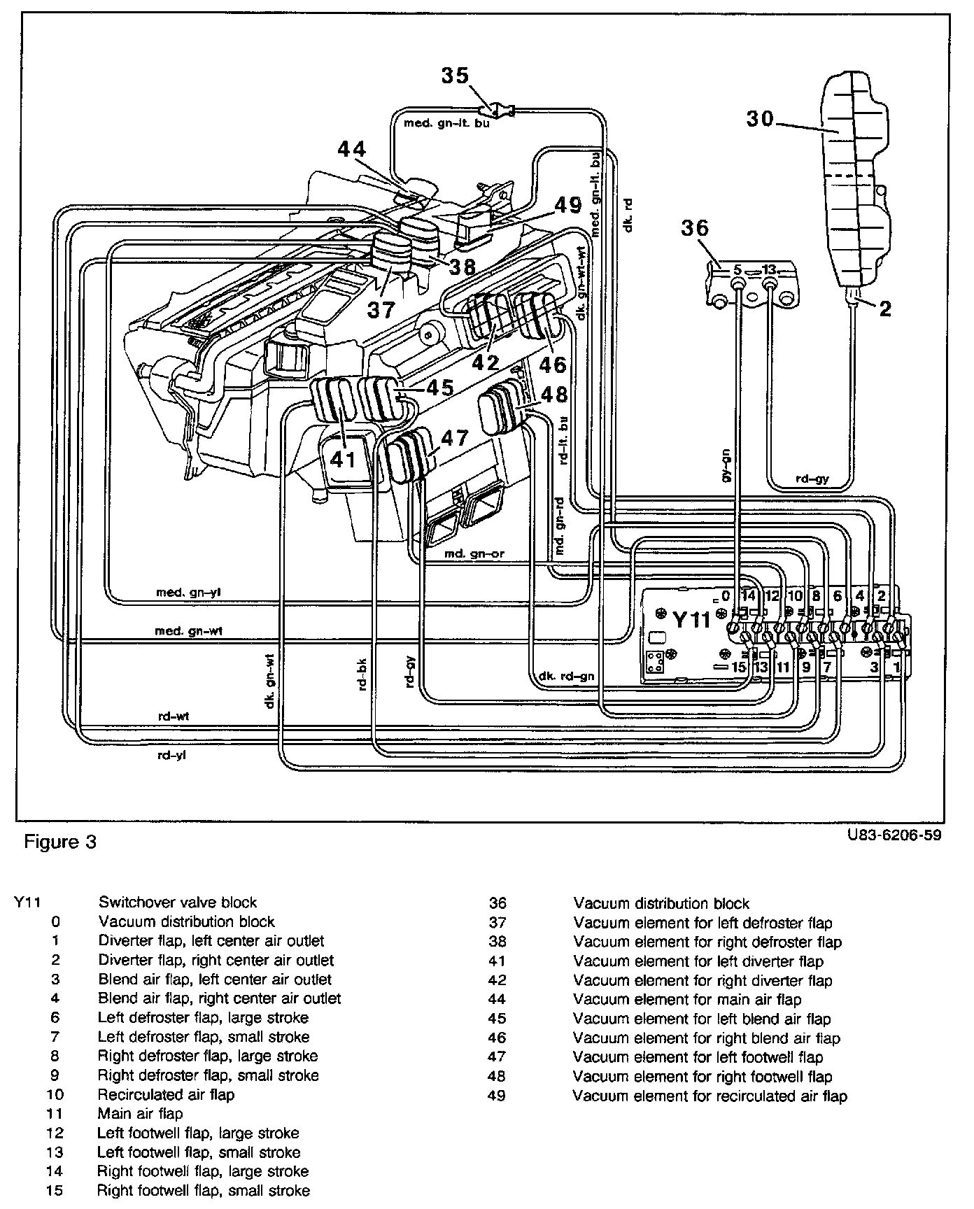

Vacuum diagram, vehicles as of A-182368

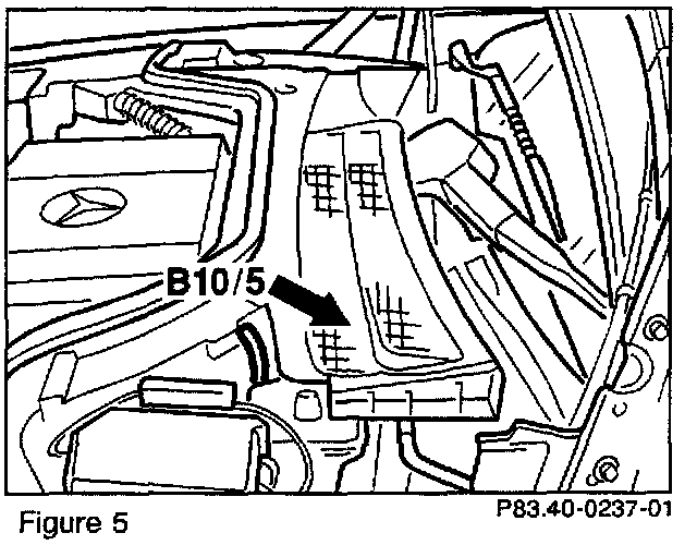

3. Outside temperature sensor (B10/5)
The outside temperature sensor connector (B10/5X1) was deleted. The temperature sensor is now soldered directly to the harness (Figure 5).
Note:
Only the previous version outside temperature sensor with connector is stocked at the PDC. In case of replacement, the old temperature sensor is to be cut off the harness, and a connector soldered into place.

As of 08/94 production (VIN A-107997), connection 3 on the switchover valve block (Y11) is no longer utilized. The vacuum element for the recirculated air flap (42) will be activated together with the left and right main air flaps (43 and 44).
Note:
Connection 3 on replacement valve blocks must plugged off.
Parts Information
Vacuum diagram, vehicles as of F-107997
