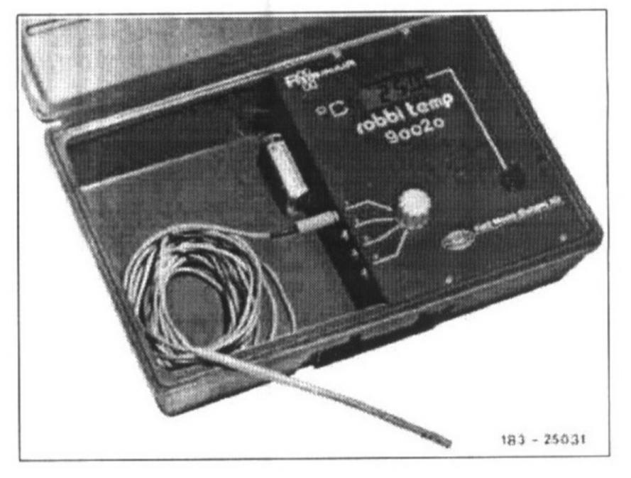

Digital temperature measuring instrument with 4 measuring probes
Robbitemp (90020)
Air temperature measuring probe (90023)

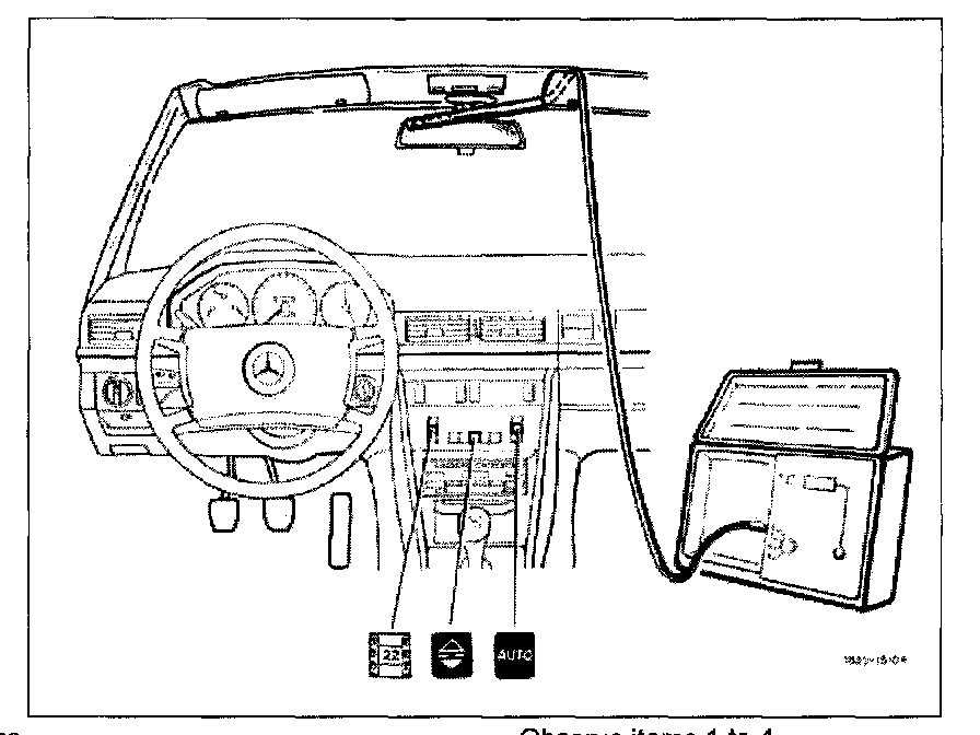

A. Checking regulating quality
5 Attach measuring probe to sun visor (right, arrow) and connect to measuring instrument. Then switch on measuring instrument.
6 On the pushbutton switch (b) select the function "lower vents" and on the blower switch (c) the function "Auto".
7 Switch off switch (S24, fresh air).
8 Close center nozzle.
9 Set temperature selector wheel (a) to 22.
10 Start engine and drive away immediately (approx. 50-60 km/h).
11 After approx. 10-15 minutes, read temperature on measuring instrument. Nominal value 22 ± 1 °C. If the temperature is not achieved, check heating output or check electric components of the automatic climate control.
