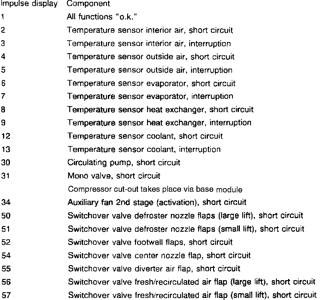

TESTING WITH IMPULSE COUNTER SCAN TOOL:Connection Diagram - Impulse Counter Scan Tool:
Image Reference:
013 Impulse counter scan tool
075 Impulse counter scan tool adaptor
X11/4 Data link connector (DTC readout, 38-pole)

- Fault codes will be indicated by the number in the impulse counter display window. Take note of the impulse display number. (See image above for list of DTC's, also Diagnostic Trouble Code (DTC) Descriptions and Test Procedures)
- Faults are displayed in ascending order.
- The number 1 indicates that no faults are stored in memory.
