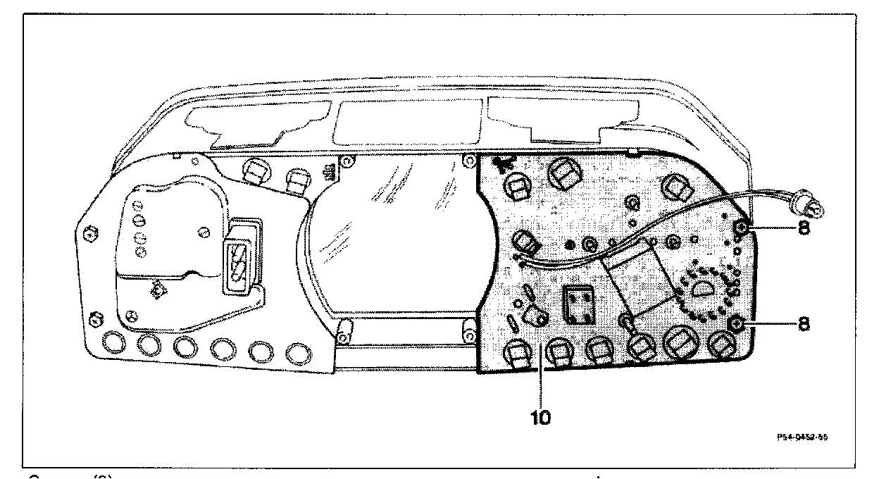

Removing and installing gauges
Preceding work:
Remove
instrument cluster
Remove/Install Instrument Cluster
Remove speedometer.
Speedometer Replacement
1.
Remove screws (8).
2.
Remove gauges (10).
