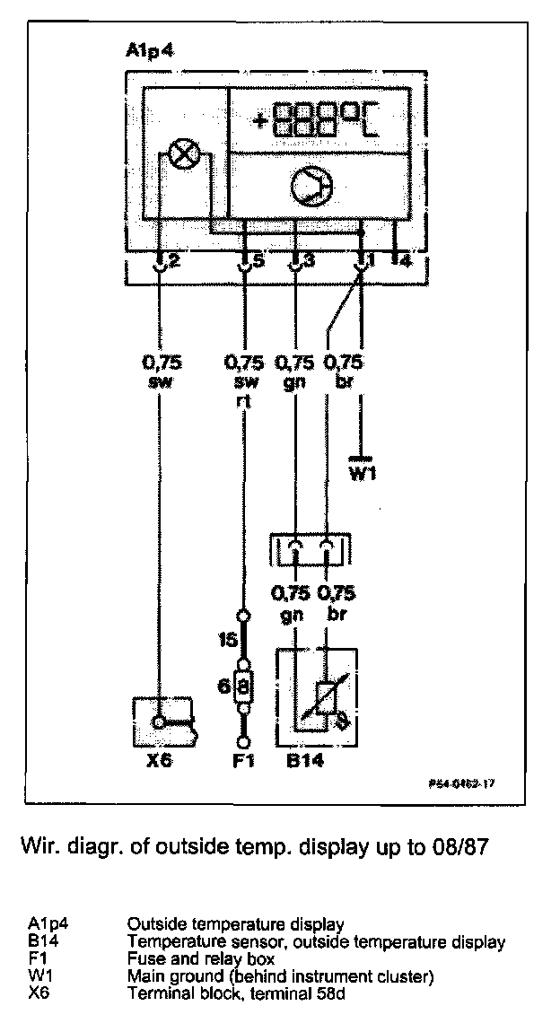

- Test voltage at 5-pin coupling of outside temperature display (A1p4) between contact 5 (terminal 15) and contact 1 (ground).
Key in position "2". Specification: battery voltage.
- Test lighting at 5-pin coupling for outside temperature display (A1p4) between contact 1 (ground) and contact 2 (instrument lighting). Lighting switched on. The voltage measured is dependent on the position of the rheostat (A1r1) of the instrument lighting.
- If the specifications are not achieved, check contacts and wiring for open circuit.
Main ground behind instrument cluster (W1), fuse and relay box (F1) and terminal block, terminal 58d (X6) to plug connection, outside temperature display.
- Test temperature sensor, outside temperature display (B14).
- Test outside temperature display (A1p4). Feed in resistances with ohms decade at 2-pin coupling.
Note: Measuring range -38 °C to +58 °C (Readout at intervals of 0.5 °C).
