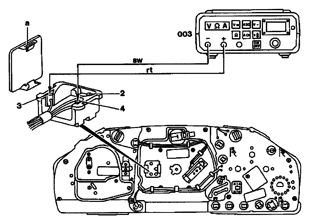

Dynamic test with multimeter
Connect multimeter (003): Red test wire socket 3 (white wire, sensor wire). Black test wire to socket 4 (brown wire, ground) Use electrical connection set 201 589 00 99 00 for testing.
- Switch multimeter (003) on (range: volt)
- Drive vehicle on dynamometer or on road. The voltage should increase continuously at increasing speed up to approx. 40 km/h > 1 V.
- Close cover (a) on connector housing.

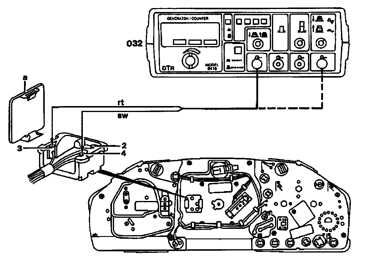

Dynamic test with frequency generator
- Connect frequency generator (032): Red test wire to socket 3 (white wire, sensor wire). Black test wire to socket 4 (brown wire, ground) Use electrical connection set 201 589 00 99 00 for testing.
- Test sensor with (frequency generator in counter mode).
- Drive vehicle on dynamometer or on road. The frequency should increase continuously at increasing speed.
- Turn ignition/starter switch to position 2 (battery voltage).
- Test speedometer with (frequency generator in alternator mode, sine wave function). The speed reading should increase at increasing frequency.
