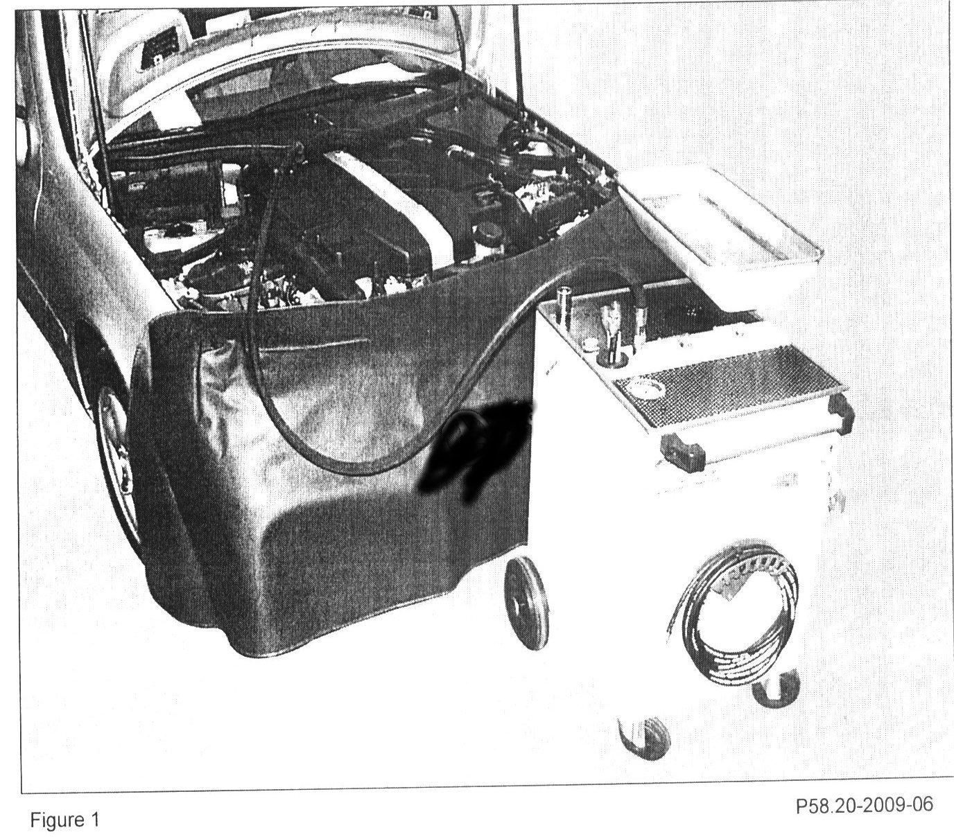

FLACO (Oil Evacuation Equipment)
The FLACO oil extraction equipment is designed to extract waste oil via the oil dipstick of the engine, using the special M-B adapter.
^ Suction probes are provided for use to extract waste oil from other components such as the rear axle assembly.
^ The unit has a 15 gallon reservoir which holds the extracted waste oil, along with an oil level indicator.
^ With a flip of the control handle, the pump is converted to pump out the used oil into a used oil holding tank.
^ A pneumatic vacuum pump.
^ A full set of suction probes to extract used oil.
^ A 5 mm air hose (DN 6).
^ A 2mm oil extraction hose DN 16 with M-B adapter.
^ The unit rolls on 2 rigid and 2 swivel steering casters, which are lockable.
Accessories:
^ A large drain pan (accessory Part number 40 403 110), which is telescopically mounted and includes a removable strainer is available.
