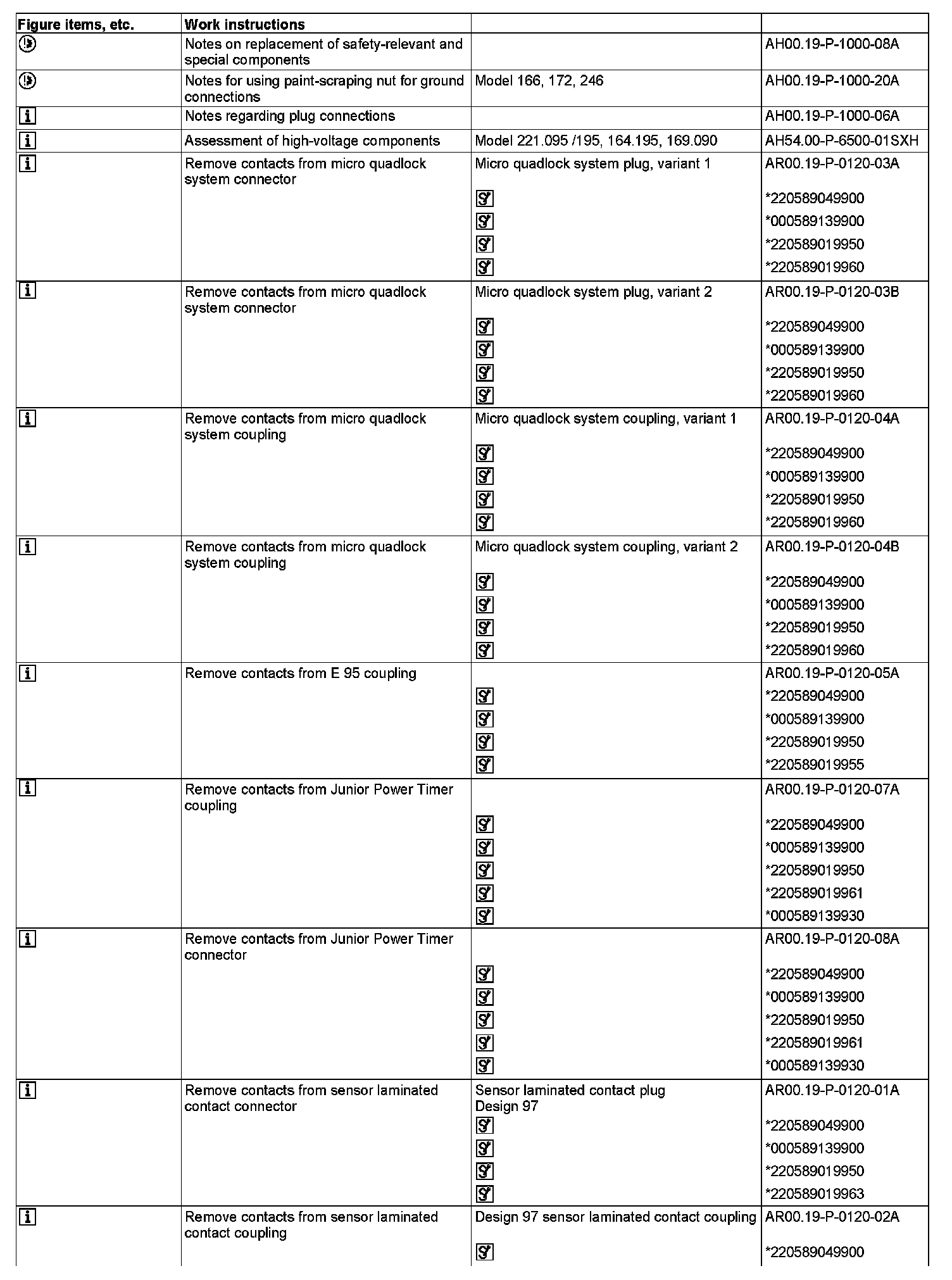

AR00.19-P-0120A Removing Contacts From Plugs and Connectors
MODEL 124, 126, 129, 140, 163, 164, 166, 168, 169, 170, 171, 172, 197, 199, 202, 203, 204, 207, 208, 209, 210, 211, 212, 215, 216, 218, 219, 220, 221, 230, 231, 240, 245, 246, 251, 414, 450, 451, 452, 454, 461, 463
