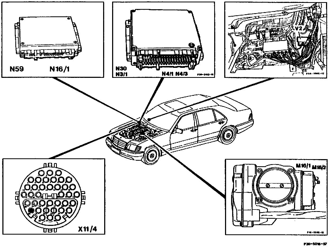

Cruise Control/Idle Speed Control (CC/ISC)
Figure 3:
M16/2 CC/ISC actuator
N3/1 LH-SFI control module
N4/3 CC/ISC control module
N16/1 Base module
N30 ABS control module
N59 Diagnostic module (OBD I) (California)
X11/4 Data link connector (DTC readout) (38-pole)
V2 Engine rpm increase diode matrix (right footwell, model 140 with engine 119 only)

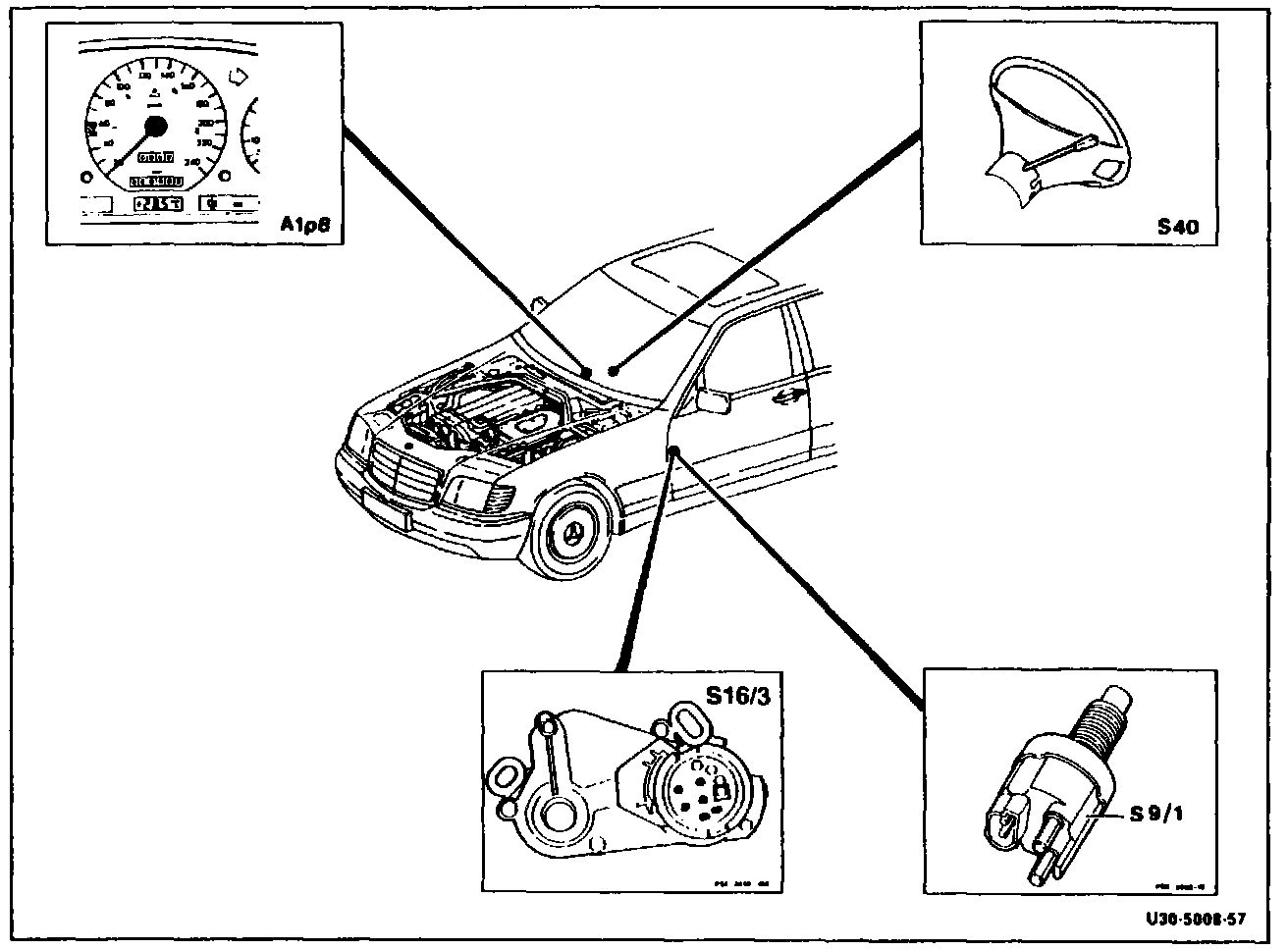

Figure 2:
A1p8 Electronic speedometer with top speed limitation
S9/1 Stop lamp switch
S16/3 Starter lock-out/backup lamp switch (transmission range recognition)
S40 Cruise control switch
V Decelerate/set
B Accelerate/set
SP Resume
A Off
